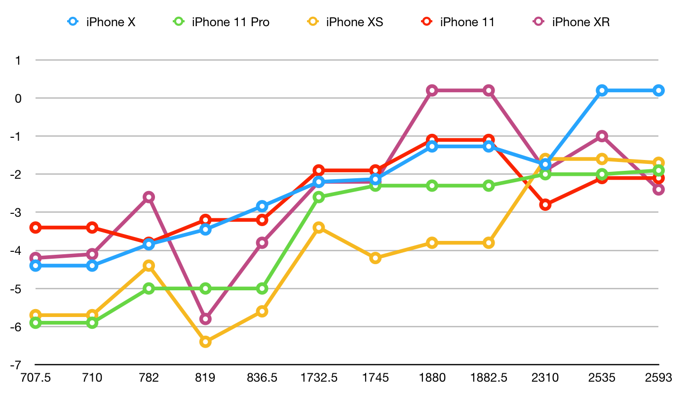

Graph for comparison between different iPhone models:
Disclaimer: I'm not knowledgeable in antenna technology, so I don't know if comparing them this way is fair or not. The graphs linked earlier in this thread show all antennas, but since the phones have the ability to use whichever antenna gets the best signal on the fly, I just took the best value for each frequency to simplify the graph. Putting them side-by-side like this shows how much of an improvement there is on bands 2, 4, 25 and 66. (The ones starting near the middle)
You'll notice I have data here that wasn't in the previous graphs, like iPhone X. That is because I went out to the FCC filings and grabbed the numbers myself. Note that some FCC filings provide the data in frequencies, while others listed LTE bands and ranges. I took the median frequency of the bands supported on all devices for the graph data and used values closest to what data was provided. In short, this data should not be considered exact but it might provide a rough comparison between devices.
I assume that the gain on lower frequencies is less important because lower frequencies travel better through walls, which might be why they prioritize better gain at higher frequencies.
I don't understand these things but by that graph for the newest phones wouldn't the iPhone 11 perform better than the 11 Pro in this regard?
Yes, that’s correct. Just like last year the XR had better reception than the XS/XS Max. The XR and the 11 both use a simpler design, they have only 2 antennas, as opposed to 4 in the more expensive models. That negatively impacts their data speeds, but in return both XR and 11 have stronger antennas.
If it does turn out that way then it just made my decision between the 11 and 11 Pro a lot easier. Thank you for your input.

The X has a different antenna design, which has better stronger reception overall. Paired with the Qualcomm modem chip it’s a very solid phone as a phone (pun intended). The XS has the worst of both worlds, bad antenna and bad Intel chip, which turned it into a bad phone for calls/data in low signal areas.

They have the same chip, but they have different antenna designs: the 11 Pro is 4x4 MIMO (4 antennas), the 11 is 2x2 MIMO (2 antennas). The Pro would have way faster data speeds in good signal areas. The 11 has stronger antennas though. It might have to do with the fact that Apple couldn’t implement a better solution for 4 antennas in this X/XS/11Pro chassis. They basically took the X chassis that had only 2 antennas and redesigned it into 4 antennas, hence crippled the overall reception. If low signal performance is important to you, the X/XR/11 will be better in that regard.
Pretty much proves the iPhone X is still best over all. I wonder what modem it has?
