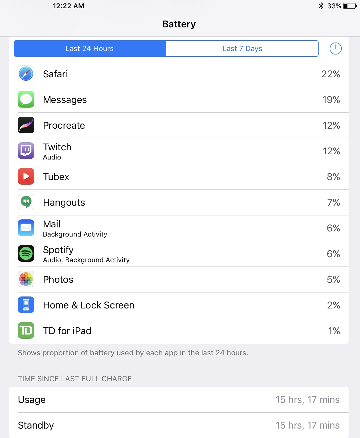

My problem is that I can never get a clear indication of how much real usage I've gotten. Either the usage meter breaks and stops showing anything, or it shows something ridiculous because of background processes that get stuck and report constant usage.
15h sounds great until you see that it's drained 2/3rds of an iPads battery in 1 day with maybe 6h of "actual" screen on time.

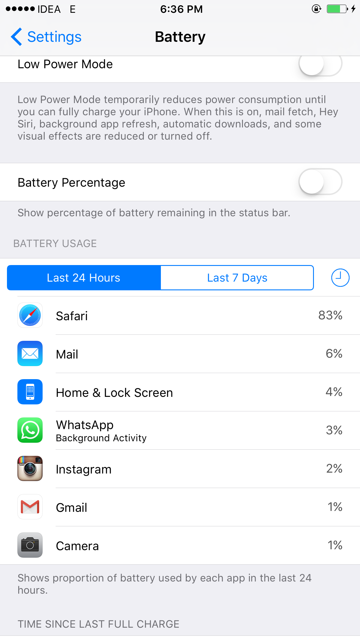

Exact same problem though safari using 83%😡

That is quite odd then. Do you have Safari enabled in iCloud settings?
It isn't.
Do you have various tabs open in Safari? Perhaps might be worth closing them to see if that might make a difference. Perhaps even clearing Safari's data.
