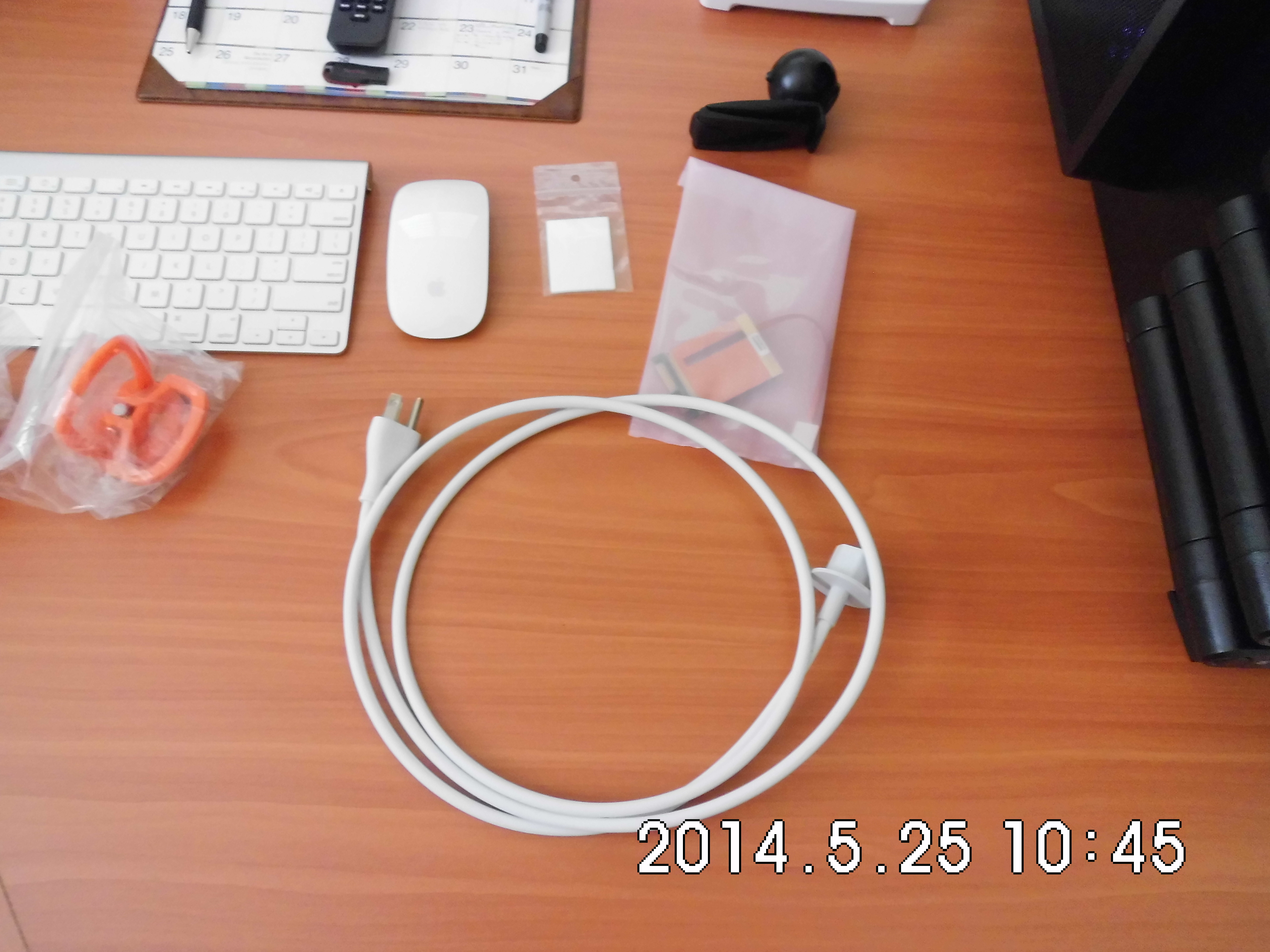

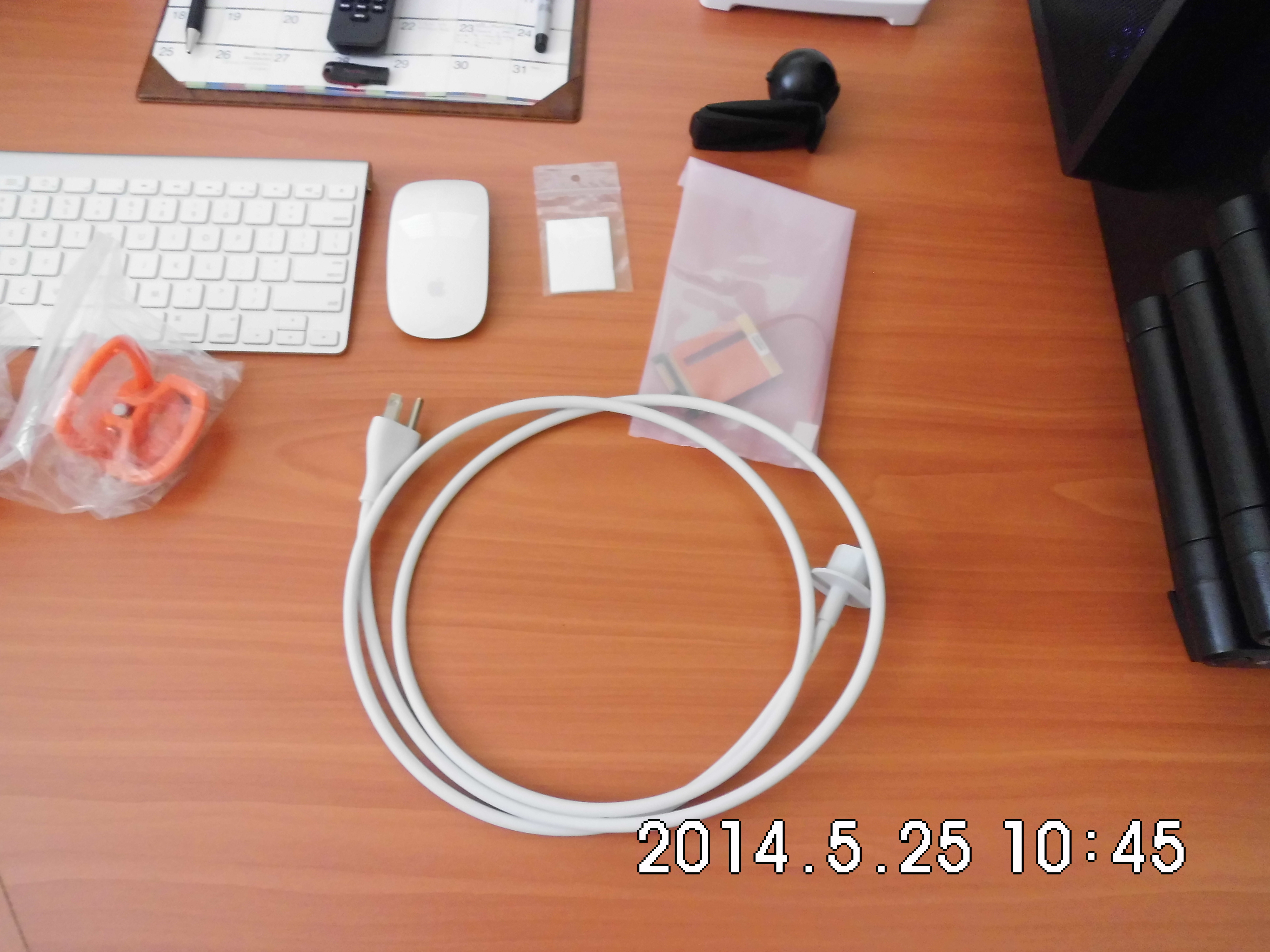

I have a 2011 iMac (27") that I decided to upgrade last year. I purchased the OWC kit to add an SSD and I also purchased a thermal sensor to upgrade the main HDD. I installed the SSD behind the optical drive and it worked as expected but I didn't have a good experience with their thermal sensor. The one they sold me is different from the one you link (see attached picture; the sensor is in a plastic bag below the upper part of the power cord in the picture). I wonder if you have used the sensor you link and what has been your experience with it. After I got tired of trying to upgrade the HDD I decided to buy a late 2013 iMac but I still want to finish what I started with the 2011.
Thank's in advance for any help!
