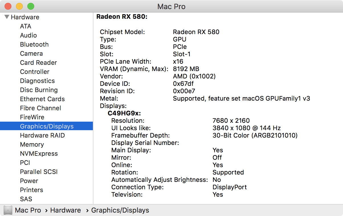

Check this page, and post the screen capture here may reduce unnecessary confusion.
High Sierra now will show us the rendering resolution, and the UI Looks like resolution.
The terms "scaled" or "Hi-DPI" etc can be very confusing in this situation. Both scale up to scale down is scaled. But the problem is when rendering at higher resolution and then scale down may cause issue.

Thanks, that's exactly what I trying to get at earlier and clears up a lot of the confusion.

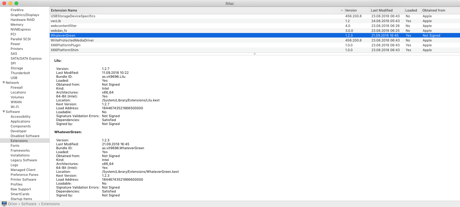

make sure that the extensions are 'loaded.'

I can't believe the difference, what the hell Apple!? mojave was almost unusable without the web drivers, but now it's even faster than Sierra.
