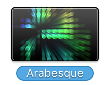

For me, the simplest indicator to see if they fixed it, is by checking how one particular screensaver is performing: Arabesque. On 10.12.6 it's buttery smooth, while on HS it's dropping an awful lot of frames.
Maybe someone can check this out on 10.13.4?

I just tried that screensaver with both drivers, it does better under the Nvidia Driver but it is still some lag, I guess overall OS performance improved but there is still some lag on this screensaver. Damn, I thought they finally solved it, guess not.
yep for my both are lagging are lagging. I've also noticed that on nVidia my window server process is havign constant 10-20% cpu usage.
