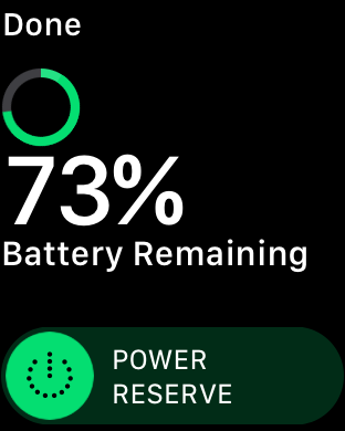

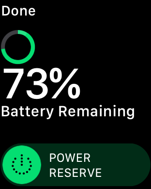

Not sure how fast your battery drain but mine seems to be pretty normal. I have my SS since it's launched (pre-order and all) and wearing it daily. Today I'm wearing it from 8.00 AM. As you can see 6 hours after the battery is still at 82% which should be normal I guess.
Got my SS in July 15 and wearing it daily - great watch and still good battery life. No problems (yet😉)
This is after 12 hours today.
