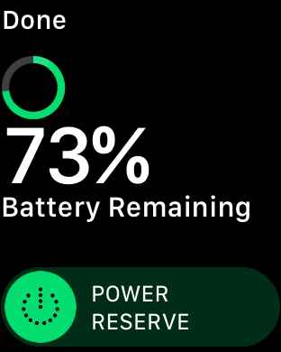

Got my SS in July 15 and wearing it daily - great watch and still good battery life. No problems (yet;))
This is after 12 hours today.
I have an SS S0. 81% battery left with (checked now).
1 hour, 29 mins Usage and 13hours 50 mins standby.
Only app installed is Autosleep. Everything else is default.
