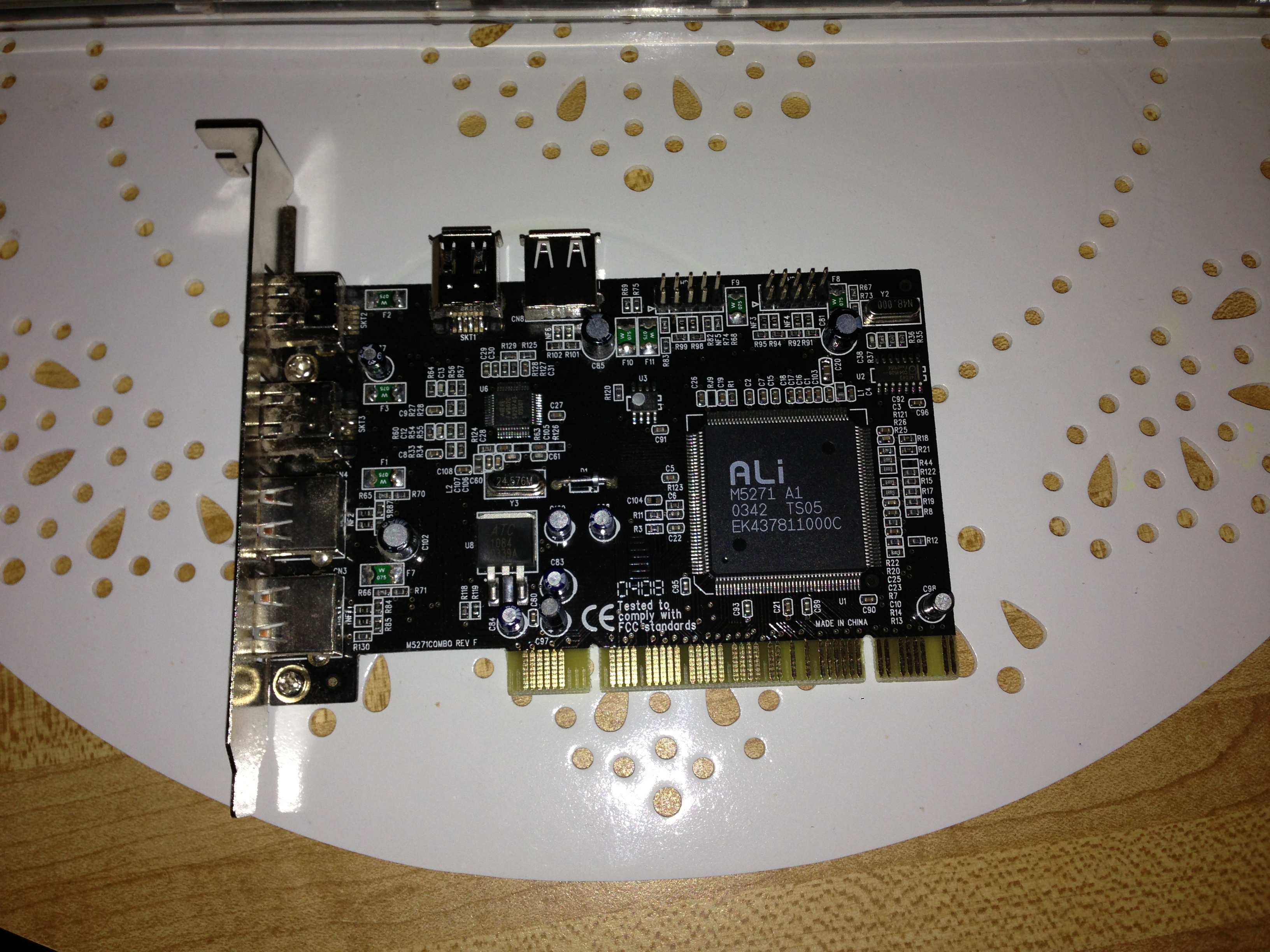

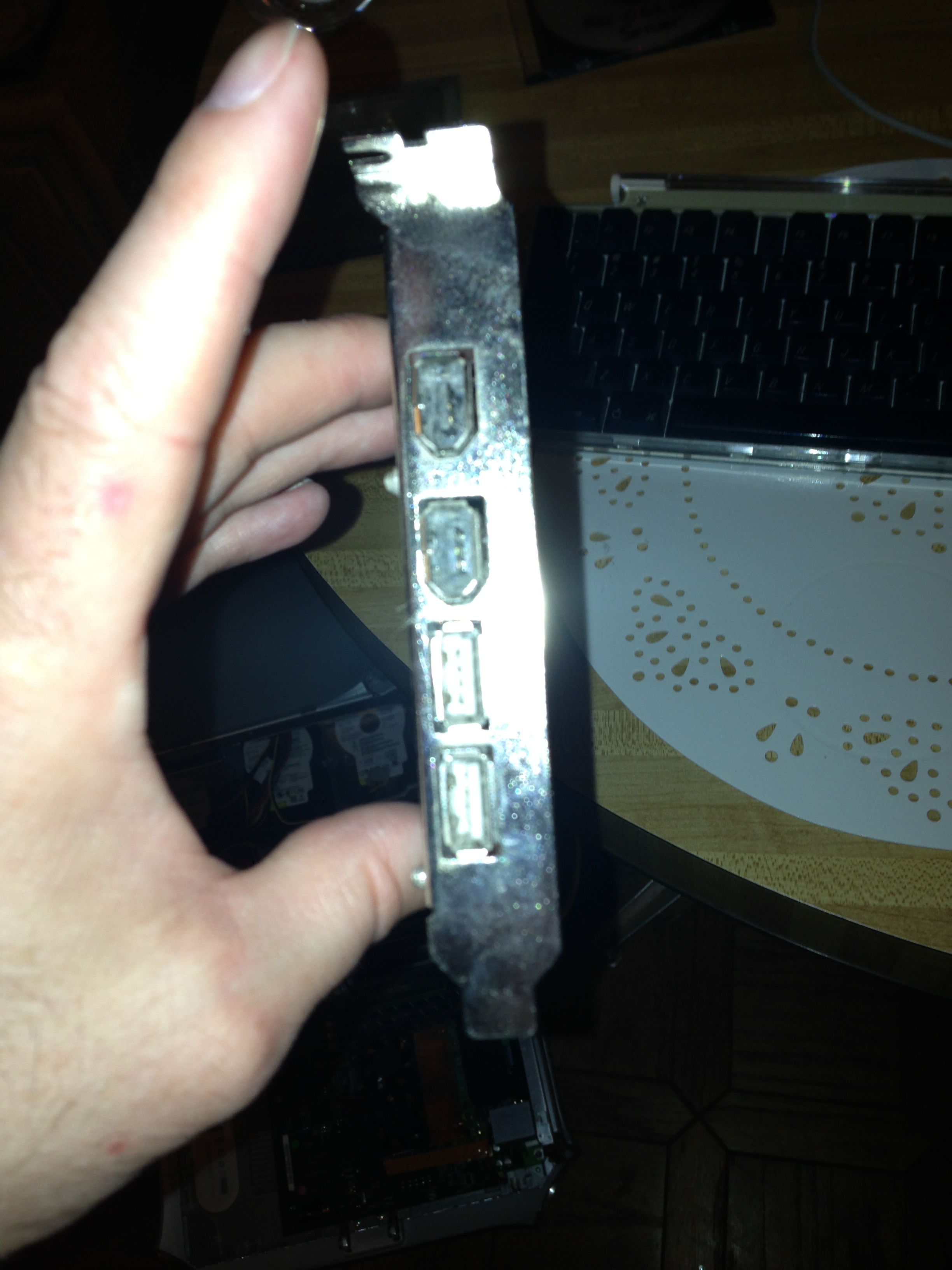

What part number is that card? I'm curious, but doubtful, that (because it is a SIIG card), that it may have 64-bit capability, primarily because it is also FW, but FW400 and USB2 are essentially never 64-bit.
I was in error. It's actually an ALI M5271 Rev F Combo card.
Here's my pics of it…
Also, I do have a SIIG card in my PowerMac 9600. USB 2.0, four ports. Here is that card.

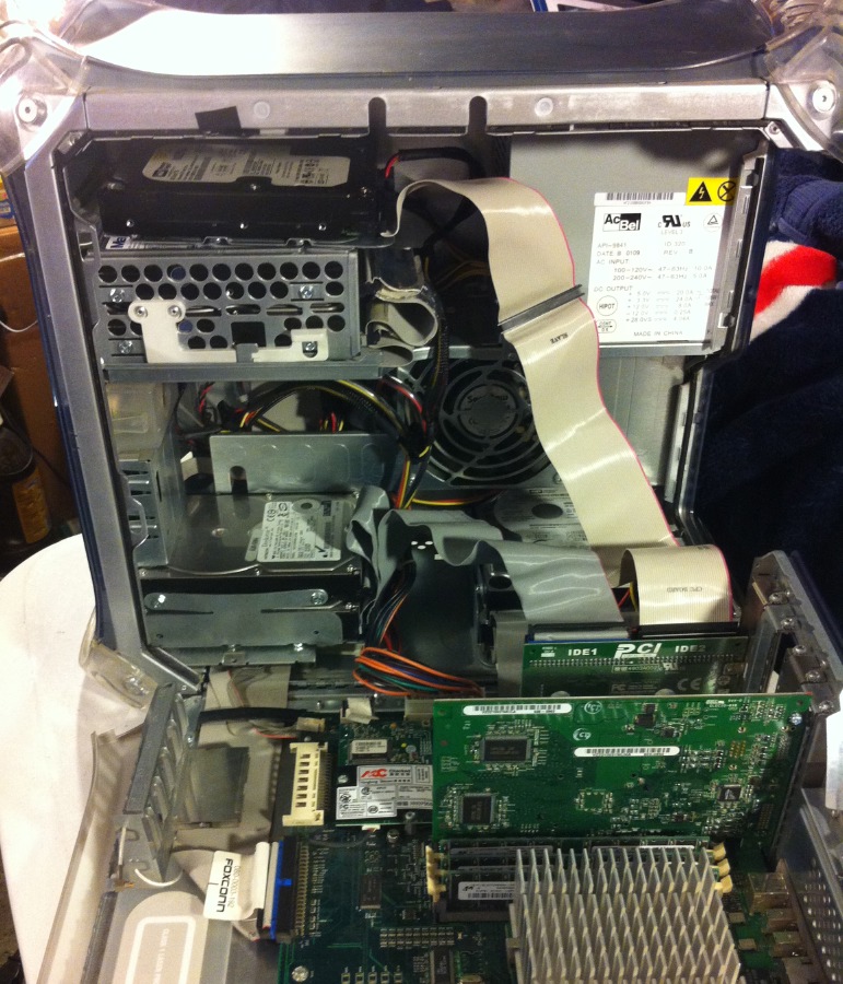

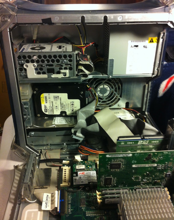

My DA 466, Jeanine:
/picture/
The DA and QS both have the top of the drive bay free. I mounted a 500GB SATA drive with IDE adapter screwed to the original drive plate that resides at the bottom of the DA's free drive bays. The prongs that go into the slots at the bottom of the drive bay are latched into the case metal above the optical drive cage for a secure fit.
It looks like you just stacked the drives on top of each other. Were they secured to anything? Four of my drives are bolted to the dual drive caddys that were available for DA and QS Macs. I only hit on using MDD drive cages later. The two drives on the left side of the bottom of the Mac are wedged into the case metal under the speaker housing.
I stuck a 250 GB IDE drive set to slave in the Zip drive slot. The optical drive is a DVD+ burner that I rescued from a malfunctioning Firewire case. I plan on removing that burner and buying a USB 2.0 case for it and installing the SuperDrive I removed from my MDD Dual 1.25.

The two drives in the MDD drive cage were removed from my MDD Dual 1.25 (and the stock SuperDrive and cage re-installed)and placed onto that space and the rescued DVD+R drive removed. Now the DVD+R drive has a kludge of a USB connection and sits on top of the tower with power and USB connections coming from a separate adapter I had for testing drives. It's far cheaper than buying another external drive, though it's ugly as hell.
I then improved the setup by placing the vertically-mounted drive on top of the MDD drives. The Mac now has seven separate drives for a total of 2.45GB of space.
I wound up using blue painter's tape on the outside of the case to block the gaping hole left by the removal of the DVD+R drive, lol. Don't matter much to me.
By the way, it was a real pain in the ass to get this thing settled. Barring some kind of strange eBay acquisition, I'm not touching this thing anymore.
