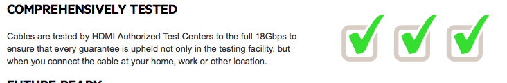

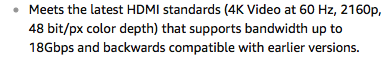

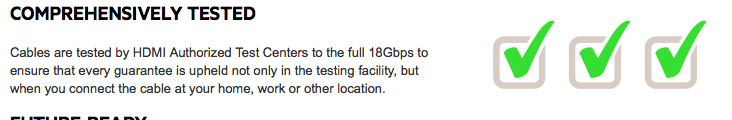

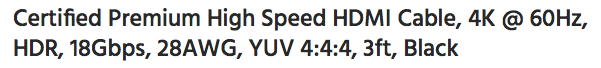

Yes, they do. Every reputable good seller writes the Gbps rating of the cable. Note they all have "18Gbps" written somewhere prominently. Because it's important.
Amazon Basics:
Monoprice:
Belkin:
