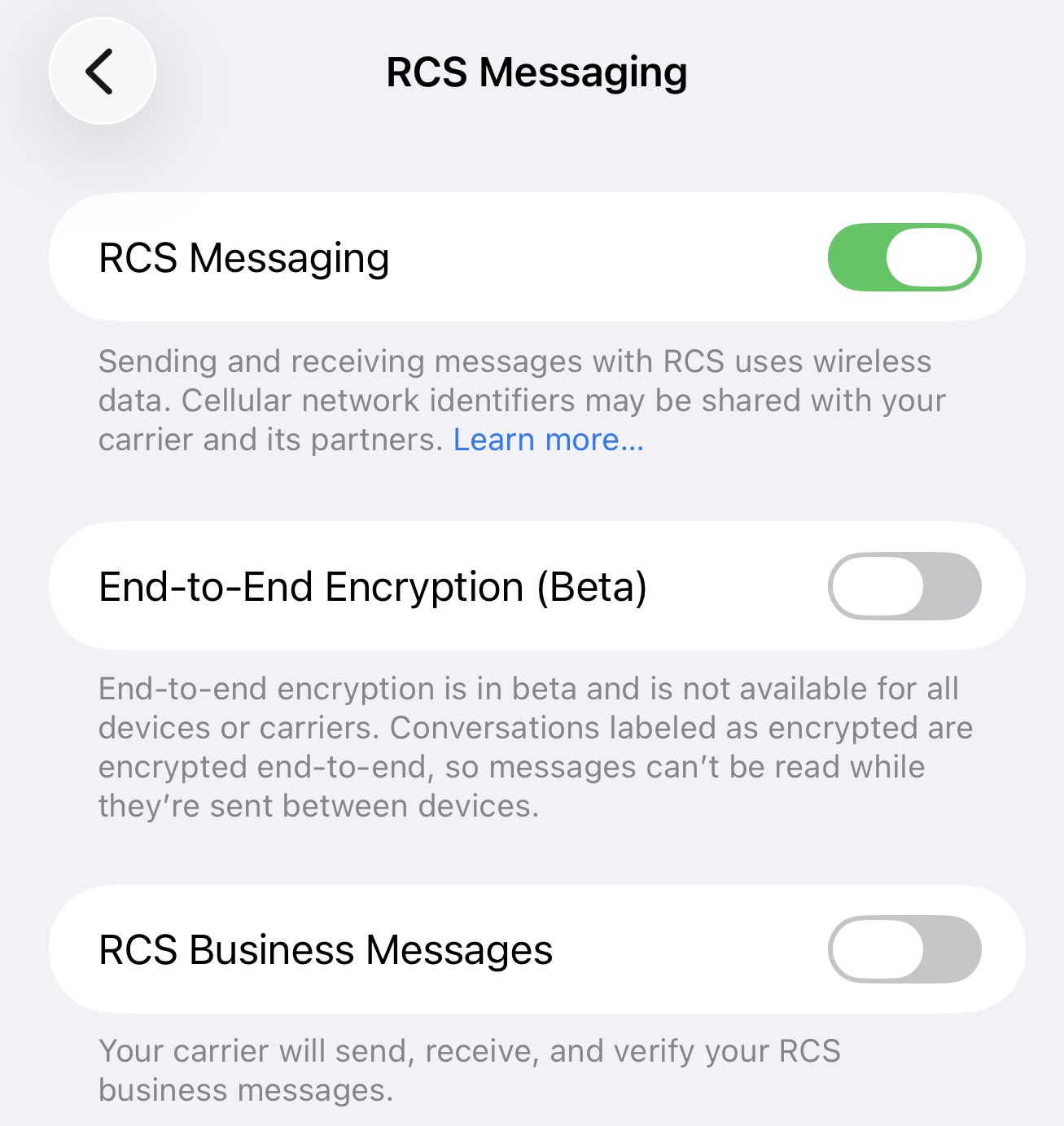

For those who have 26.6 installed and this is working again - how do you have these 3 settings set in Apps/Messages/RCS Messages?
It works on the iPhone and the Apple Watch since the "time zone" update.
