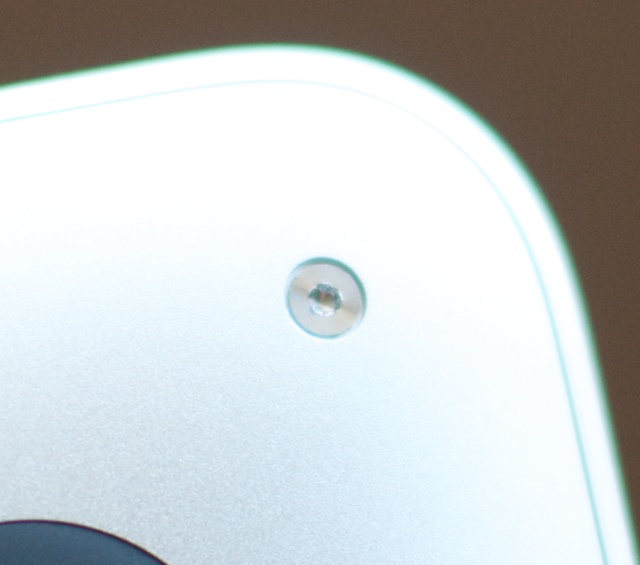

After noticing my Retina Macbook pro squeaked pretty badly, and living in Mexico City (no Apple Geniuses, only Official Distributors and some repair centers) and following the advise of this forum, I purchased the Pro Tech Toolkit from Ifixit. After 3 days when it arrived I got out the 5 Pentalobe driver and Identified quite easily the screw that made the noise. For me it was the upper right hand corner screw, near the screen. Carefully I took out the screw, alligned it and torqued it again, quick and easy and the notebook changed to a sturdy solid perfect Macbook pro, only one screw out and everything perfect.
I strongly recommend anyone out there with the problem, to get a pentalobe driver and tighten screws (remove and retorque). You never know what and how will your "Geniuses" do with the machine when they take it back in the store (scratches etc). So if you can do it yourself, better do it.

I bought one of the 1.2mm pentalobe screwdrivers from ebay. I noticed there was a lot of play as the screw head is actually imperial and about 1.27mm.
When trying to tighten the driver started damaging the screw head so I have stopped.

I had a Genius reseat and tightened my pentalobe screws. Creaking went away BUT the head of the screws looked stripped and rounded. It bothered me so much considering it's a brand new system with stripped screws. I decided to return it wait a while or at least for the next refresh. Just got tired of this LCD Lottery, return game, etc.
