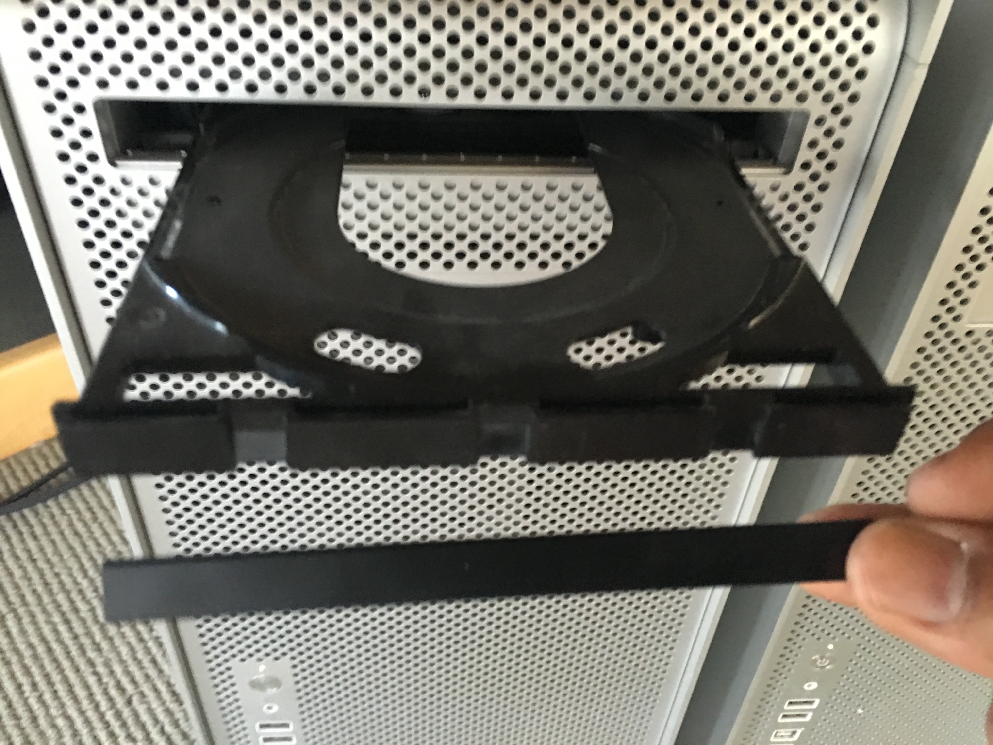

I've had this problem with my top SuperDrive for years. Today I was installing a new SSD and figured while I had the machine open I might as well try to solve this issue, as well. The various solutions presented in this thread are greatly appreciated — but once I took a good look at my sticking tray, the solution, for me, was even simpler:
First, I verified that the drive was still sticking. It stuck, three times in a row.
Then, with the drive open, I noticed a long, thin, plastic strip, attached to the front edge of the tray. But upon closer inspection, I noticed that the strip wasn't aligned perfectly with the front edge of the tray. I confirmed it by running a finger along the lower-front edge of the tray. On the left, the strip was flush; on the right, it was sitting too low. I suspected the slight protrusion might be the culprit.
I determined with a flashlight that the strip was affixed to the front of the tray with very thin, double-sided strips of adhesive foam. So, I carefully pried the front strip off of the tray.
(NOTE: If you repeat this, please do so very carefully and at your own risk! Your drive may be constructed differently, in which case this fix wouldn't apply.) With just a bit of force, the strip came off easily. The only "caveat" was that there were bits of adhesive foam remaining on the front edge of the tray, which I found unsightly. (Of course there were bits on the strip that I removed, as well.)
At first, I intended to glue the strip back on, making sure it was flush with the tray. But then, I figured — Nah... Why bother? LOL. So, using my thumbnail, I peeled the remaining bits of foam off of the tray, and it looks perfectly fine without the strip I removed. I've attached a photo, taken after the bits of foam were removed, and showing the piece I removed. (Sorry it's slightly blurry, but you get the idea.)
I've since opened and closed the tray 8 or 10 times — and it hasn't stuck even once. :)
Needless to say, your tray may be sticking for a different reason. But thought I'd add yet another solution to the thread. I can't believe I've been putting up with this for so many years, when the solution (for me at least) was so simple.
