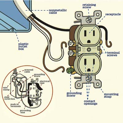

Make sure the power is off at the breaker box. Remove the wall plate, then remove the top and bottom screws holding the outlet into the wall. Pull out the outlet from the wall. Here is a picture of a typical outlet.
If your wiring looks the same, replace the outlet, connecting the wires to the same screws on the old one. If your wiring looks more complicated than this, don't panic - it could still be a simple DoItYourself job to fix.
