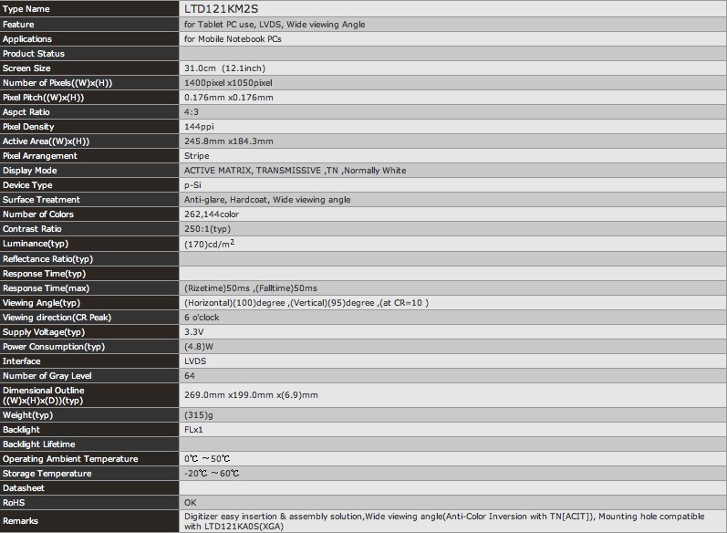

Ive posted the specs for a 12" high res screen id like to try in my 12" powerbook. any thoughts?
specs attached
specs attached
Looks good to me, the lvds bpp is the same. Is the 12 inch an xga screen ? If so it might only use one channel LVDS and require a different cable and the gfx card might not support it (but i highly doubt it).
Other than that mounting might be a problem, but as this goes you'll probably won't run into the same color problem we have.
I would try it.
I would try it.
thanks, i think i will try it. its going for $250, but without the inverter. can i rely on my current inverter to work?

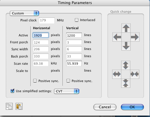

3rd (or 4th?) confirmed success!
I received my used Samsung LT154U1-L01 (vs. L03) and it works, although I also used a different simplified setting (CVT in my case). Also, the refresh rate always resets to 55.939hz from the 56Hz that I enterred which I'm assuming is related to the CVT setting or feedback from the display. I'm still having trouble getting the brightness working as there was already a DisplayProductID-3155 file (apparently created by SwitchResX) in the DisplayVendorID-4ca3 folder, and swapping it out with the -9c20 version (appropriately renamed) as recommended by Baxter killed my sync. I'll keep plugging away at the brightness controls, but in the meantime, I'm happy with it af full brightness.
I have an original MBP CD 2.0GHz machine delivered in the very first few weeks. It has the latest BIOS and OS updates.
Font Smoothing Style working for anyone?
While this may be related to my troubles (probably just personal stupidity) getting brightness control to work, has anyone noticed if the aggressive LCD font smoothing works for them? It doesn't appear to change when I tweak this setting and I seem to recall fairly dramatic differences between Light, and Strong, and especially CRT. I think it's just defaulting to CRT or none at all, but perhaps the much smaller dot pitch simply makes this harder to detect.
Congratulations! It's good to hear more people are having success in replacing their LCDs. The more consistency accross the board people begin having with this mod, the more likely I will be persuaded to take the plunge myself.
it seems that for me the key is to use the GTF preset ... which actually also works at 60Hz :) (I checked on a Dell laptop and windows uses 60Hz as the refresh rate ...)
