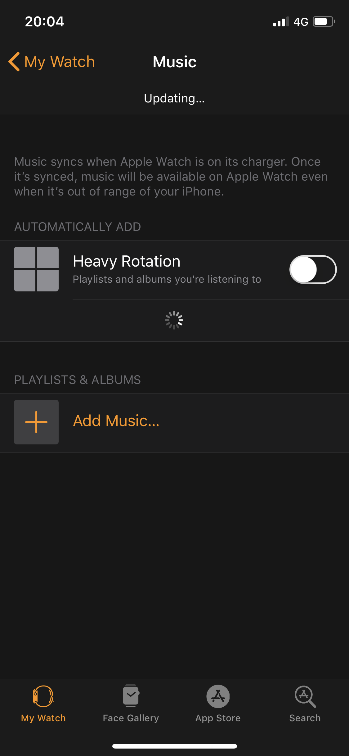

Can you all have a look at the music button on the iPhone watch app does your heavy rotation option just spin around constantly?
[doublepost=1510863507][/doublepost]Here's a pic
No issues on my end, sorry.
