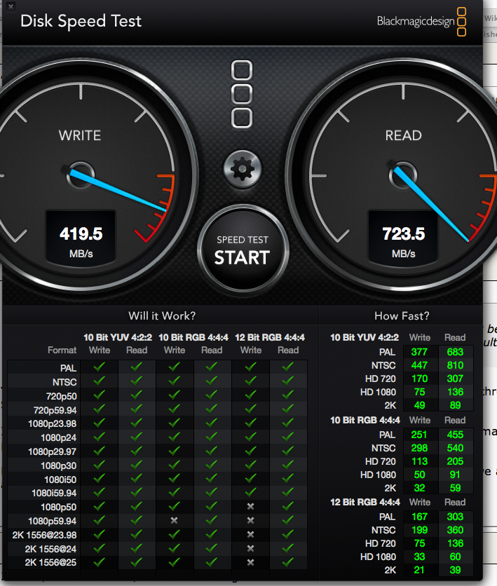

Wow, I thought mine was fast, but it's slower than everyone else's above. 🙁
But mine is BIGGER! 😀
512 GB SSD
Model: Apple SSD TS512C
Mfgr: Toshiba
That seems a bit slow, even for the Toshiba. It is on a 6Gbps controller now, and that should give you speeds in the 350-400 Mbps range. In any case, you might try another benchmark, since sometimes a controller can give a benchmark a fit, and thus it won't generate a reliable result. Sandforce controllers in particular seem prone to this. I think it has something to do with how the controller treats compressed data vs. uncompressed data. I've read that the Toshiba is a customized Sandforce.

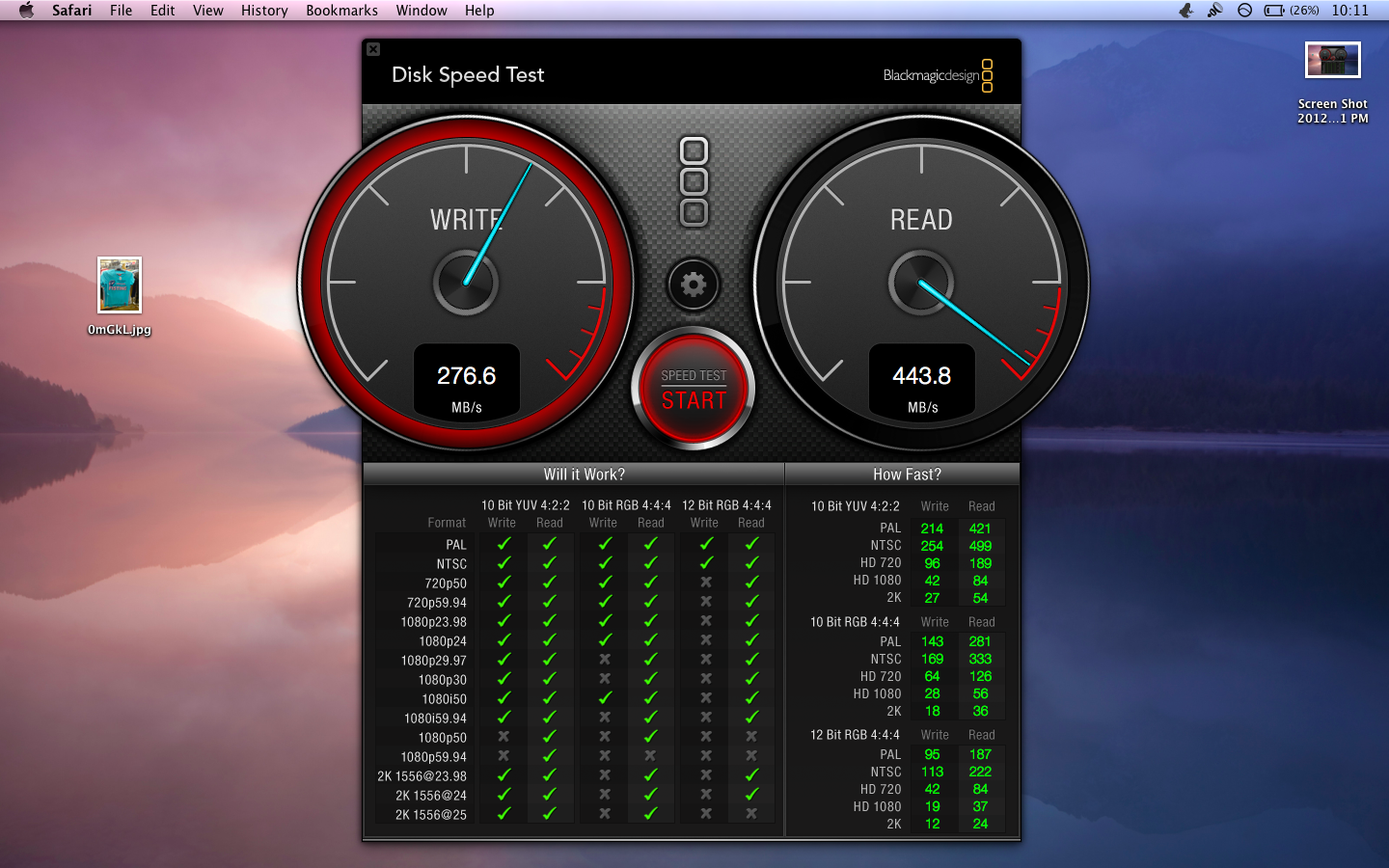

FWIW here is the 128GB Toshiba SSD in my 2011 Air

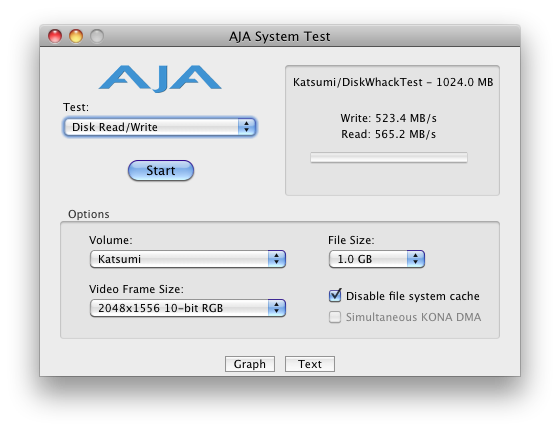

Mine isn't a MacBook Air, but I have a 3 SSD RAID 0 in my Mac Pro and it gets stellar results in Aja but lackluster results in Black Magic. It is also due to the compression issue as I am using OCZ Vertex 2's.

As for Black Magic......it's definitely going to show slower speeds with the Sandforce drives. I have an old OWC 3G drive in my Mac Pro......with AJA I get speeds in the 200's....with Black Magic I get pathetic speeds....on par with traditional drives.

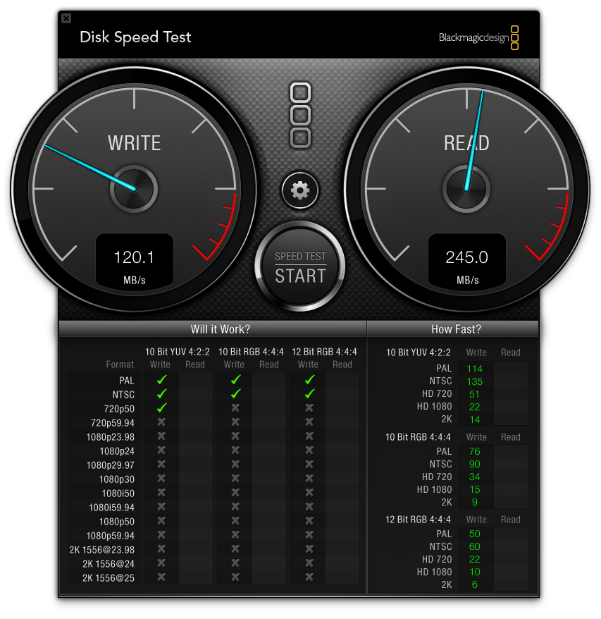

picture att. is this a good speed?
128GB ssd macbook air 2013.

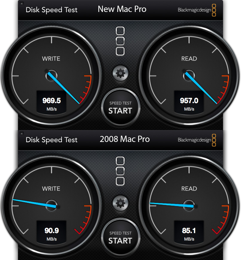

Just got my new Mac Pro hooked up and ran some comparisons between my 2008 Mac Pro and the new one I just got:
Very nice... but did you notice that you're posting in the MacBook Air forum? 🙂
Doh!! Nope - got here through a google search and just saw the BlackMagic title 🙂
Even now on my iphone it is hard to see the MacBook Air designation... Sorry about that!
Oh, no problem, just thought it was worth pointing out. I get 700MB/s write and over 700MB/s read on the 512gb SSD in my 11" MacBook Air. Not bad, considering the price difference with the Mac Pro. 😀
Those results from your 2008 machine seem kind of low. Just ran the Blackmagic test on a Seagate Desktop Backup Plus drive connected to my MBA through Thunderbolt. This is a 2TB 5400RPM drive, and I get 195MB/s write and 196MB/s read.
Yep - that PCI Express Bus is FAST! Glad to see the Airs are taking advantage of that as well!
Yea - not sure about why the speeds are so low on the '08 machine... Was expecting faster myself!

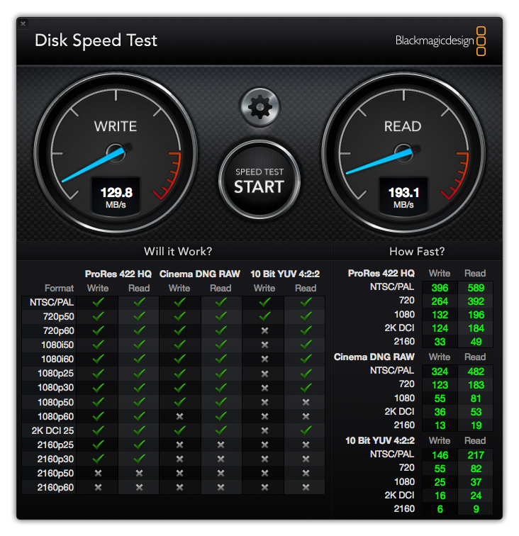

I d/l the speed test today for a look across all three of my machines.
First up is my Mac Mini 2010 Core 2 Duo / 500G Crucial SSD / Crucial_CT480M500SSD1
Speeds certainly look on the low side, I'd value a more knowledgable opinion.

It looks about right for Sata II speeds that come on the 2010 Mini. You need a machine with Sata III to get anywhere near the advertised speed for that drive. And you need a modern PCI Express connection to go higher then that.
OK that makes sense, its not as though I'm not impressed by the speeds on the mini compared with when it had the old spinning disc. Just got thrown by some of the other results as posted here.

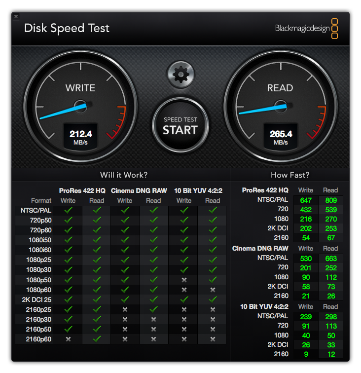

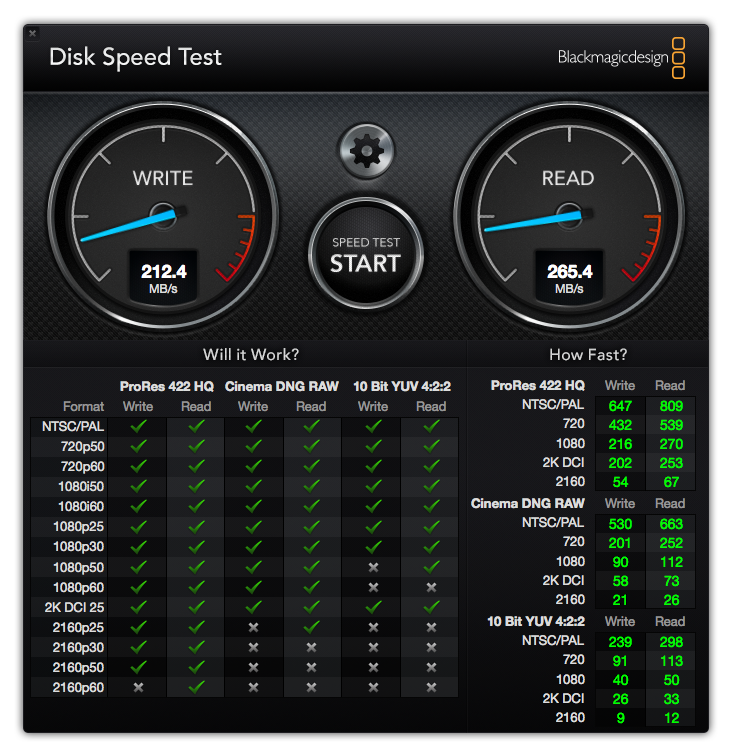

So I'm guessing that the same can be send for these results taken from my Macbook Pro 8.2 / I7 2.3 / 16G RAM. This has the BTO APPLE SSD TS512C 500G.
What surprises me most of all about these results is there worse than on the Mini. Though guessing its because the SSD came out a few years previous?
