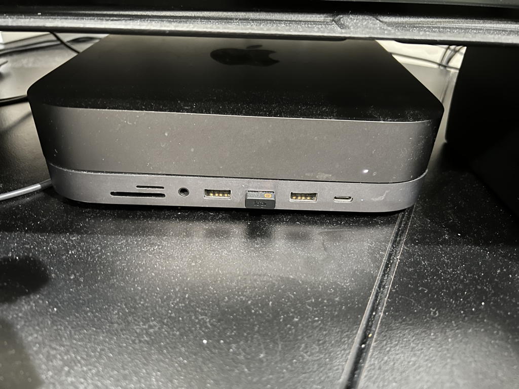

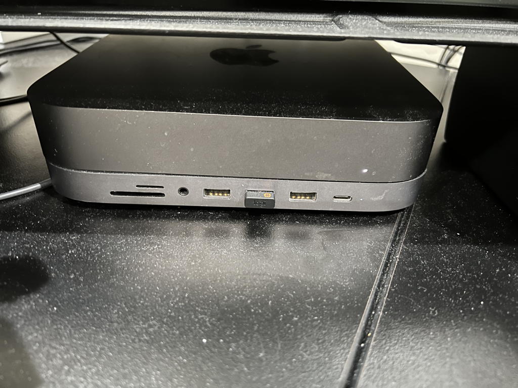

Have one with my M1 Mac mini. Works good and have a 1TB SSD in it. Ports work ok and haven't had any issues with it. Not the fastest ports, but does the job. The SDXC and mini slots are a good addition. But in the design, the SDXC ports are up-side-down. Don't understand what they were thinking. I think the other ports are too (from memory). But others than that, it works good.

I have a Satechi hub on the M1 Mini and put in the Samsung SSD. Works fine as do all the ports. I would have preferred that the ports were on the back of the hub rather than the front but that's just cosmetics.
Reactions: MikeDr206
Agreed. Dont know what possesesed them to put them all in the front
Some on the front and some on the back would have been good, but the Mini already has the ports on the back.
For USB sticks, Yubikeys and memory cards, having them conveniently on the front is useful. For things like printers, external drives, keyboard and mice that will stay plugged in permanently / longer, having some of the back would be good... But you can't have everything in life.

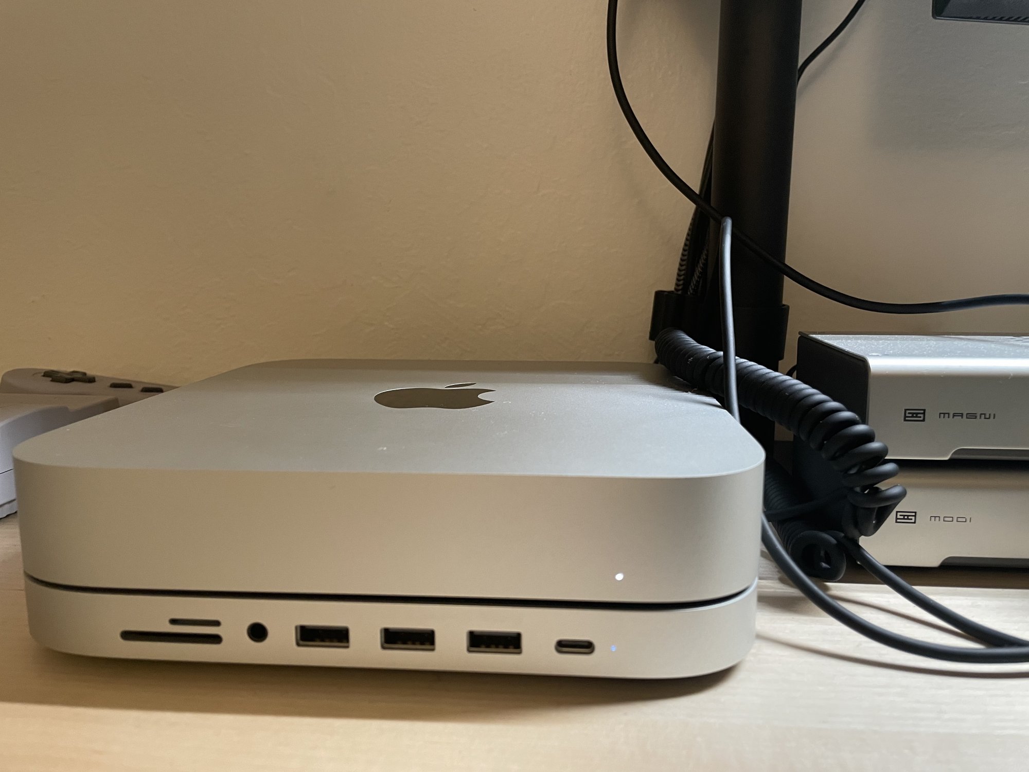

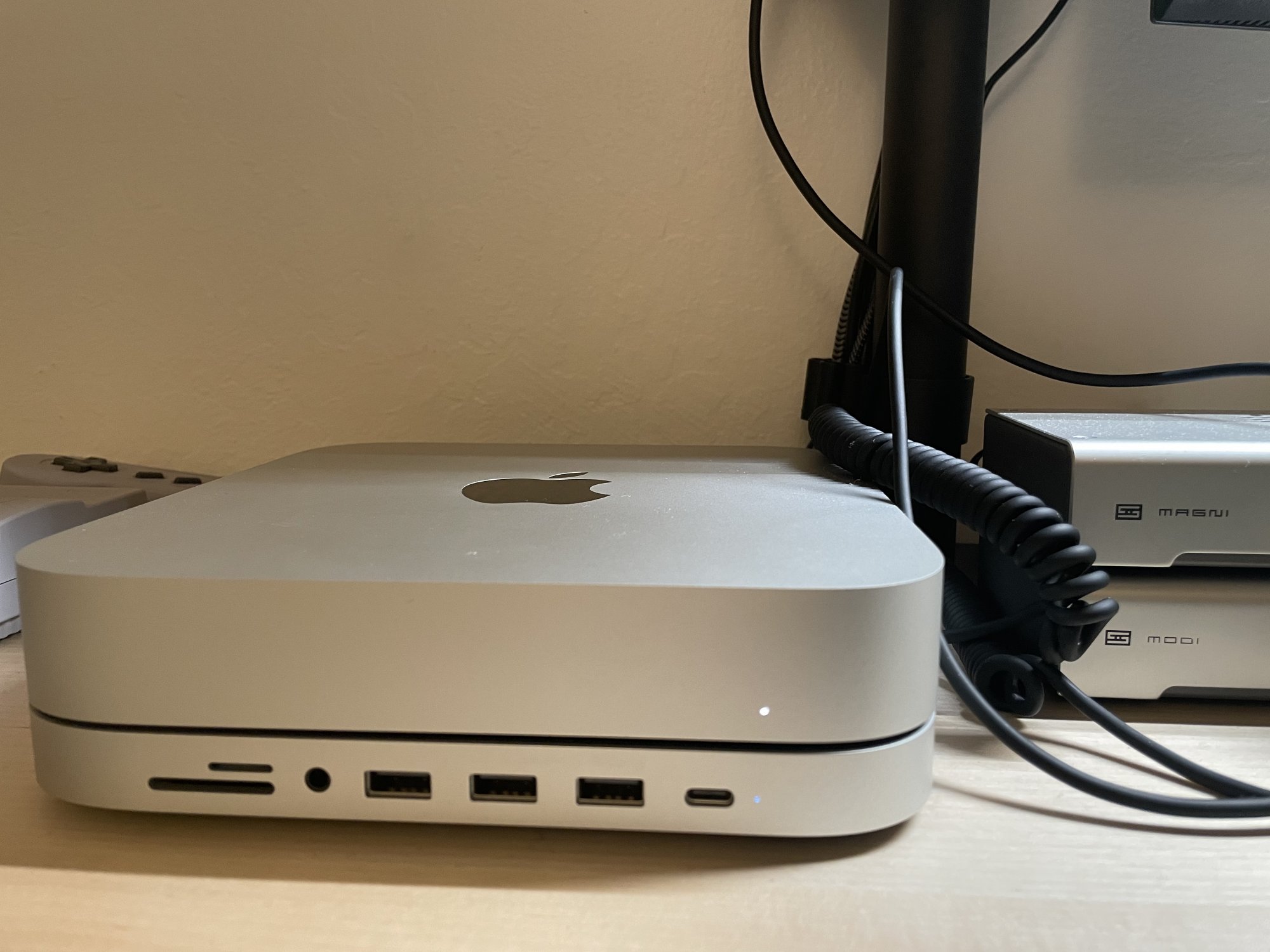

I have one with an external ssd drive; no problems with the drive, but the front usb ports are a bit tight and the sd card slot won't accommodate my microSD adapter
The older ones that don't accept a 2.5" drive are mostly empty space. Not much to them.
I'd try and get it swapped out/get a refund. The ports on mine are aligned well and the USB cables and the Yubikey I've used so far have all fitted well and easily. The same for my microSD adapter.
@frou - hardly a surprise, most of it is there to provide a holder for the Mac mini that matches its dimensions. In that respect, it works very well.
Actually, thanks to a redditor's suggestion, the SD card will fit if it is inserted upside down (on the Satechi); I don't use the front USB ports a great deal as I prefer the rear USB ports on the mini.
