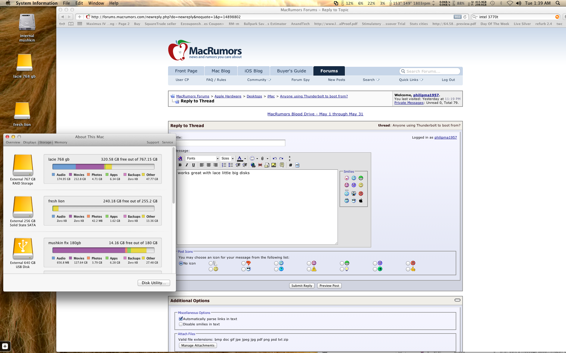

Yes, I found a way to do it online where I got a GoFlex TB converter, then got a GoFlex USB drive, swapped it with an SSD and now I can boot from the TB on the iMac to that drive. Super fast!
I want to do this with a MacBook Air and an iMac. Got the 2011 air...just waiting for the new iMac to come out...

works great with lace little big disks
