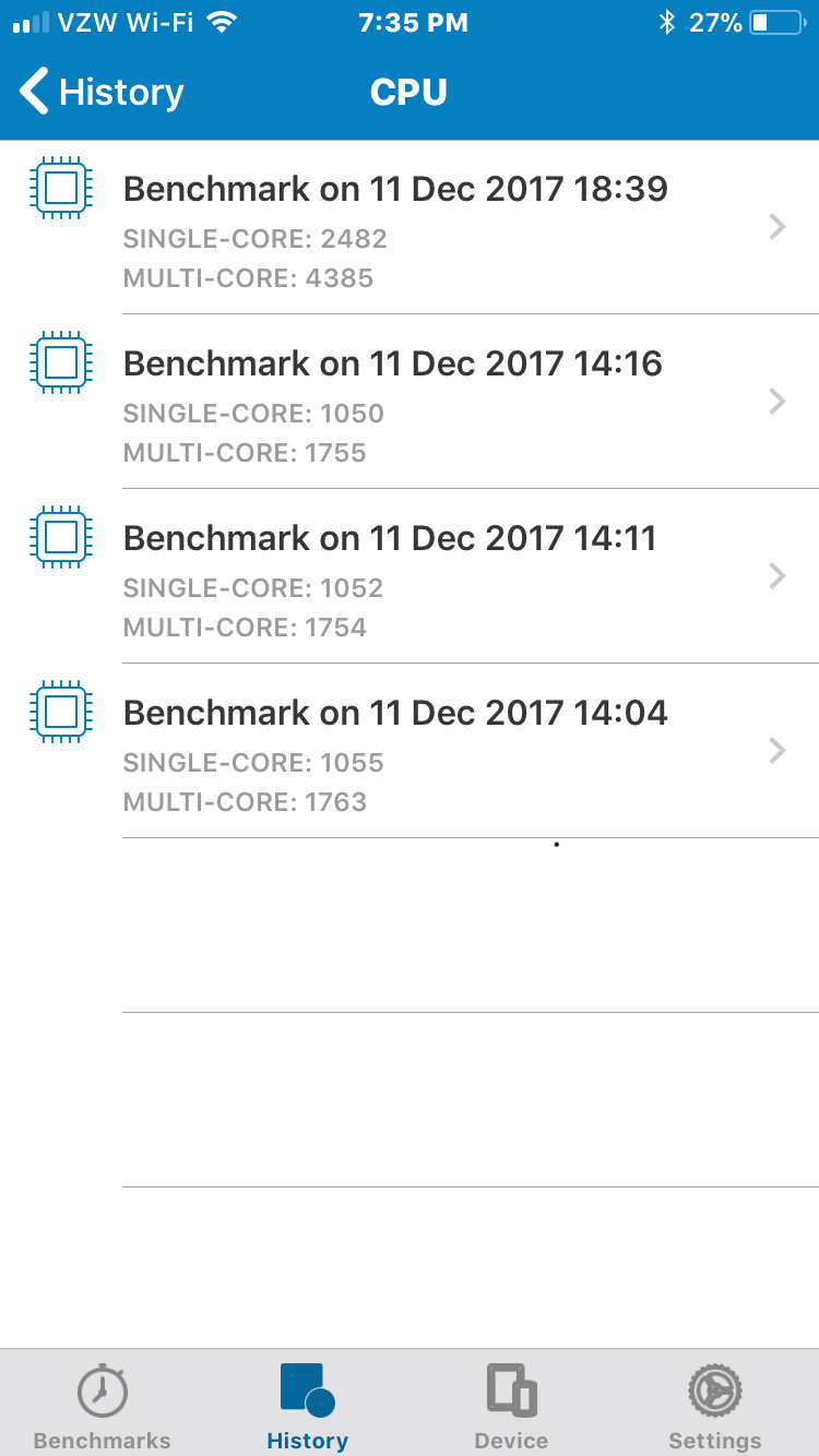

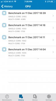

According to CPUDasherX my 6s was running at 911 Mhz @ full charge, after replacing battery it now runs at 1848 Mhz. Does feel alot smoother and responsive now.
Right, Geekbench had me at s 835 / m 1372 post install it was back in like with other 6 Plus.

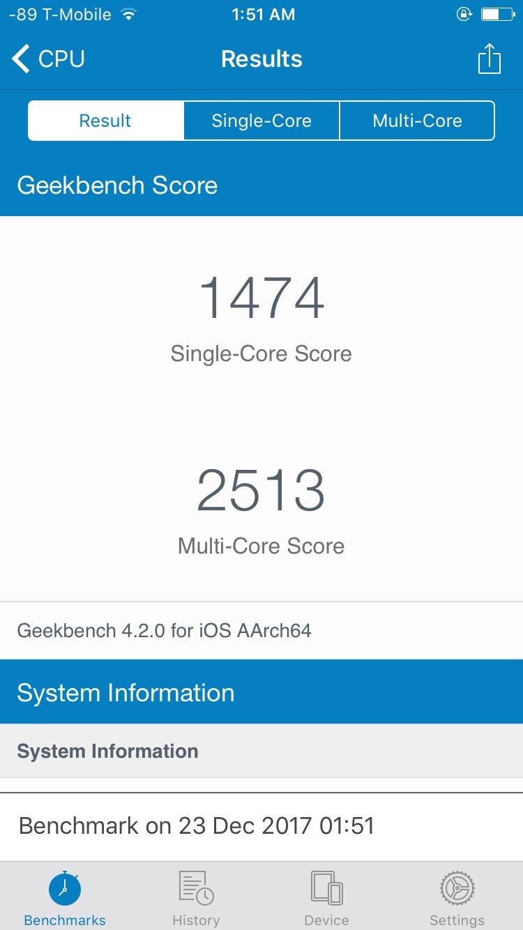

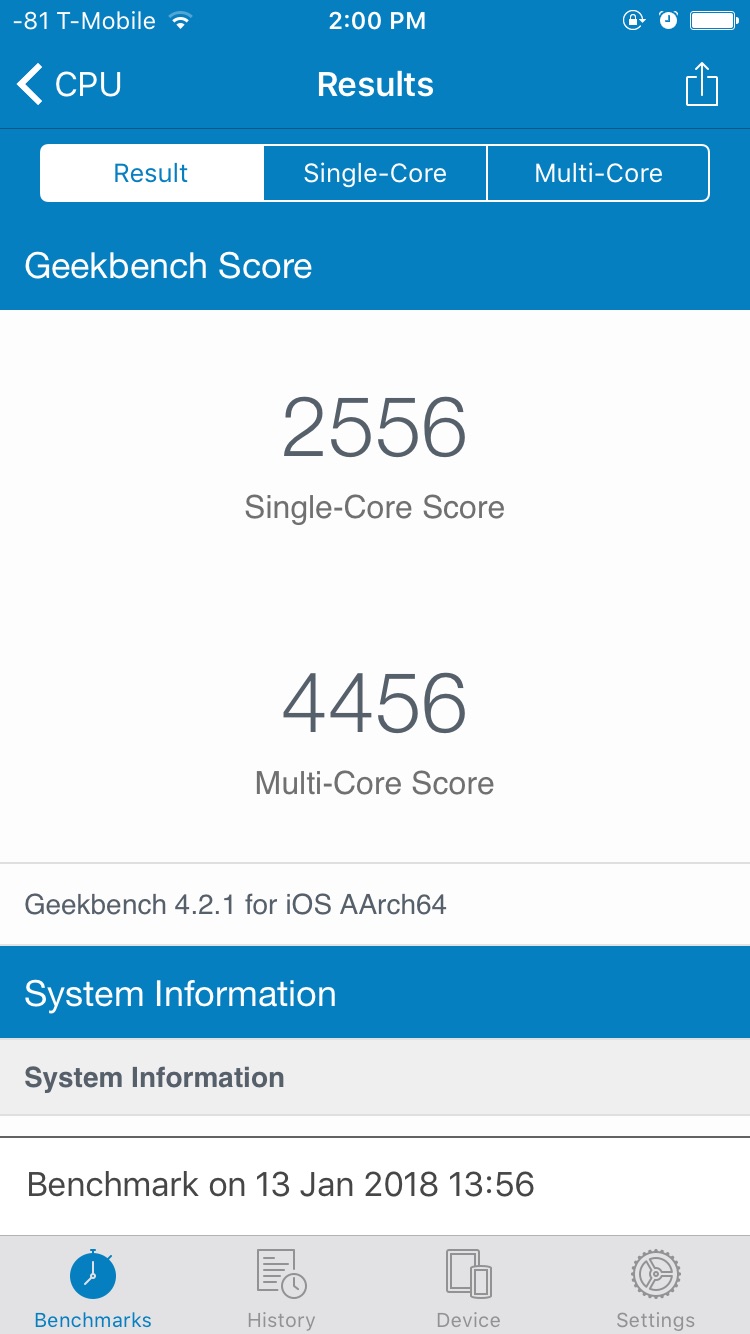

I changed the battery on my 6 using a 3rd party battery. My Geekbench scores were about half speed with the bad battery. New battery got it back to the Geekbench standards.
Performance wise (iOS 11.2.1) with the old battery was atrocious. Practically unusable. With the new battery, it's OK ... much better than when throttled, but nowhere near the performance under iOS 10.3.?
