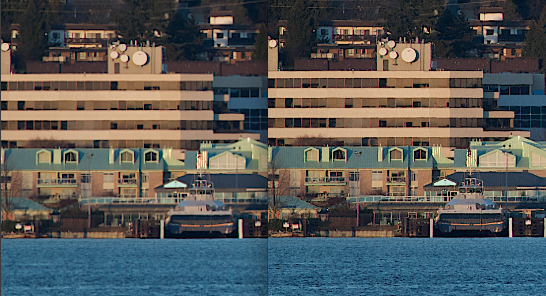

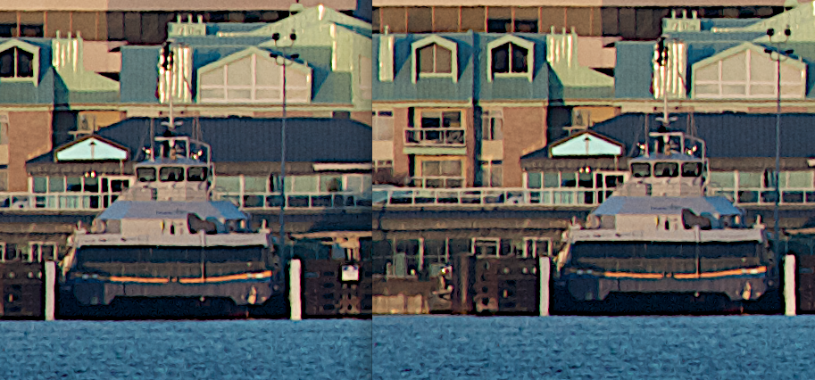

Ok. I was trying to find a shot that illustrated this better. Sorry for the tiny images but I think you will be able to see what I'm talking about (I cropped them from a larger image to illustrate my point). The first pic on the left is a screenshot from the "sharpest point" during the loading process. This is an image that has already been rendered and had post processing adjustments. The second screen shot is from when the image has fully loaded in the viewer in Aperture 3. The third screen shot (from left) is from viewing the image in full screen in Aperture 3. The final screen shot on the far right is the full resolution export to my desktop.
(BTW this images were cropped to try to be as close to the same size as possible so none are "blow up" from a small file. This is pretty accurate to what I am seeing on my screen. I know screens vary so it may not look the same to you on yours)
Clearly the first pic (the "during loading" pic) is sharper than the second one which is the final loaded image. The third pic (the full screen view) while not as sharp does look better. This leads credence to what Ruahrc was saying in his post. The final pic on the far right (the full res export) looks the best and I'm happy with it. I know this is getting confusing but the second pic from the left (the softest) is the one I see when I'm working in Aperture 3. My concern is that I'll come back to a pic like this one day and re-correct it and perhaps oversharpen it. Or I'll not chose it for something because it looks soft. I want the image on my screen that I'm working on to be as close to what I'll actually see when exporting or printing as possible. I don't know if it's a setting or something that I'm doing or if it's just an Aperture thing😕
Hope this makes some kind of sense. Thanks for helping.

So do you have your photos in an Aperture library, or are you keeping them in folders on an external, and then opening specific files in A3?
My files look soft when "processing or loading a preview", the get sharper. These are RAW files, as that is all I work with.
Picture No. 2 does look a bit soft. However, I tried this with several images on my system and could not duplicate this. I tried full screen to be sure that I could see any changes. When I click on an image I immediately get the low resolution jpg and a second or so later the rendered RAW.
Try this. When viewing an image press the M key and release. This will display the master image with no processing. At the top of the screen you should see a small label appear saying "Master Image" with a small film icon. This will show the image before any processing. If this looks good then it must be that some sort of processing is being applied.

All of my photos are in an Aperture library. Mine do the same as you describe but then at the last moment of loading something shifts again and they soften a bit.
I've checked the master image numerous times trying to verify that I'm not just seeing things. The master image is sharper (to me) but not as sharp as the final exported image. Which makes sense because I always sharpen a little for RAWs out of my D90. As you said this is leading me to believe that some sort of adjustment is being applied either by my selection or by Aperture as the image is loading. The thing that I don't get is that the exported image looks fine. It looks better than the image I'm working with in the viewer.😕

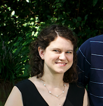

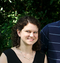

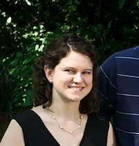

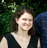

Alright. I think I have found my issue. It's with the straightening tool in Aperture 3. Attached are two more of the same images. The first one is with the straightening applied and the second one is without the straightening (but all other adjustments). I know it's hard to see but this is what is softening my pic in the viewer. The second unstraightened shot is clearly sharper. After I saw it I googled it and found this thread. The discussion starts with the 5th post.
http://discussions.apple.com/message.jspa?messageID=10951896
I haven't found any resolution to it though. It has now become the proverbial thorn in my side. I guess my plan (since it's driving me nuts) is to leave shots unstraightened until I am done with post processing. Straightening and cropping are usually the first things I do. Like I said earlier the images look nice and sharp when I export them as a full size jpeg, tiff, or whatever so the problem only seems to be with how the Aperture viewer is rendering it after the straightening and it's not effecting the actual image that is exported.
The worst of this is I am a habitual horizon rotator and I use the straightening tool a lot. I guess I'll really have to focus on getting a straight shot from the beginning. Can anyone else verify or duplicate this?
Thanks
So I'm not crazy, this is a relief. I noticed this as well only when I do even the smallest horizon adjustment with the straightening tool. Its the only adjustment I noticed this on. I have a few vacation photos I still havent touched up because it destroys the image when I straighten it.
Thanks

I can easily see the sharpness diff in the 2nd pict vs 1st pict.
I'm glad you confirmed your sanity🙂 Mine is still up for debate. Following my new obsession with straightened-softness I searched for all my shots that had a straightening adjustment. It seems the ones it effects the most (or at least they are the most noticeable) are the wider shots with people or objects on the edges. Tight shots don't seem to be as noticeable to me.
The biggest relief though is it seems to me that the straightened-softness feature does not show up when the image is exported. Do you see the same with your exported images?
