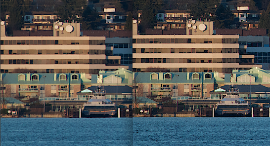

Again, the image on the left is how Aperture renders a sharpened image preview. The image on the right, is how DPP renders the same sharpened image in it's preview, AND how Preview renders the image if you export from Aperture as a full-size TIFF. For some reason, Aperture is not WYSIWYG.

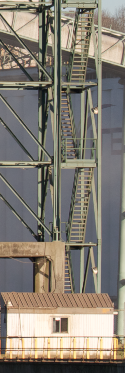

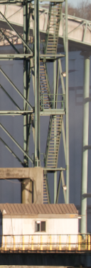

I spent a bunch of time this evening, trying to get to the bottom of this.
JDDavis... if you're still following this, I'd like you to try this out as it's actually very different from what you've reported.
I've found that I can get a preview in Aperture that resembles the output sharpness if I do the following:
- View the image in full screen mode (keyboard shortcut "F")
- Rotate the image more than +/- 0.3 degrees
You can observe the change in sharpness (only in full screen mode) by monitoring a detail in your photo while using the straightening tool... you will find that as you pass close to 0-degrees rotation, the image is soft... as you rotate the image beyond +/- 0.3 degrees, it sharpens up.
This effect can't be seen in default window mode. In fact, you can see the difference in sharpness after rotating by more than +/- 0.3 degrees if you simply toggle between full screen mode and window mode with "F".
Attached are two screen caps of the same image... the first one, is not straightened. The second one was adjusted to -0.4 degrees. Look at the stairs and the roof of the shack. Same image. No other adjustments after importing RAW... just one is slightly rotated.
This is bizarre. Can anyone else duplicate this?

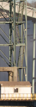

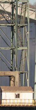

Again, here's how I recreate the problem...
- Import RAW
- Make no adjustments
- Export to 16-bit full-size TIFF
- View the TIFF in Preview - scaled to the same size as Aperture's preview
- Note that Aperture's preview looks softer than the TIFF
- Go to Full Screen in Aperture "F"
- Rotate the image more than 0.3 degrees using the straigtening tool
- Note that Aperture's preview now looks as sharp as the TIFF
