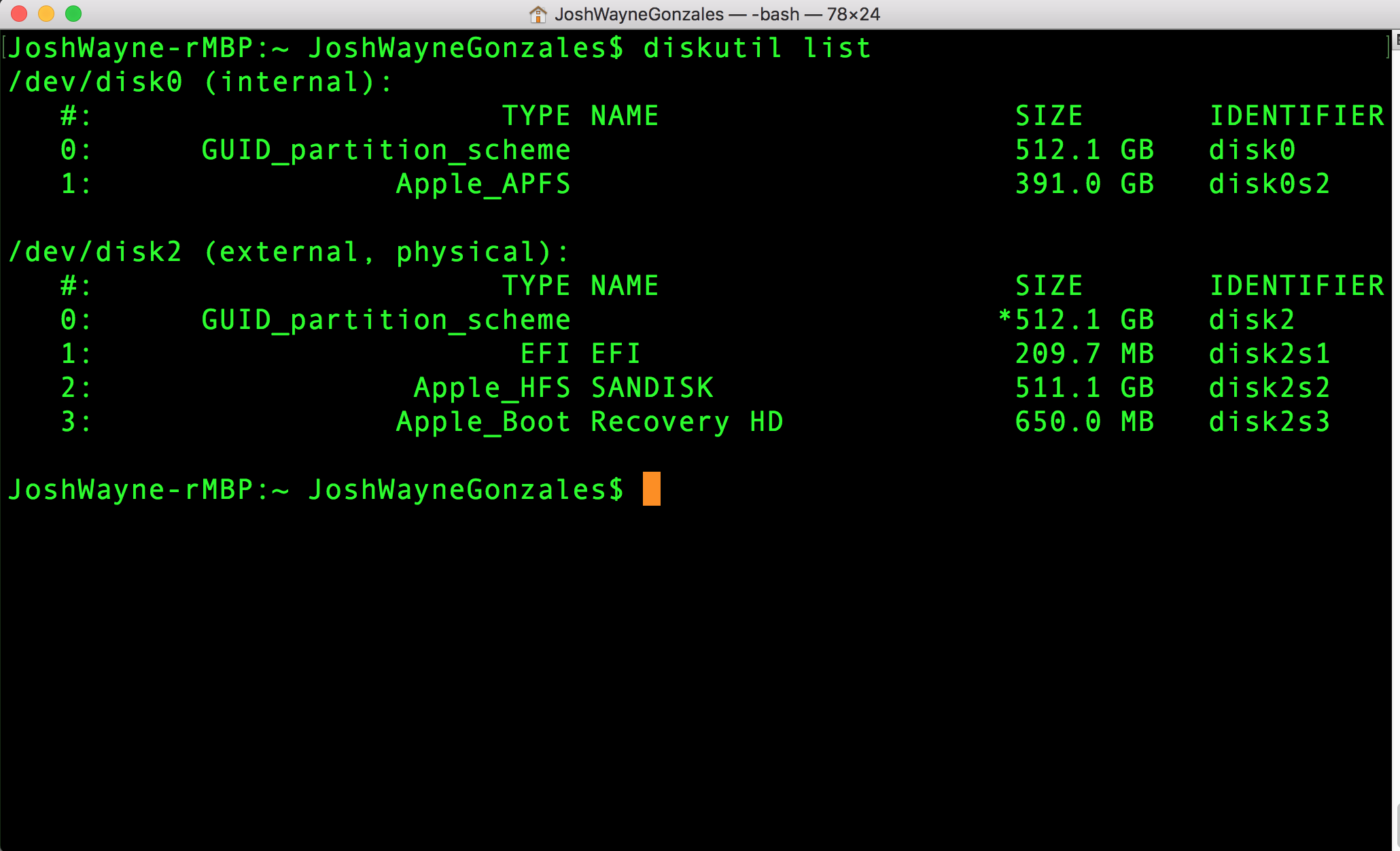

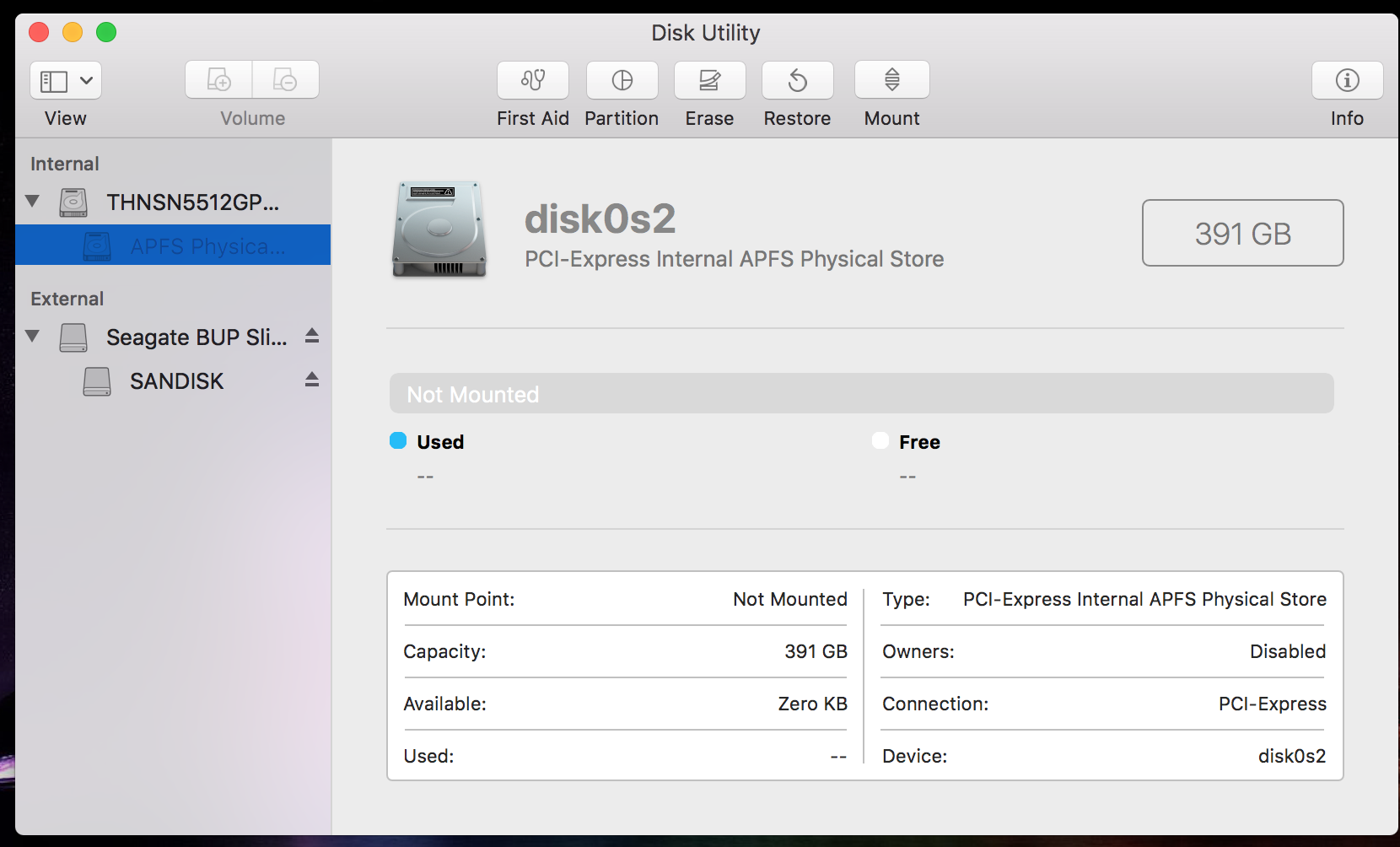

Hey there,
So I partitioned my SSD to make room for Windows Bootcamp. Everything went smoothly until I was taken into windows and asked to format the partition that windows would be installed on. I installed windows and everything worked fine. UNTIL I restarted my computer to get into OSX, I was unable to so I booted to recovery and saw that my Mac HD was unmounted and I was unable to mount/repair it. The APFS container was gone and I'm assuming that this is why I can not access my hard drive. My original hard drive space is 512.11GB, however both the APFS volume and disk0 show a max space of 391GB.
My question is, Is there anyway to create a container around my current Mac HD that should be in a container?
Am I pretty much screwed, or is there hope for recovering my data?
I appreciate all your time and help. I've attached pictures for reference.
This is High Sierra 10.13.13 MBPr 2014 2.5ghz 8GB RAM 512GB Toshiba NVME M.2 SSD.

Sorry but he is right, is very important to backup data, so if you are not a noob you should admit you fault and take any help without insulting. Especially NEVER use Windows to partition because it isn't "aware" and it is just stupid.
You can try with some specific software like these:
https://iboysoft.com/mac-data-recovery/data-rescue-apfs-data-recovery.html
https://iboysoft.com/mac-data-recovery/recover-lost-data-after-deleting-apfs-container.html
Why does deleted container cause data loss?
Firstly, a single APFS container holds multiple volumes and we save data on volumes. Therefore, if we delete the APFS container, all volumes are deleted at the same time and data stored on these volumes are lost.
Secondly, the APFS container contains the recovery partition and a couple of other system partitions. Thus, if you delete the APFS container, the operating system is unable to locate files saved in each volume.
Tips of deleted APFS container
After deleting APFS container, keep in mind that the more operation you do, the less data you get back. So don't make any further operation, including creating a new container and adding a new volume for these operation will cover the original data.

Thanks for that info. For the record I did not partition in windows, I reformatted the partition that I created in OSX within windows. Also, I did state previously that am currently using my Mac booted from my external backup. He didn't offer any help, he just came here to chastise me with information that I already knew.
Regardless I really appreciate your comment and help, I was able to retrieve the data that I had not backed up using APFS data recovery! You definitely saved me a lot of time so thank you!!
