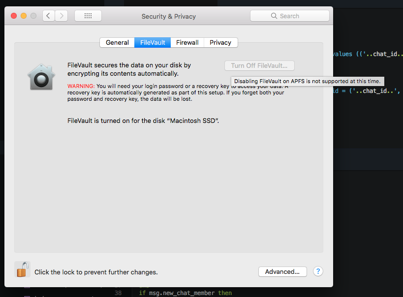

I’m on the opposed side of the coin: I had FileVault enabled before upgrading and now I can’t turn it off:

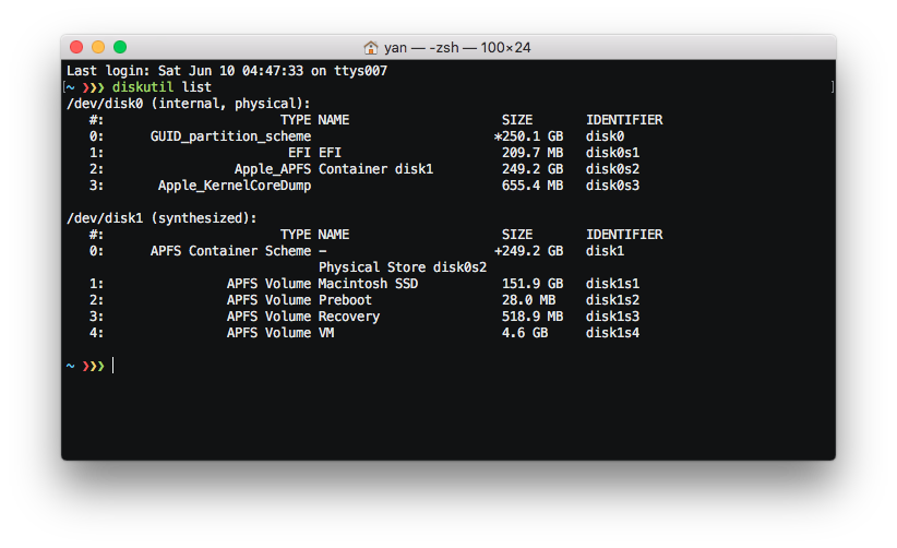

By the looks of the partitions, FileVault no longer uses CoreStore, using APFS multikey encryption instead:
