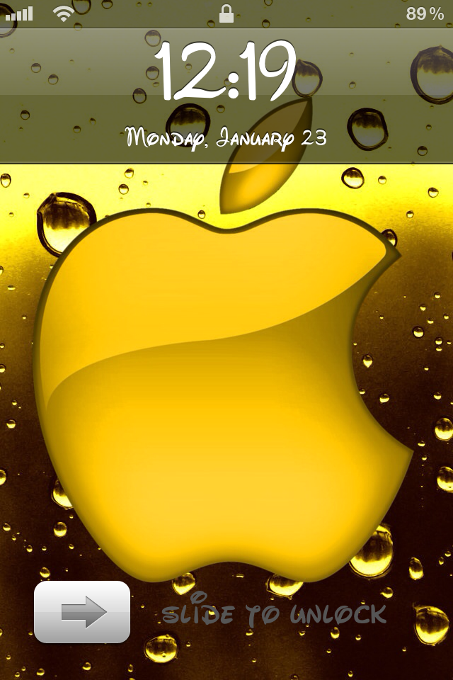

move2unlock
i hid the slider and use the "move screen to unlock function"
you can get rid of the clock like you stated as well
like this but for 'clock'

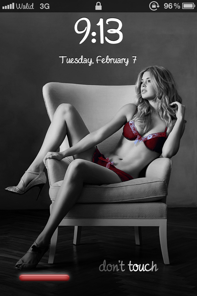

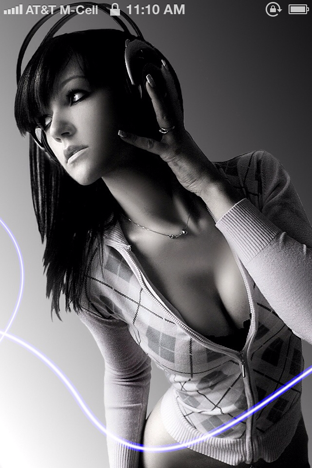

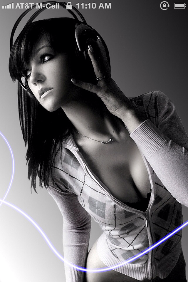

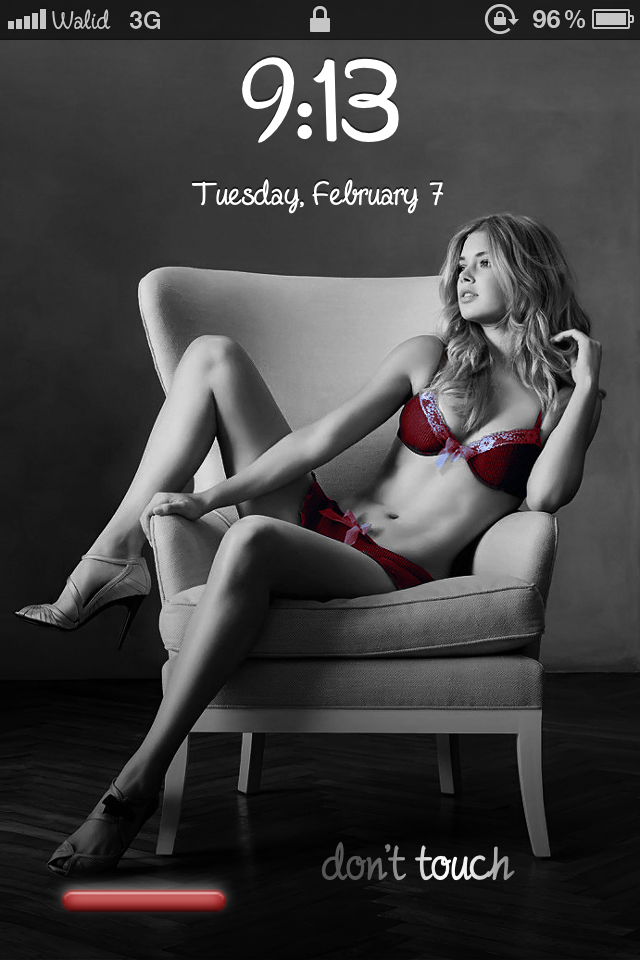

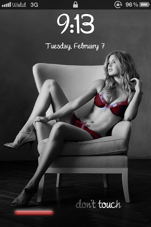

it works 🙂
COOL!.. this is exactly what i needed.. i deleted the barLCD and it worked.. thanx..
isn't it look amazing ??? 😀
all this without the need of winterboard
about the inner slider background, the file is -
/System/Library/PrivateFrameworks/TelephonyUI.framework/WellLock@2x~iphone.png
about you aDRock1154, you can add '%' at the end instead of deleting the file.
