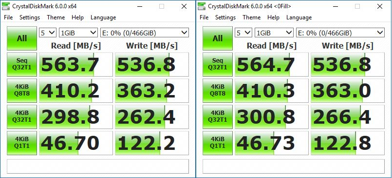

I posted this video quite a few times. It’s my 840 Evo connected to one of the native SATA port.
I really doubt if NVMe can make it noticeable faster. 3x faster? 6x faster? How? Where the extra performance coming from? A normal PCIe SSD’s 4k random read performance is more or less the same as those good SATA SSD. This is the main factor to decide how snappy your system is. However, still up to certain level. My understanding is once moved to SSD, this low IOPS bottleneck is removed. So, further improve storage connection speed won’t help much. Even go for a higher IOPS SSD may help nothing (especially NVMe mainly shine in high QD which a normal user rarely does).

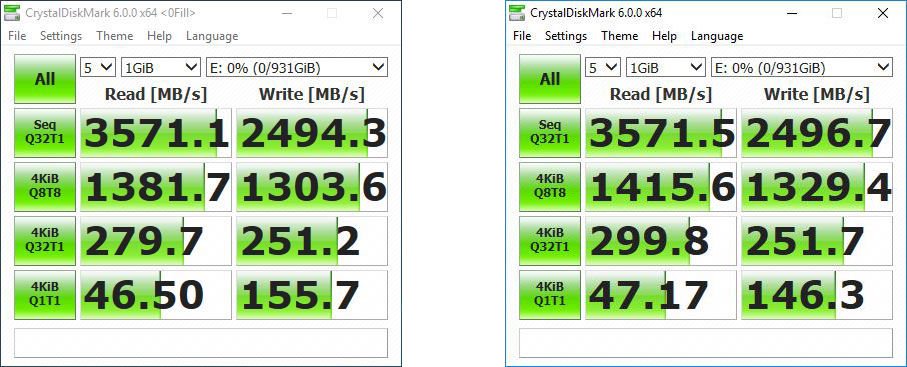

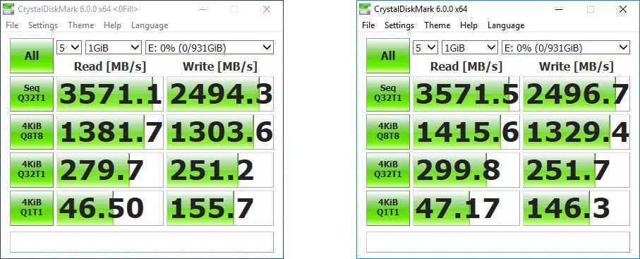

For your info, this is the 970 Evo's benchmark, 4K random read QD1 is about 46.5MB/s.
Source: https://www.techadvisor.co.uk/review/ssd-hard-drives/samsung-970-evo-review-3677171/
And this is the 860 Evo's benchmark from the same web site, 4K random read QD1 ~46.5MB/s
Source: https://www.techadvisor.co.uk/review/ssd-hard-drives/samsung-860-evo-review-3670806/
So, despite the 970Evo has much higher sequential read and high IOPS, it's 4K random read performance is pretty much the same as the 860Evo.
This is what I know, and my explanation to your situation.
There are few users here claim that NVMe make their system astonishing snappier than SATA SSD. I really don't know how can that happen. Hopefully they can tell you the tricks.

And this is the 970 Pro's result. 50% better than 970 Evo on the 4K read. So, may be it can really provide noticeable improvement on general system responsiveness.

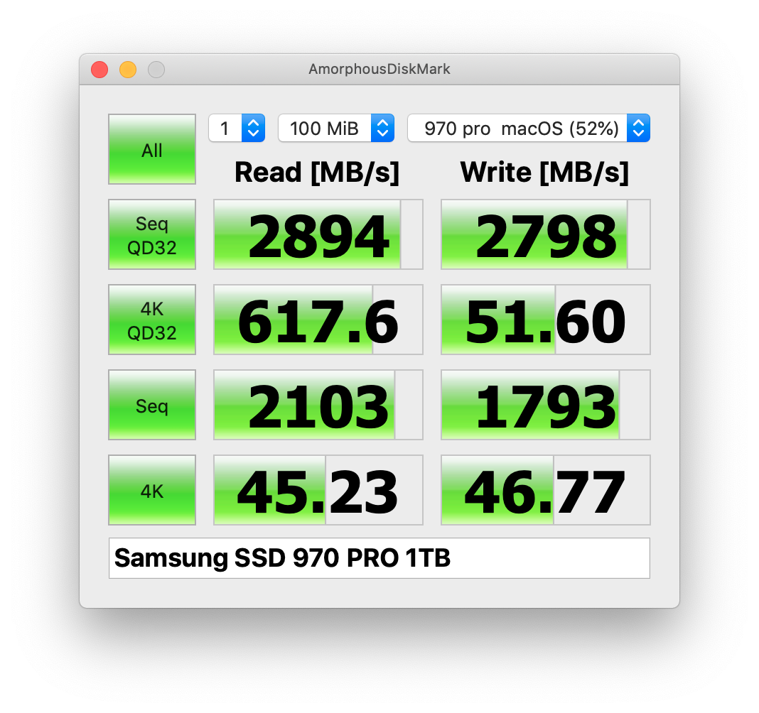

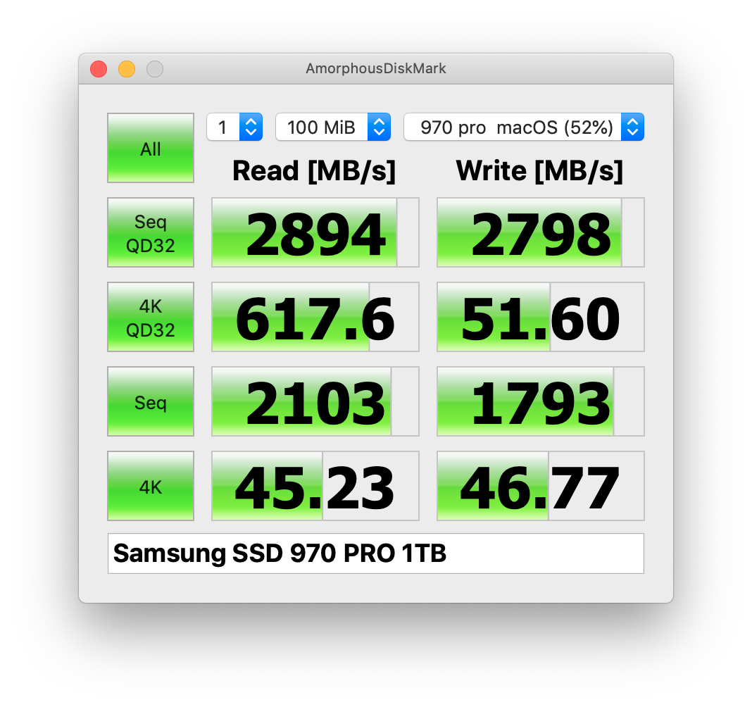

In my case, with my workflow, running with a 1tb PCIe 3.0 Samsung 970 pro installed in the highpoint ssd7101-a, the thought that any sata III hard disk running on the cmp is faster.. is just silly.

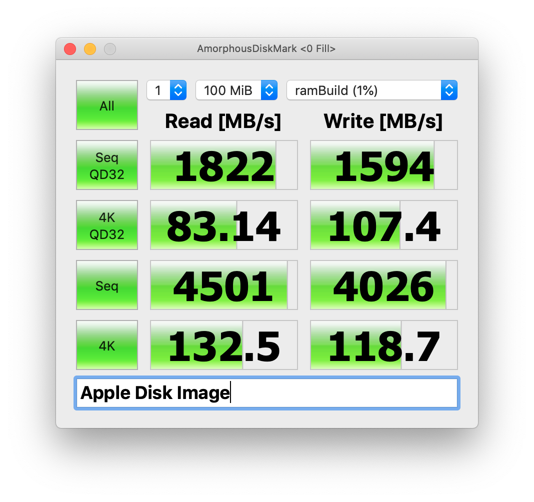

For max performance I run a lot of operations from a 20GB+ Raid 0 ramdisk. Ram is cheap and it's faster than any other solution.
