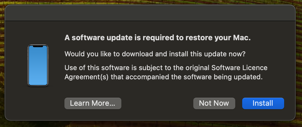

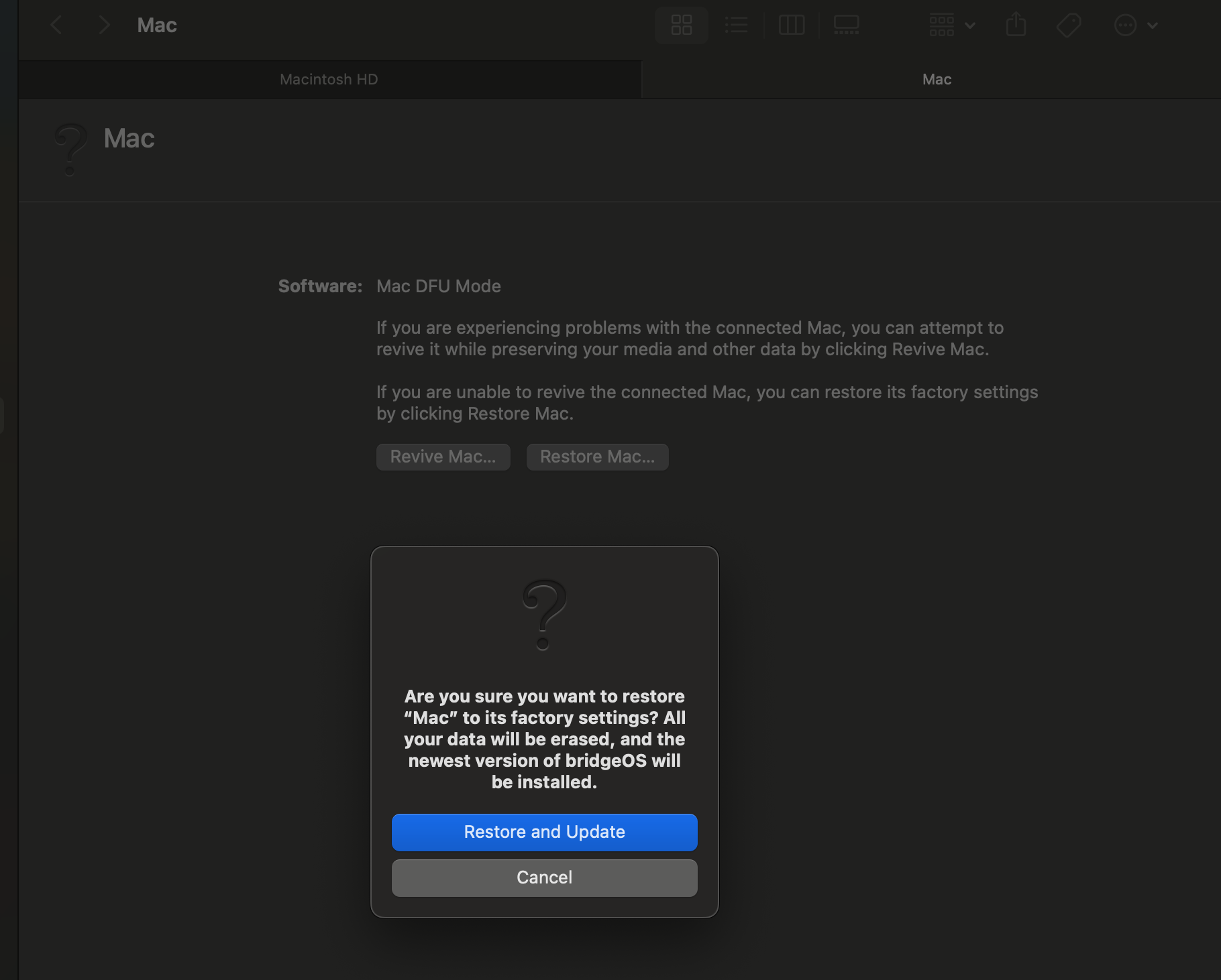

Instead using , DFU window in Finder
And it's interesting to see how the desktop mac is presented. A desktop mac is now an iOS handheld device?

The configurator app still works. Also, where do you see a desktop Mac being presented as an iOS device in those screenshots?
I don't know, the Configurator app does not work in my case. It starts installing the software, but the progress bar didn't move and then after 5 mins, it would show the other mac had disconnected from DFU mode.
The last screenshot. I did not use an iPhone for this process at all

DFU restores on T2 Macs don’t fully install macOS. DFU restores only install the T2 firmware. You still need to do internet recovery to get macOS on the computer after the restore. By contrast, a DFU restores on an Apple Silicon Mac does fully install macOS.
I know. DFU Restore mode installs BridgeOS and lock the new SSDs to the T2. After successfully installing that, it will restart and Internet Recovery will start.
