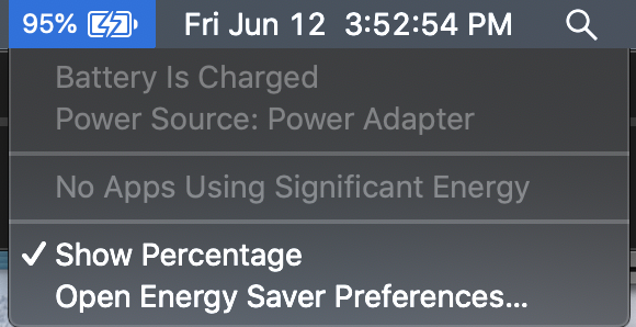

Here it is at 95%:

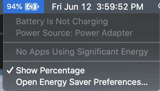

At 94%:

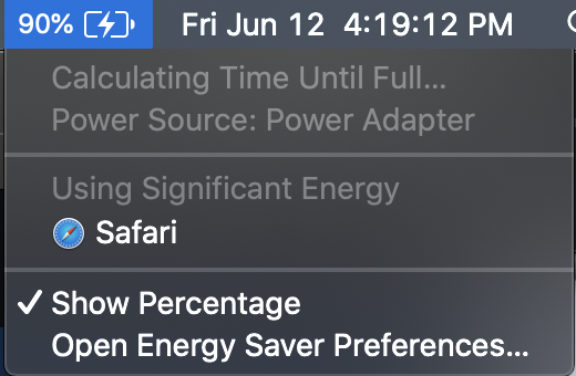

At 90%:

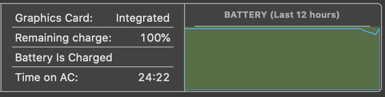

And the Activity Monitor showing the BHM induced cycle:
As you can see, the Battery icon is showing fully charged and plugged in even when it is below 100% and even when it says "Battery is Not Charging".

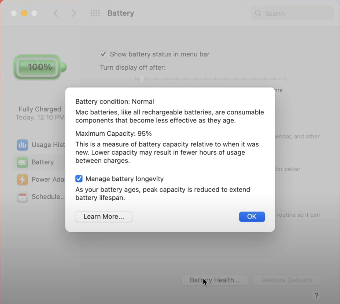

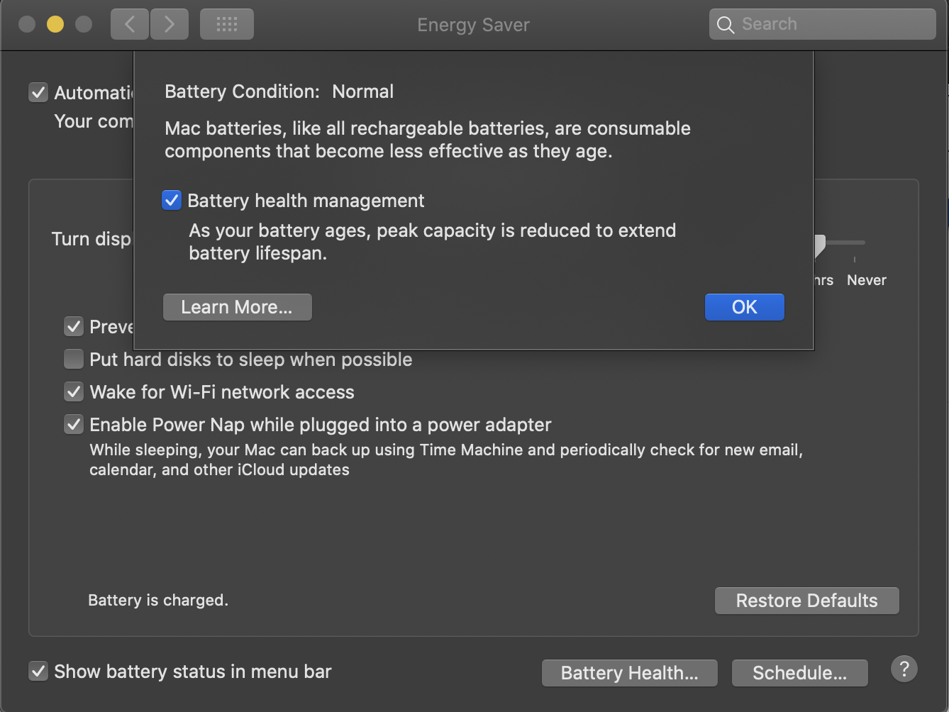

Here is something that I found perusing BigSur videos. Apparently, there are two different battery management modes offered in the upcoming macOS. One who's description matches the one in Catalina ("Battery health management") called "Manage battery longevity" under the "Battery Health..." button, and an additional one under the new Battery preferences that replaces Energy preferences called "Optimized battery charging" that mimics iOS and mentions the "80%" maximums. I sure would like to know how these differ from each other to verify intended function. Maybe that would help gain insight into the Catalina function. ANYONE???
Catalina:
BigSur:
BigSur:
