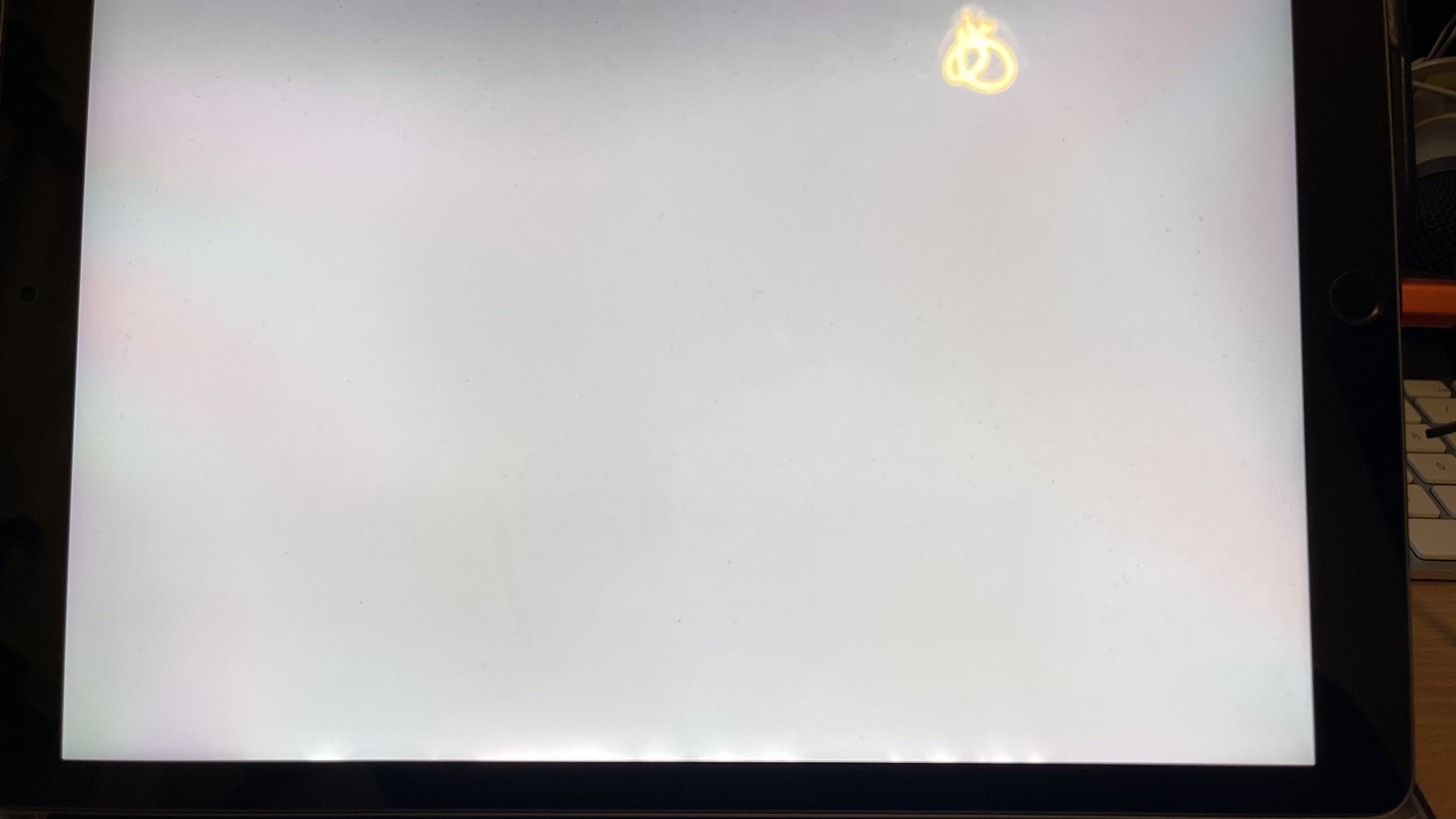

In case this helps any UK owners. My 2017 13" Non-TB suffered a similar issue, horizon block lines at the bottom of the screen like this when the laptop gets hot:
I took it back to the Apple Store, out of warranty, and they ended up replacing the display for free.
The only reason they replaced the display for free was that the Apple diagnostics program showed a failing battery that was replaced less than 12 months ago (replaced free under the keyboard recall). As the battery was replaced less than 12 months ago they also covered the Display. This could have been for the fact that the Uk also have a 6 year consumer law.. I have no idea if they had replaced this if the battery wasn't also faulty though.
