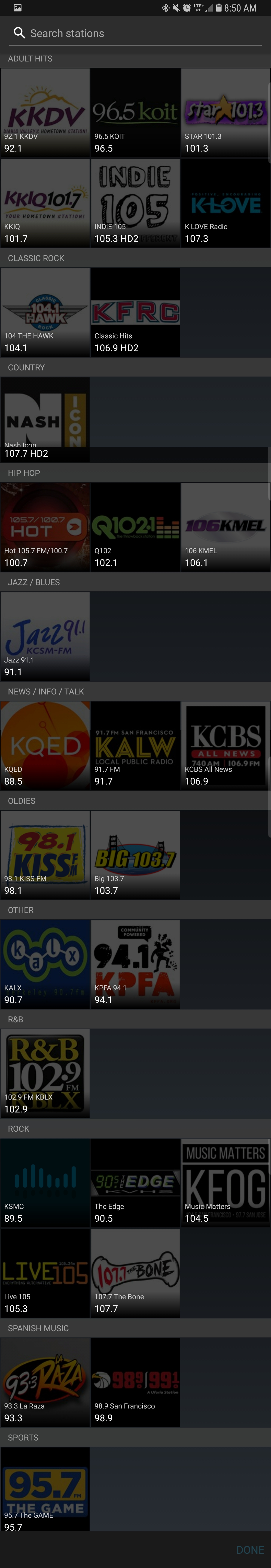

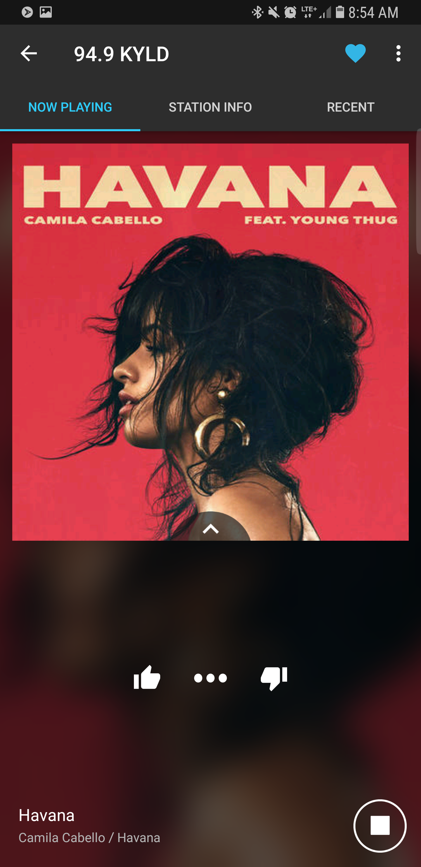

Well, no... Samsung has their FM functionality readily available, and I believe all US carrier variants since the S6 have their FM radios unlocked. See attachment-- I'm getting FM channels on my S8.
