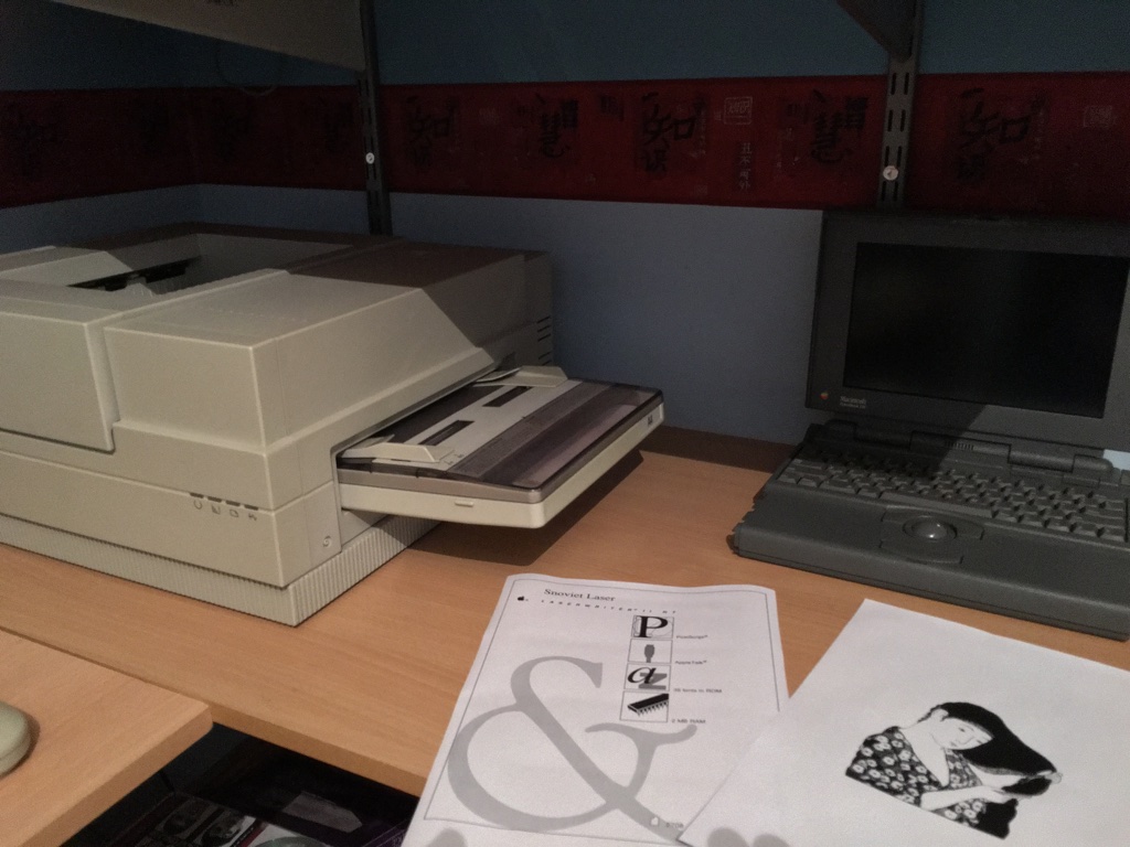

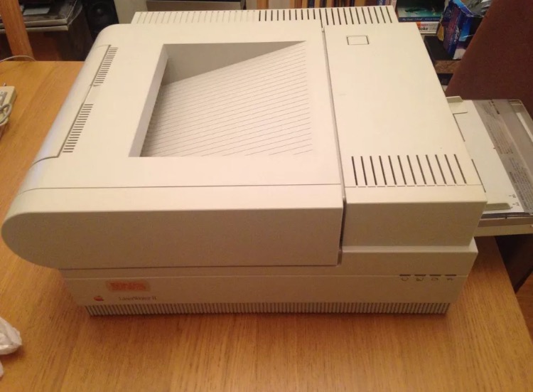

I was looking to get an old apple laser printer to compliment my Mac collection. I wanted one that would of course be connected via LocalTalk so I could use it with my 512Ke up to my G4 systems via the EtherTalk adapter.

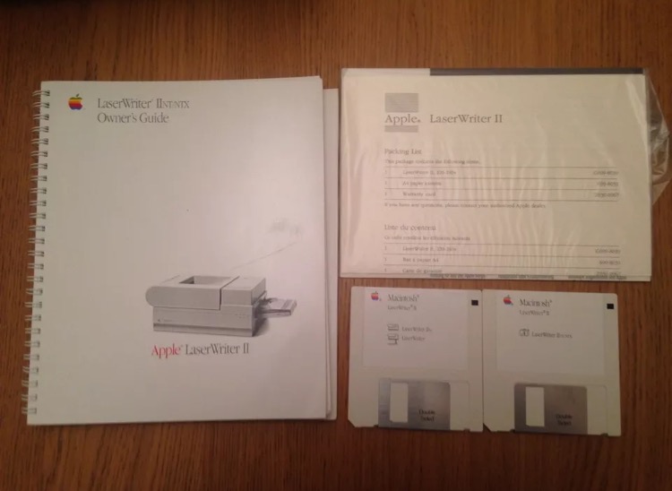

I was lucky to have found a mint condition LaserWriter IINT on eBay for only 60 bucks. It arrived safely and so far I've hooked it into my LocalTalk network and interacted with it from my 512Ke. It came with all the original documentation including the ring binder manual and floppy disks. I installed the software from the disks to the HD20 on my 512Ke which is thankfully running System 4.3, the minimum required.
From there I could rename the printer, initialise it and send print jobs to it all without a problem. Now I don't yet have a toner cartridge for it, but I have one on order. When it arrived I might post a video of it in operation as I actually can't seem to find any contemporary videos of one in operation. I'll update this thread once the toner gets here from Italy of all places.

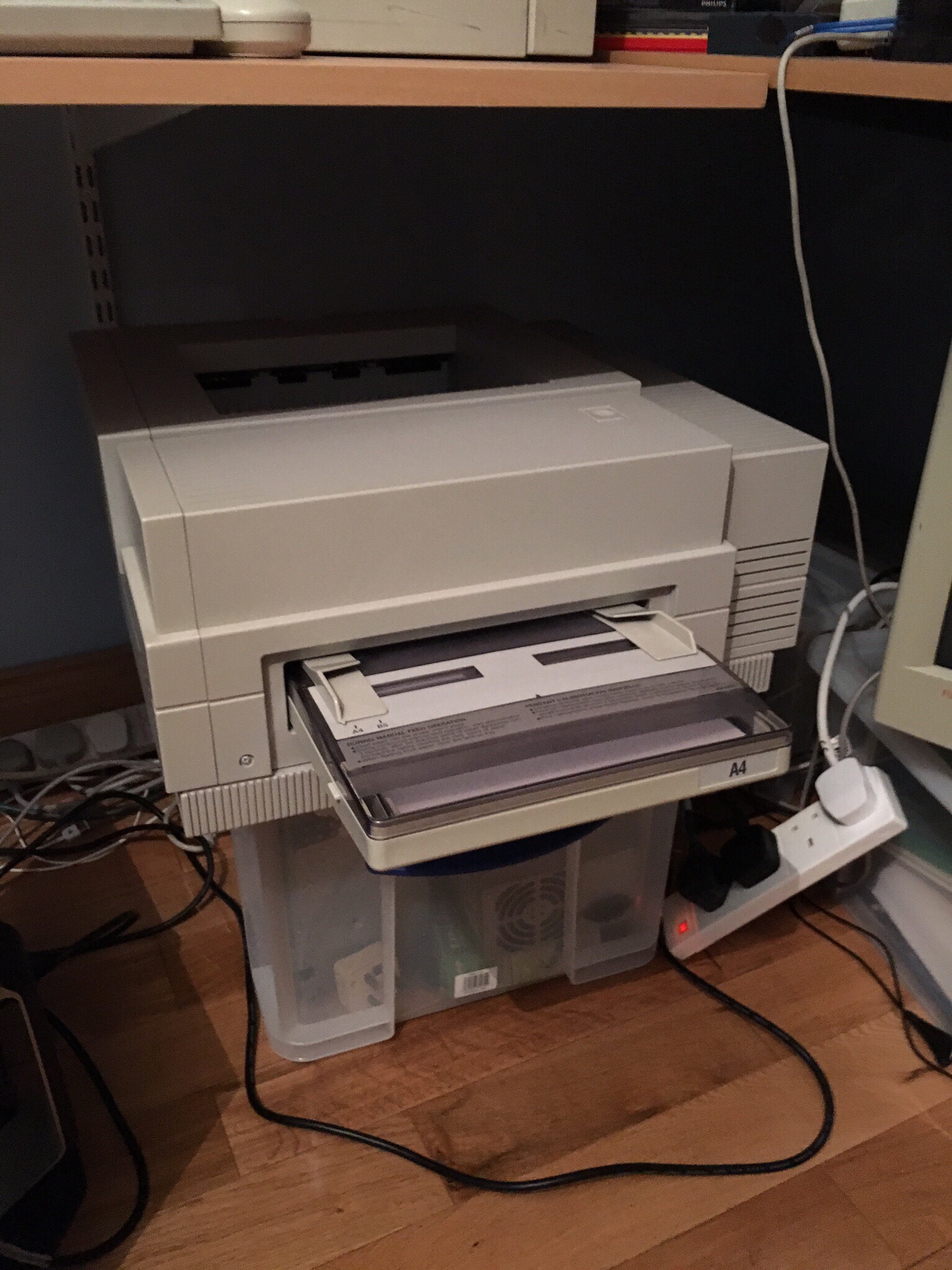

Looks like I've run into a spot of trouble. The cartridge arrived with box and kit. I followed the delecate instructions to swan and clean the rollers and insides. I then placed the new toner inside the machine and pulled with plastic tape out.
However, now I am getting a flashing Paper Jam and Paper Empty lights. Red flashing. Previously this was not there.
Before I only had a missing toner light, but now even when I remove the toner I get hear flashing jam and empty red lights on top of be empty toner light.
Did I do some mega damage already with a cotton swab? :/
Probably not. IIRC there is a capacitor inside the AC Power Supply that leak and require replacement. IIRC this causes an intermittent flashing red paper jam and paper out lights.
The AC power supply diverts AC power to the fuser assembly with a small control circuit - it's this circuit in the AC power supply PCB that fails. It took an age to discover the cause of this fault many years ago (pre-google). 😉
The AC Power supply is in the box that the AC power cable plugs into, just below the fan.
EDIT: whilst this can be a failed fuser (bulb, saftey cut-out, or temperature sensor), which is the original fault description, it's most likely caused by the failed capacitor in the AC Power Supply.

EDIT 2: after you remove the offending capacitor, you'll need to clean the board and check for any corrosion and re-solder/repair as necessary.

--- UPDATE: Success at last! ---
This has been quite more of a saga than I assumed it would be!
I actually ended up acquiring a second toner cartridge, this time a HP one for a LaserJet 1. It's the same type, and it's also far more recently in production so I thought it would be more likely top yield positive results. (I also managed to spill lots of the original one all over my feet while I wasn't paying attention...)
I also acquired a second LaserWriter II in the meantime which puzzlingly displayed all the same problems and symptoms as the first one, despite the seller claiming to have tested it as working.
In any case, I tired a few more times to get the HP cartridge working in my 1st LSII. At first it would give me the same blinking lights. But then I figured that it would only gave me the blinking lights issue when I put toner in, and while I was waiting on toner to be delivered it just gave me the "out of toner" light. So then I chanced my arm and fired it up without the toner, waited for it to give me that light, then popped the toner in live and closed the lid again. This time it just looked ready to go. Finally! It started to print it's test page by itself but got the paper jammed. I sent it a print job from my 512Ke and it also got jammed. I left it alone for a while but when I came back the test page had been printed!
Then I sent it some more jobs from the 512Ke and PB140 and after a few hit and miss jams I was getting constant and reliable printing out of it. So whatever the cause of the issue it seems that all is working now. I have since enabled almost all my Macs to work with it over my LocalTalk-Ethernet-Wifi network all the way from the 512Ke to the G5 Quad. I'm even using the Quicksilver as a print server for post-Leopard systems.
Quite happy it is working now after a good run of disappointments. And even more fun that's it's working so well on big network practically serving my entire collection of machines aside from the Apple II. 🙂
