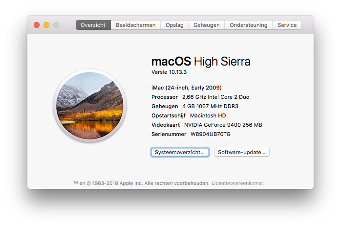

Mine is. And upgraded with High Sierra.

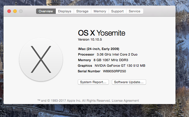

Wow , me too using 24in iMac almost 9 years . But still with OS X Yosermite .

Wow , me too using 24in iMac almost 9 years . But still with OS X Yosermite .View attachment 752629
Might be worth considering upgrading to El Capitan as Yosemite is now unsupported.
El Capitan is the latest version of macOS that can be run on the Early 2009 iMac.

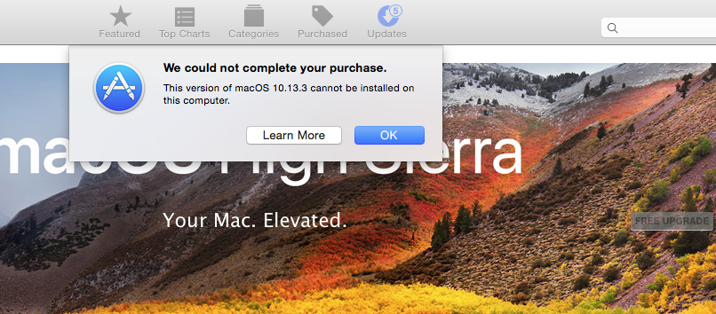

Not sure how to get ElCapitan. Try to click on free upgrade Hight Sierra at App Store but it said cannot be installed .
