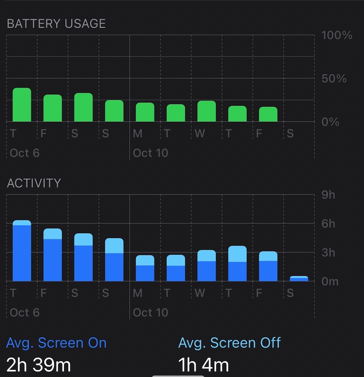

1. The time it takes to shower, etc. ? Call it half an hour, give or take.
2. I’m using the fast charger.
3. I typically have my phone within arm’s reach, but not always. I suppose the battery drains faster without the phone nearby, but I haven’t noticed it doing so. Might be worth noting that I’m typically within range of WiFi when I don’t have the phone for any length of time.
4. I’m using AOD with the new Wayfinder watch face with the compass active. (I expect I’ll get tired of it eventually, but not yet.)
I’m not even pretending to do anything to save charge; I’m just using it. The first couple days I had lingering battery anxiety from my S4 (whose battery would last a few hours if I was lucky). But I quickly got over it.
A good estimator is that I’m using about 2% per hour. So even if I see 25% in the evening … well, I sure hope I’ll be in the shower well before midnight, and the watch is certainly good until well after breakfast ...
(That’s another point worth mentioning: it barely uses any power at all overnight in sleep tracking mode. I might go to bed with 83% charge and get up the next morning with 79%.)

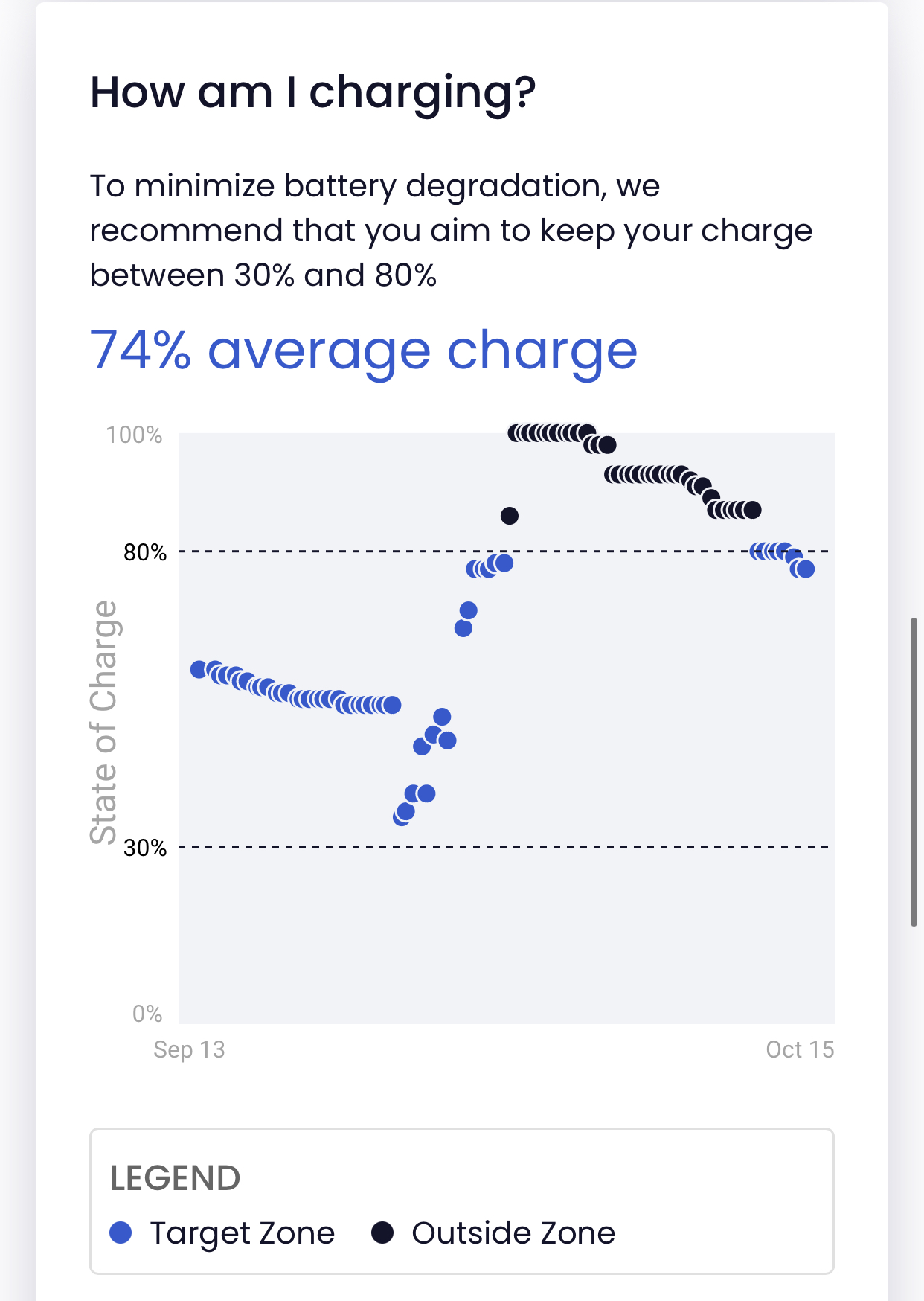

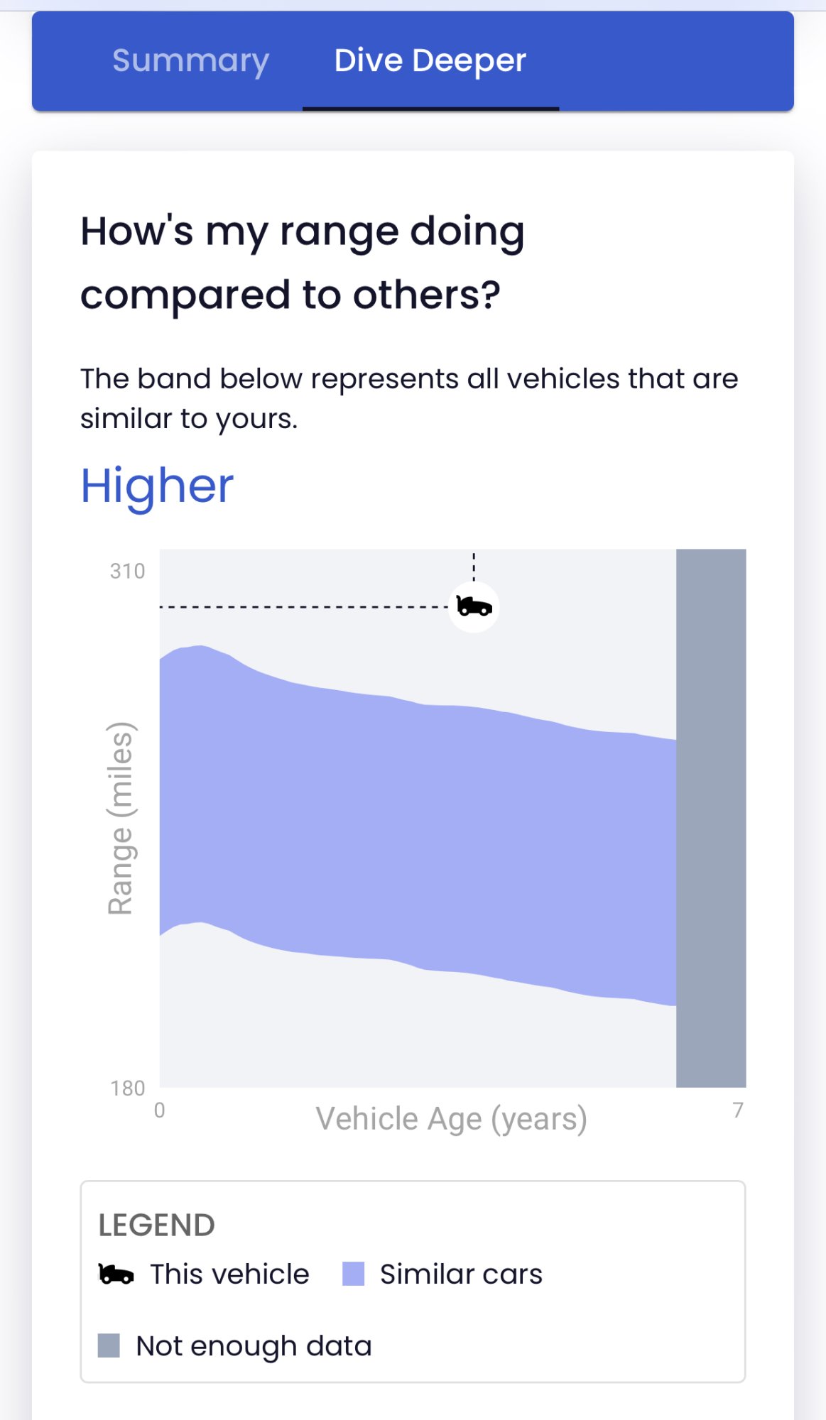

I have an electric car and I think the car makes the reasoning more clear:
I limit my charge level to the range of 30-80%. I am willing to let it fall below 30% if needed and I will charge to 100% if there is a good reason. I still get 100% of the battery when I really want it. And by limiting myself, I will have access to that near 100% for many more years. I’ve attached an example for my car where I intentionally charged to 100% just before Hurricane Ian arrived. The same logic would apply to a phone: use your full 100% when needed and optimize charging so that you have that capacity for much longer View attachment 2094895
I don't know that analogy holds up. Does the phone charging to 100% have the same battery degradation as a car charging up to 100%? It seems to me a car battery gets charged more aggressively, and drained more aggressively as you're talking about far higher and spikier voltage/wattage/etc with a vehicle vs a phone, which both charges relatively slowly and mostly sips power.
My understanding is car battery degradation is far quicker and easier to notice than phone batteries.

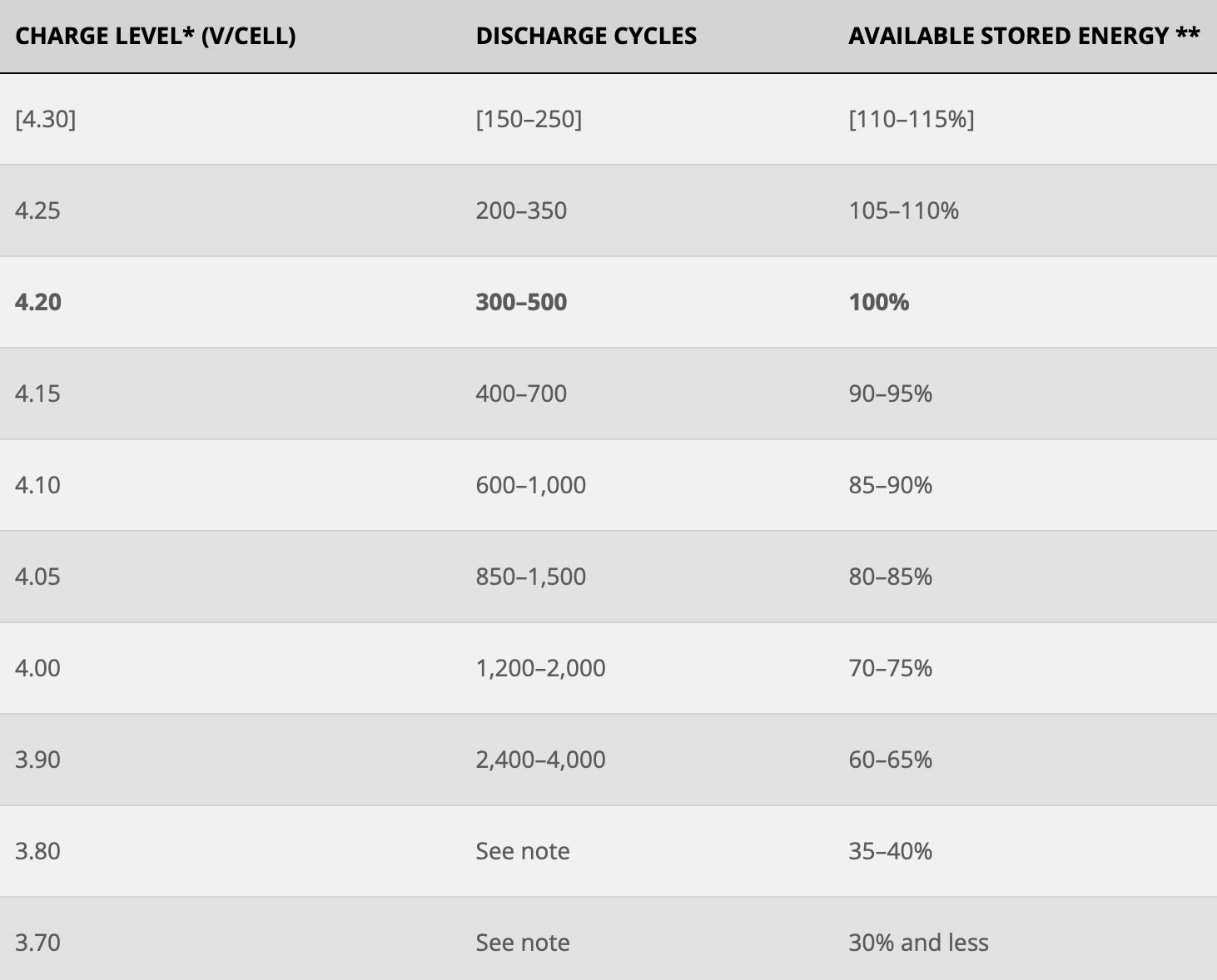

Unless I am misunderstanding the table, it seems inline with Apple’s calculations, promises: up to 1000 charge cycles should provide at least 80% of design capacity.
Also from that article:
A laptop battery could be prolonged by lowering the charge voltage when connected to the AC grid. To make this feature user-friendly, a device should feature a “Long Life” mode that keeps the battery at 4.05V/cell and offers a SoC of about 80 percent. One hour before traveling, the user requests the “Full Capacity” mode to bring the charge to 4.20V/cell.

Note: Partial charging negates the benefit of Li-ion in terms of high specific energy.
