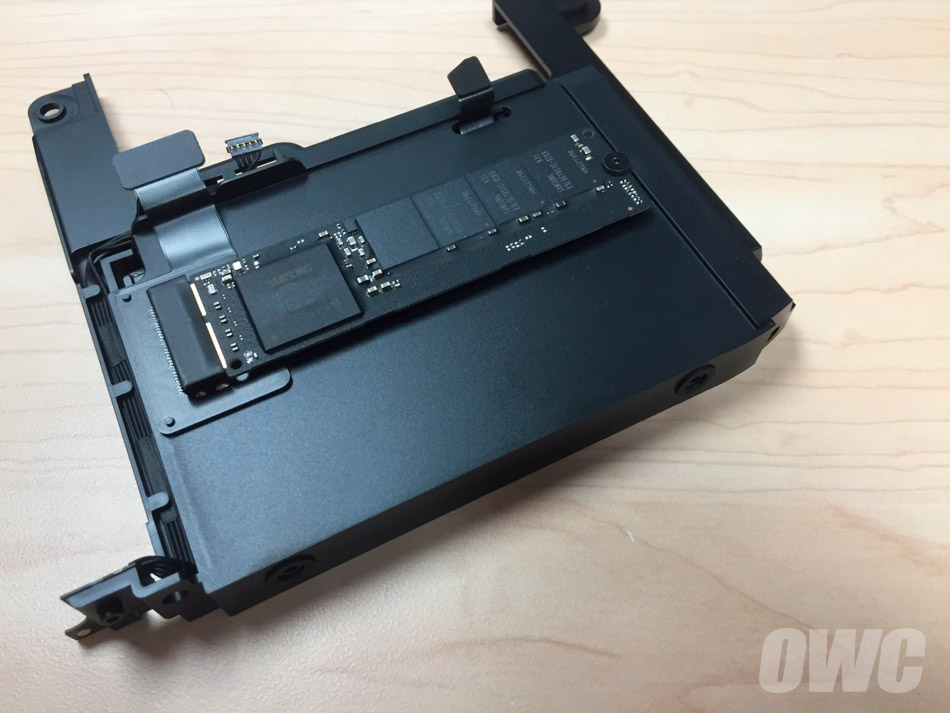

Anyone have the part number for the above cable. Just got a 1tb HDD model 2014 and have a couple of MacBook pcie blade ssd 's spare. Would like to use one to make a fusion drive. Just missing the flex cable.
I can confirm , after looking in mine, you should definitely be able to do the above without removing the board .. (I really neeeeeed that cable !)
Well that is good news, I am sure that OWC will have a Mac Mini 2014 PCIe upgrade kit in short order.

Does anyone know, if you order a 2014MM with the PCIe installed instead of the HD, is that bay just wide open? In theory, you could just order the Ifixit kit and install the cable and HD, retaining the PCIe (if no immediate upgrade is offered).
Yes, the bay is wide open and does not include any hardware or SATA flex cable to connect a hard drive. As soon as ifixit and others sell the parts, we should be good to go. There are some that believe the existing 2012 Mini SATA cable works in the 2014 Mini; I have not ordered one yet to verify that claim.
