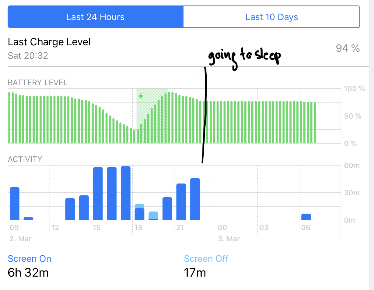

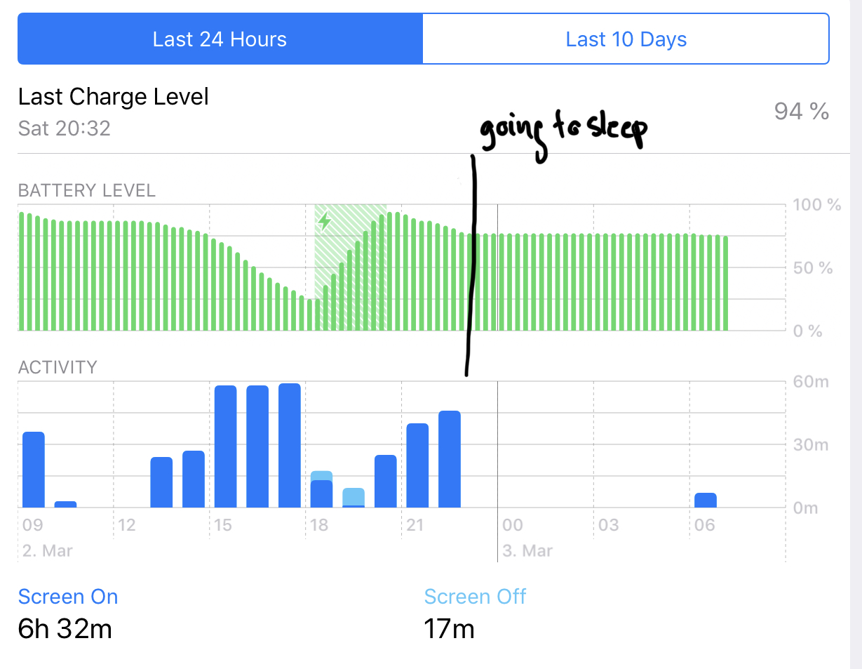

The last beta version really resolves it, at least for me. Tested it for several nights with pencil attached now.

I’m not sure 12.2 resolves this fully. Finally got around to testing it last night with the latest public beta. My iPad’s battery dropped from 80% to 70% over 8 hours with the pencil attached and the pencil dropped from 100% to 91%. Seems like the same bug that was in earlier versions. I suppose it’s possible I didn’t have the pencil attached fully, but that seems unlikely. I will test again tonight.
