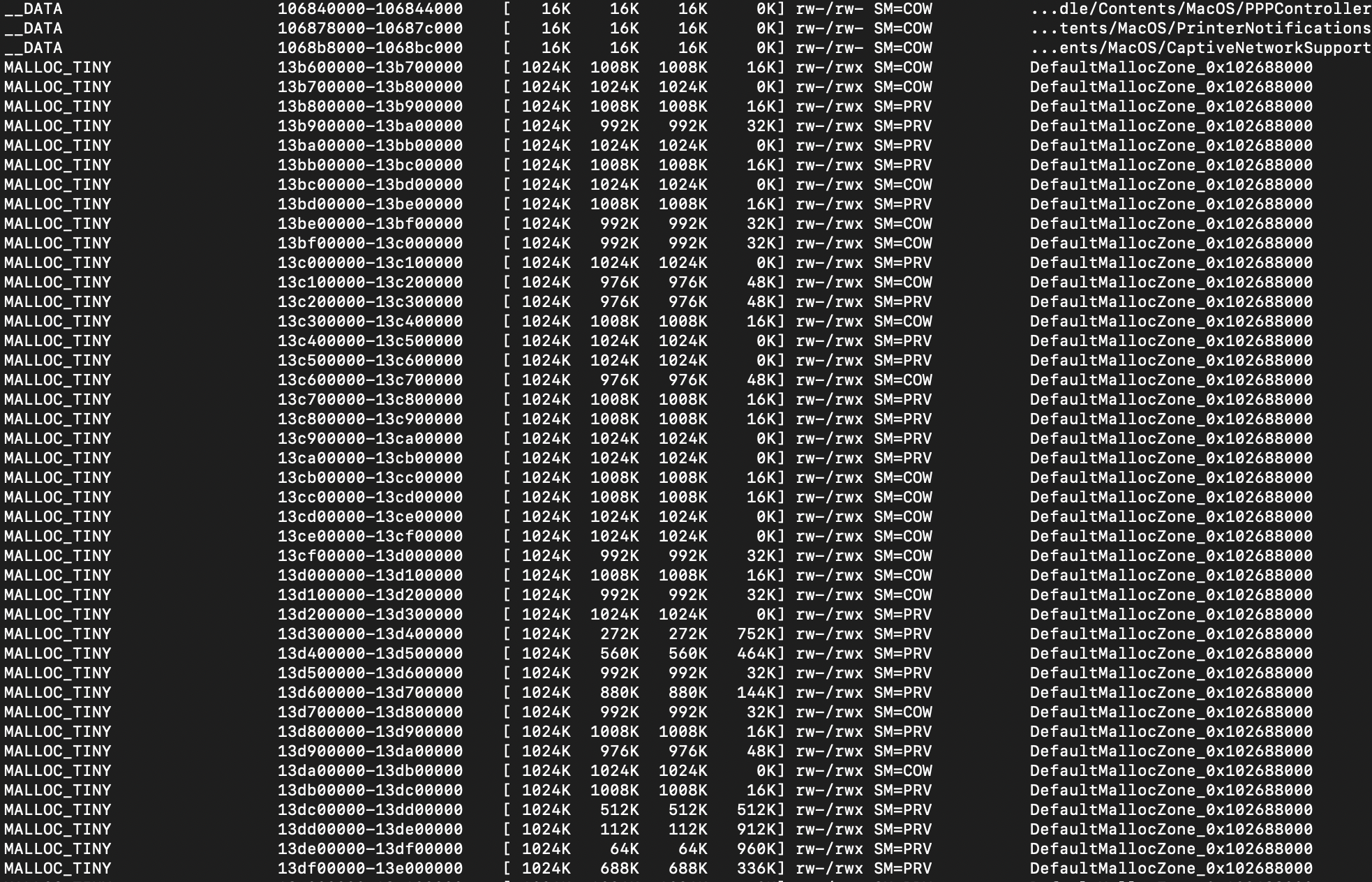

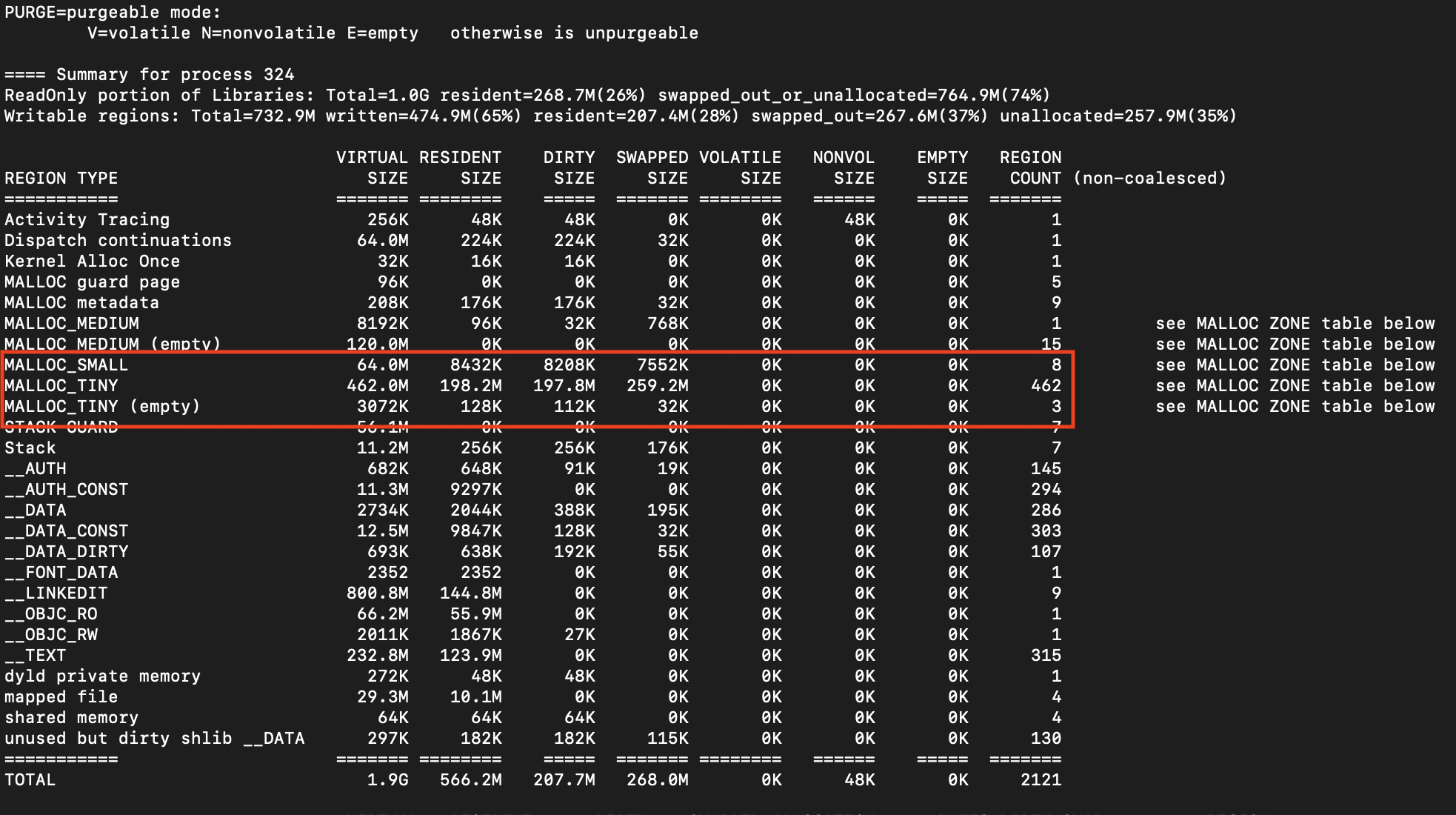

I have identified a memory leak issue in the `configd` process on macOS that I would like to report. This system process runs continuously in the background to manage network and system configuration, but I have noticed its memory usage increase steadily over time without release.
Details:
1. I reported this issue to Apple Support a month ago but have not received a response or acknowledgement yet. I am reporting it again here in the hopes of escalating awareness and priority.
2. This memory leak in a core system process is a serious issue, as it will degrade system performance and stability over time if left unaddressed. `configd` is running 24 hours a day, so even a small leak accumulates quickly.
3. I have provided all necessary data with my original report to help diagnose and fix this issue, including:
- https://discussions.apple.com/thread/254771724
- https://feedbackassistant.apple.com/feedback/12089791
- Figures
4. I have isolated this to the `configd` process by monitoring memory usage of all system processes over time. `configd` is the only one showing steady growth. A reboot temporarily fixes it, but the leak quickly returns.
Please look into fixing this memory leak issue in `configd` as soon as possible. While new features are exciting, ensuring the stability and performance of core system functions like `configd` should be a top priority. Let me know if you need any additional information from me to properly diagnose and patch this leak.

How do your screenshots relate to memory use by configd?
My configd is right now using 3.2 MB and this Mac has not been rebooted for 9 days. I am not sure whether you have something specific to your Mac or just an imagined issue.

Apr 12, 2023
42
18
Yes it's just screenshots, but if you can let apple open source their system, I may just point out where the problem comes from. let's see if any MacBook user who usually plugs in and out, is facing the same trouble.

what about killing configd, restarting it with the -v flag and then see wether the console log as well as the configd bundles and plist files in SystemConfiguration may provide some more hints as to what is going on and why on on your system?
You mention that you traced it down to the power management on your Macbook - like to share some details on that? Additionally: What M-model Macbook are you using? Which Ventura version?

Any idea what triggered the memory leak? I've never experienced the problem.
My platform is Macbook Air M2, this issue usually happens after booting for 4+ days. It seems also related to power manager (?), when I plug-out my mac and then walking to my office, configd may eat 70M+ memory :)

Thanks for your attention. I've just realize this:
/System/Library/SystemConfiguration/IPConfiguration.bundle/Contents/MacOS/IPConfiguration
Dispatch continuations 103000000-107000000 [ 64.0M 176K 176K 16K] rw-/rwx SM=PRV
MALLOC_TINY 145600000-145700000 [ 1024K 64K 64K 960K] rw-/rwx SM=PRV DefaultMallocZone_0x1029d0000
MALLOC_TINY 145700000-145800000 [ 1024K 48K 48K 976K] rw-/rwx SM=PRV DefaultMallocZone_0x1029d0000
MALLOC_TINY 145800000-145900000 [ 1024K 96K 96K 928K] rw-/rwx SM=PRV DefaultMallocZone_0x1029d0000
Maybe it is related to "IPConfiguration"? There are lots of "MALLOC_TINY"
bosskwei
macrumors member
Apr 12, 2023
42
18
Update: this new discovery is sent to Apple (FB12141011)

How do you know it has nothing to do with virtual memory?
Hi, in my understanding, when the memory footprint is below physical memory limitation, the system actually doesn't do a swap, but some untouched but allocated memory will be marked as 'compressed', 'swapable'. So that I mentioned it has nothing to do with swap.
This issues is observed on Macbook Air M2, 16G+1T model, with the latest system installed: Ventura 13.3.1.
Shouldn't that read as swapped_out=0K(0%), you have swapped_out=267.6M(37%)
To clarify, swap function is enabled as system default (never touch sip). So that these `swapped out` didn't really flush to on-disk swap files. Physical memory usage ~70%, something like `top`:
4272M framework vsize, 0(0) swapins, 0(0) swapouts.
From my understanding, these swaps exist as compressed memory blocks and are kept in DRAM.
