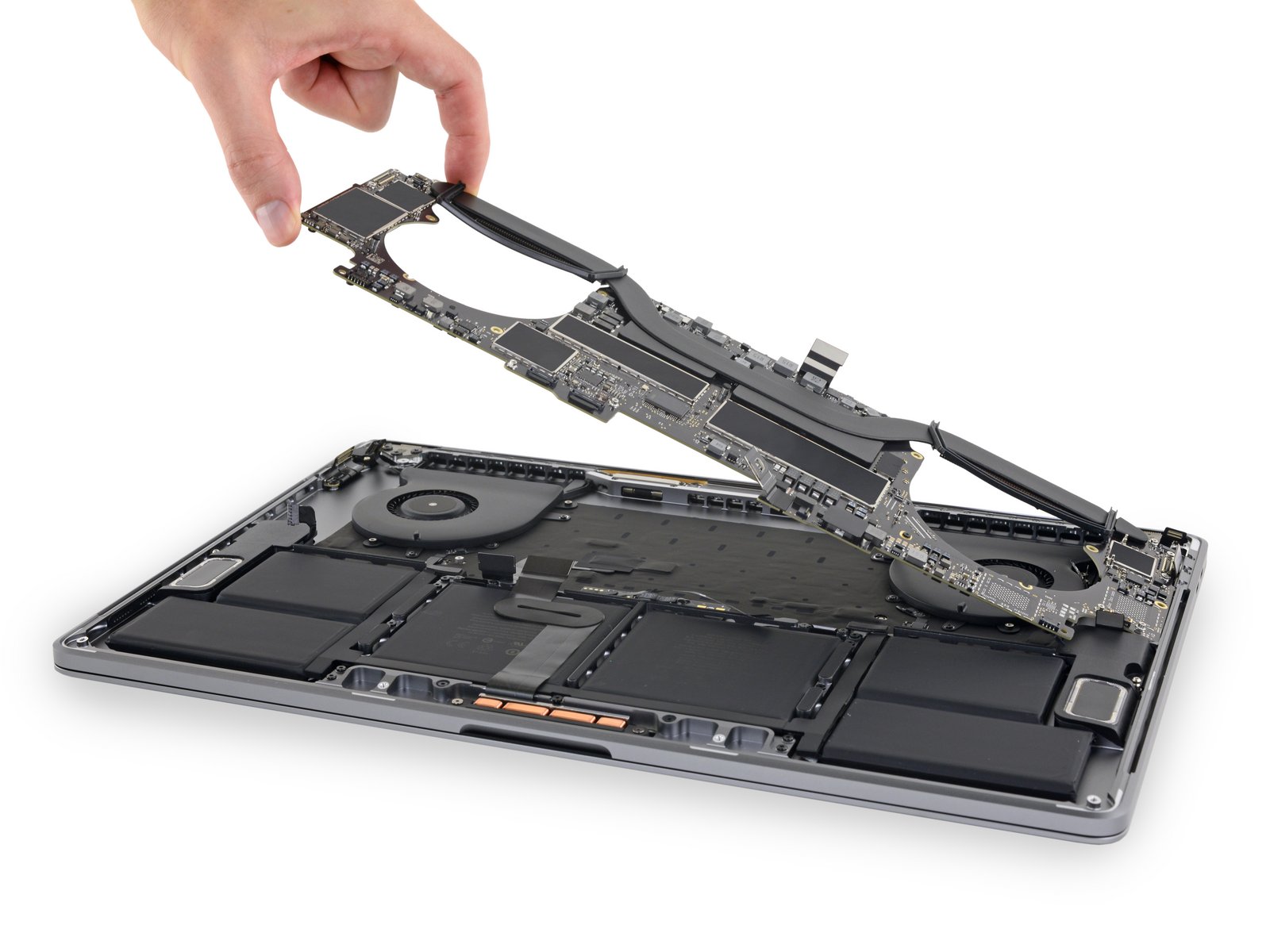

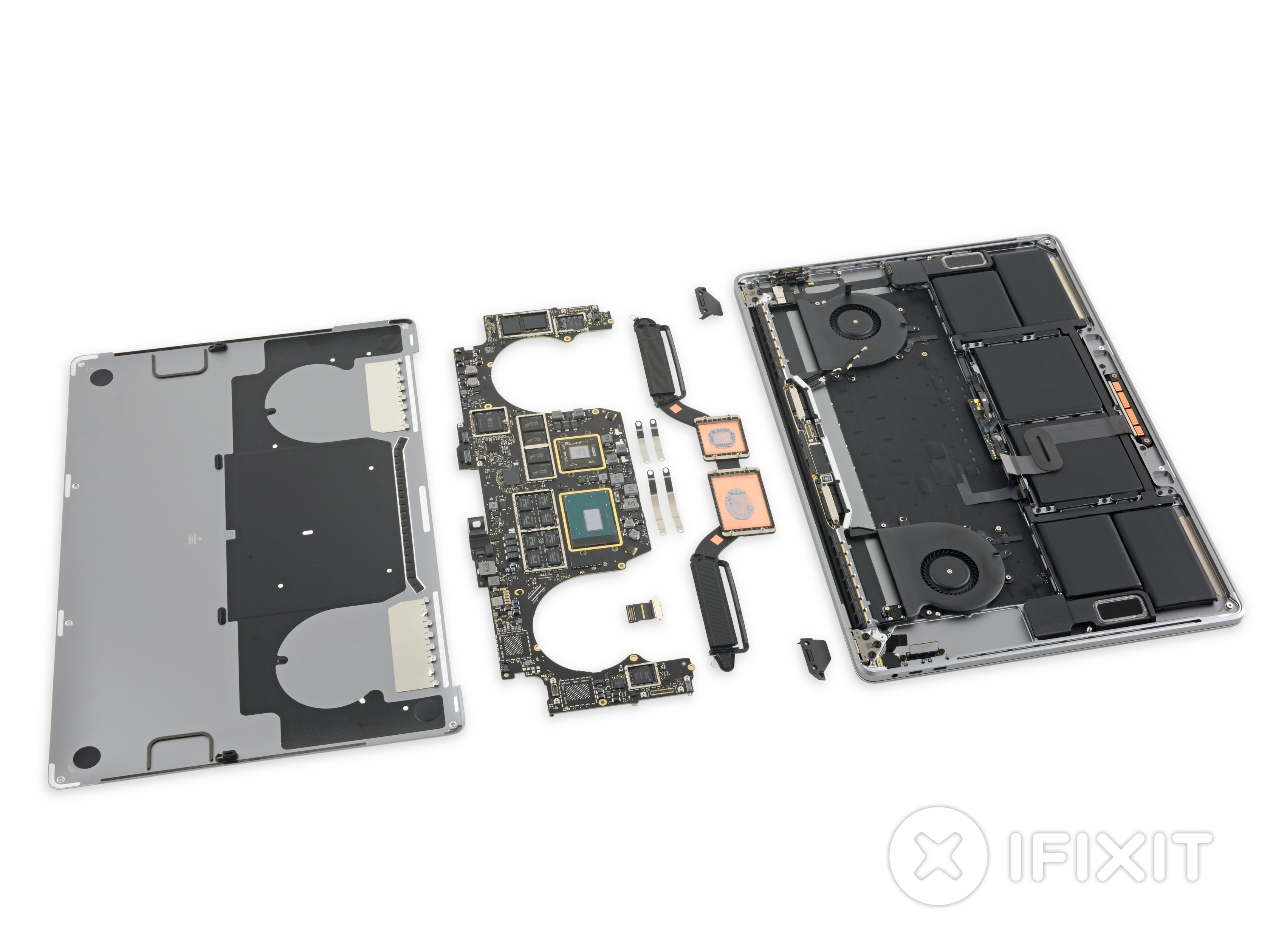

Here's a teardown of the 2018 15" Pro: https://www.ifixit.com/Teardown/MacBook+Pro+15-Inch+Touch+Bar+2019+Teardown/123653
I don't see separate I/O boards.
The I/O boards are still attached to the case in this photo.
Look at the logic board. Where's the Thunderbolt ports?
Reactions: Audit13

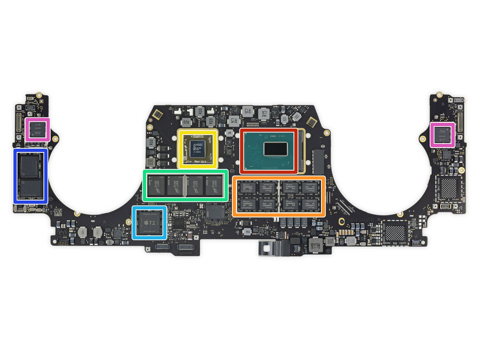

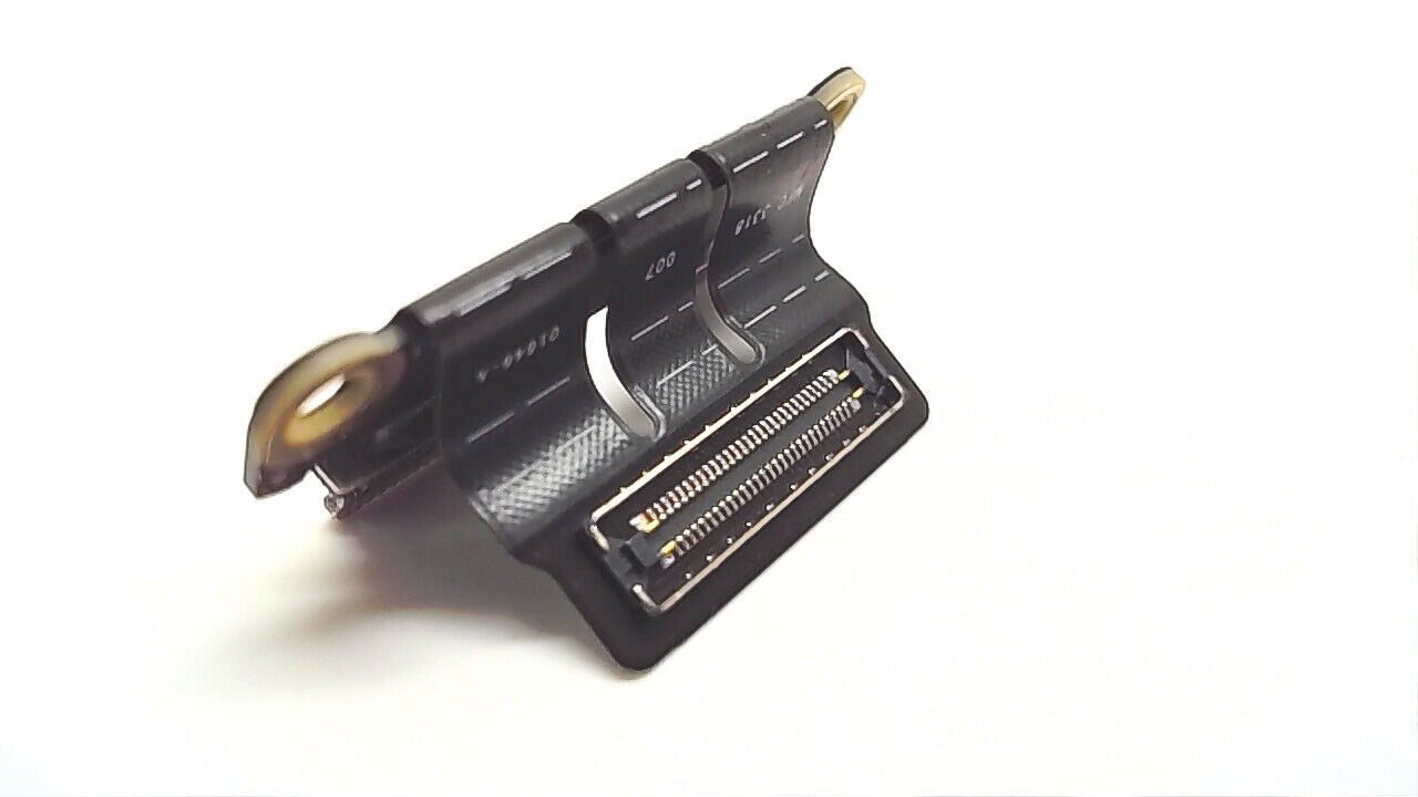

I see what you are saying. They probably do not want to perform a repair that will not result in a fix of the problem. Otherwise, it could be a policy thing set be Apple -- like replacing a one key on a keyboard necessitiates a topcase replacement, etc. Who knows. It does seem ridiculous. I agree that the whole Apple repair process is somewhat broken generally. It is kind of what you sign up for when purchasing from Apple these days -- very costly and regimented repair options. As you may know, there is a whole "right to repair" movement in the United States that is pushing back on these policies.
See those long connectors right next to the purple squares? Those are for the connections from the I/O boards (where the USB-C/Thunderbolt ports are) to the logic board.
Looks to me like the connectors are soldered to the main logic board rather than being on a separate daughter card and the connectors are attached to the external ports using a passive cable.
Please let me know if my thinking is not correct.
Looks like connectors are soldered to the main logic board rather than being on a separate daughter card.
Well, yeah, the logic board side of those connectors IS. But that's just a plug that the cable from the I/O board plugs into and is secured using a metal strap and 2 screws (see the screw holes on either end?). The OP wants the Thunderbolt ports replaced, the parts that are screwed into the case and attached to the logic board through the cables that plug into those connectors.
Reactions: Audit13
I understand what you are saying. I wonder if the I/O boards are passive.
