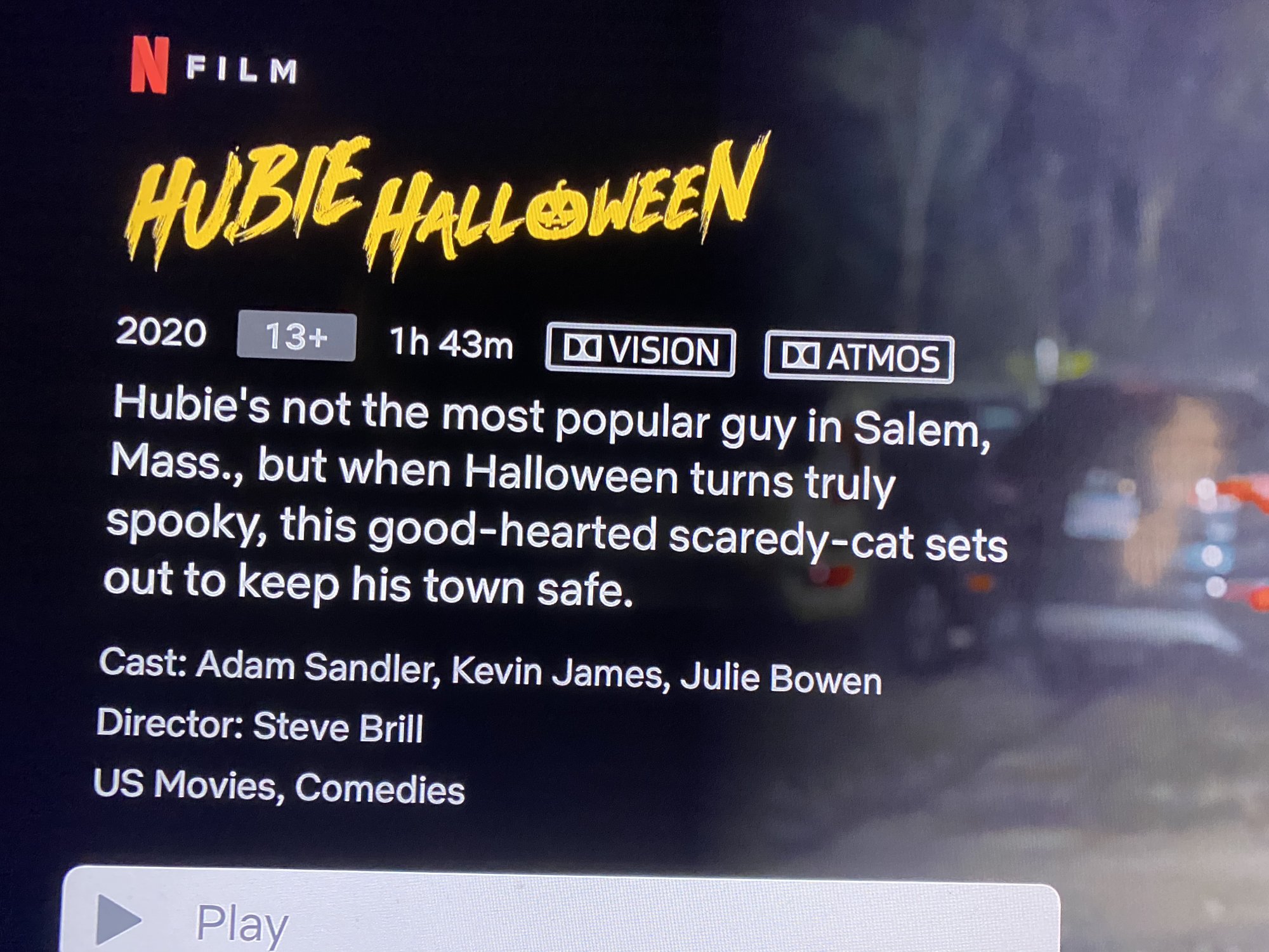

D). Select the Homepods from the control center of the Apple TV. Then go, for example, to Netflix, and start playing Hubbie Halloween or the Irishman (again, for example). While playing, swap down on the Siri remote to bring up the audio and subtitles menu . You should see the Dolby Atmos logo there (in the info tab), which indicates that your are indeed playing a dolby atmos track.

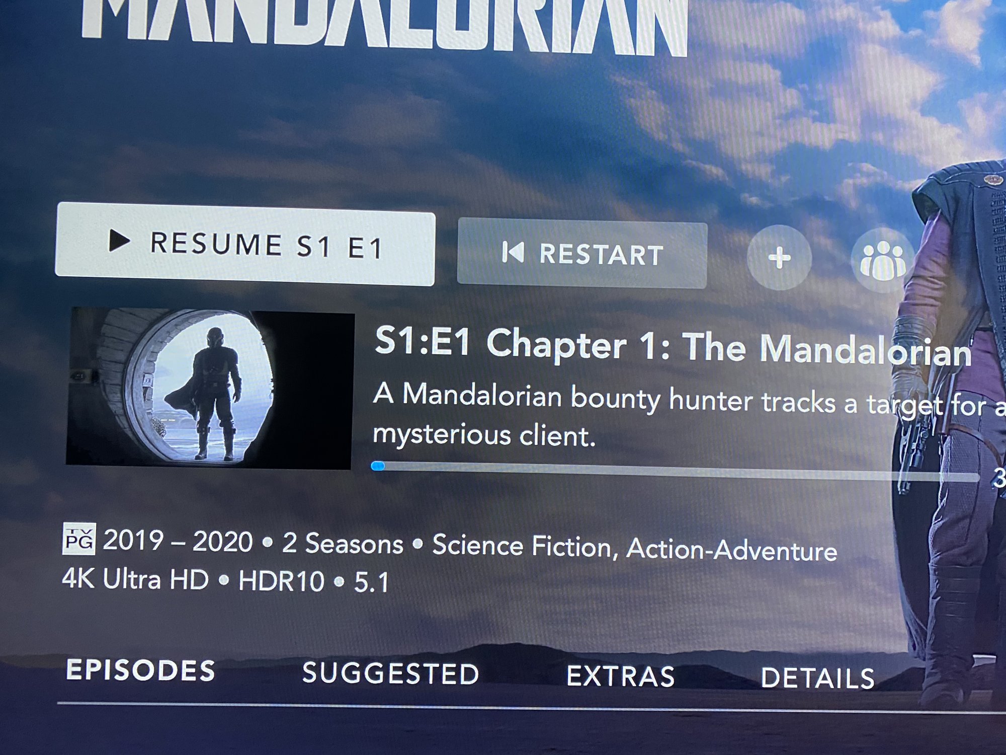

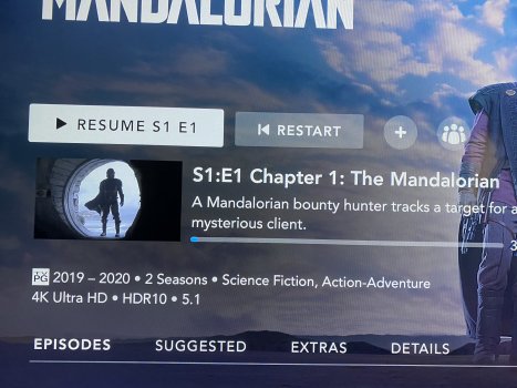

Unfortunately, the Atmos logo doesn´t appear on Disney+ streams, only a 5.1 badge, which tells me that the app need to be updated to work with the Homepods . However, the Home Theatre processing of plain old 5.1 tracks by the Homepod is also very impressive.

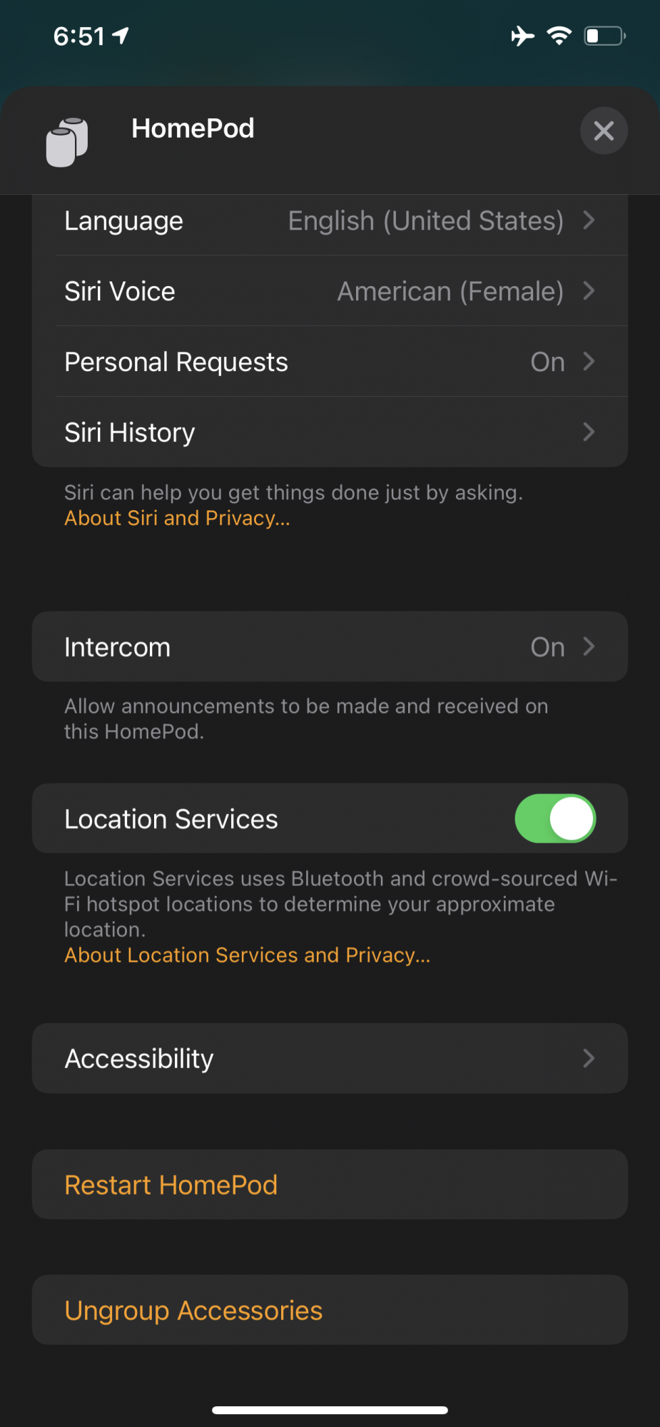

However I couldn’t find where to remove the beta profile of my HomePod

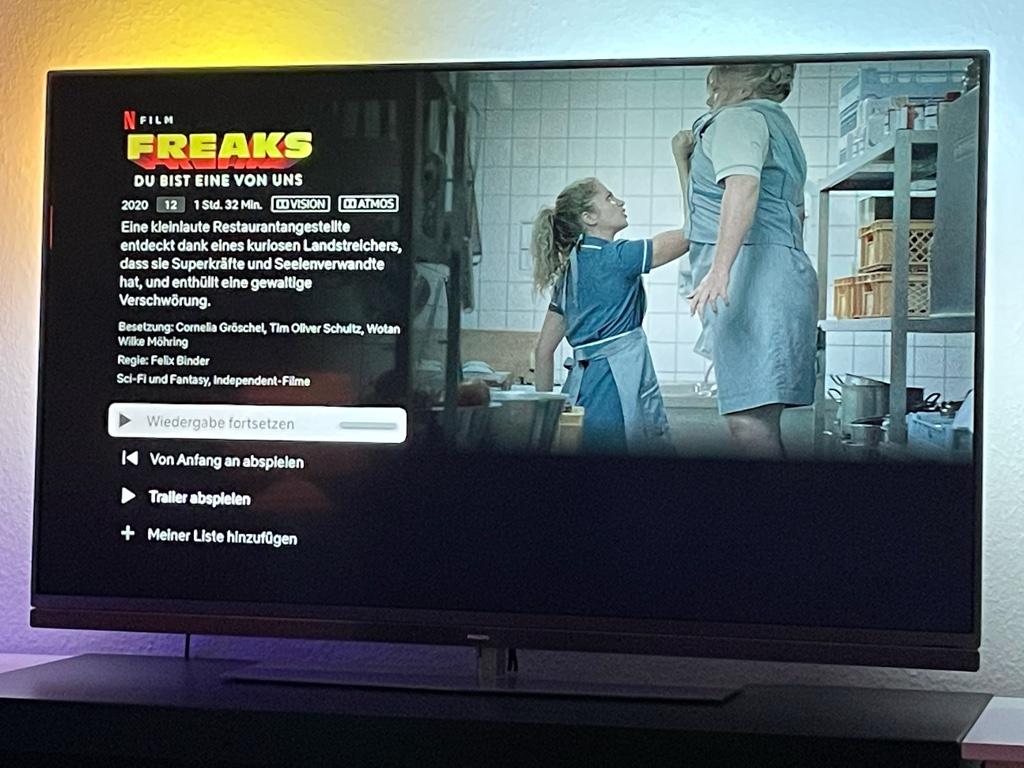

so does this mean I have Dolby atmos activated ??
"Just open the home app, long press on the HomePod and slide up to get to the Settings. Then scroll down to Profiles and Device Management. Tap on the beta profile and then tap remove profile. Done."
Yes! How does it sound?. Do you notice a clear difference from before 14.2 firmware?. If you do, is working.
I tried to un group them and restart them and just don’t see that profile and device management tab anymore ( is it possible that it auto installed the Public 14.2 to replace it like the iOS did ?
There is a noticeable difference but I don’t see anything from Netflix and Disney + which make me doubt it’s placid effect on me lololol
again , plz confirm with me ....

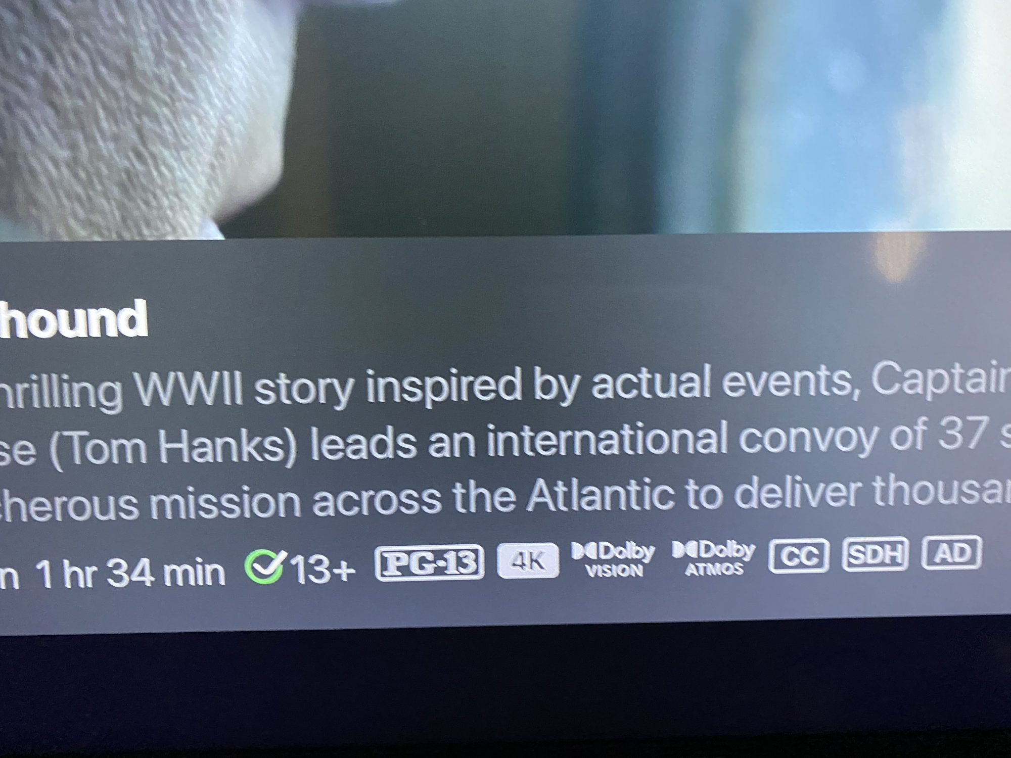

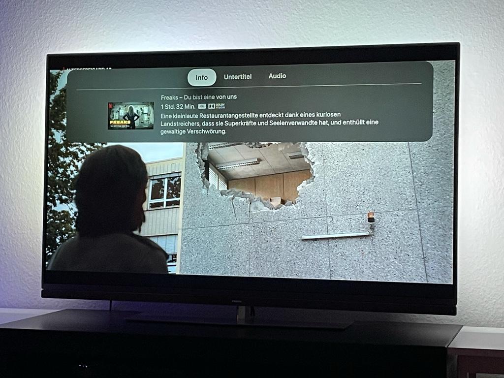

Not sure if it helps anyone updated the HomePod and put Greyhound on Atmos did not show up on the info.
Thought my Apple 4K tv was up to date but wasn’t so updated that and the Atmos is now showing on the info of Greyhound, only listened to it for a short while but it sounded pretty good.
You are positively sure that this icon showing up on the info means it’s being activated?
Reactions: B/D

Is not placebo. Everything is fine. The Atmos logo appears in Netflix and Apple TV/Itunes but not in Disney, which only shows a 5.1 badge. Perhaps the app need to be updated.
As posivitely sure as I can be, given what apple told me. But again, the difference in sound is huge when compared to pre 14.2 update. The difference is very noticeable.

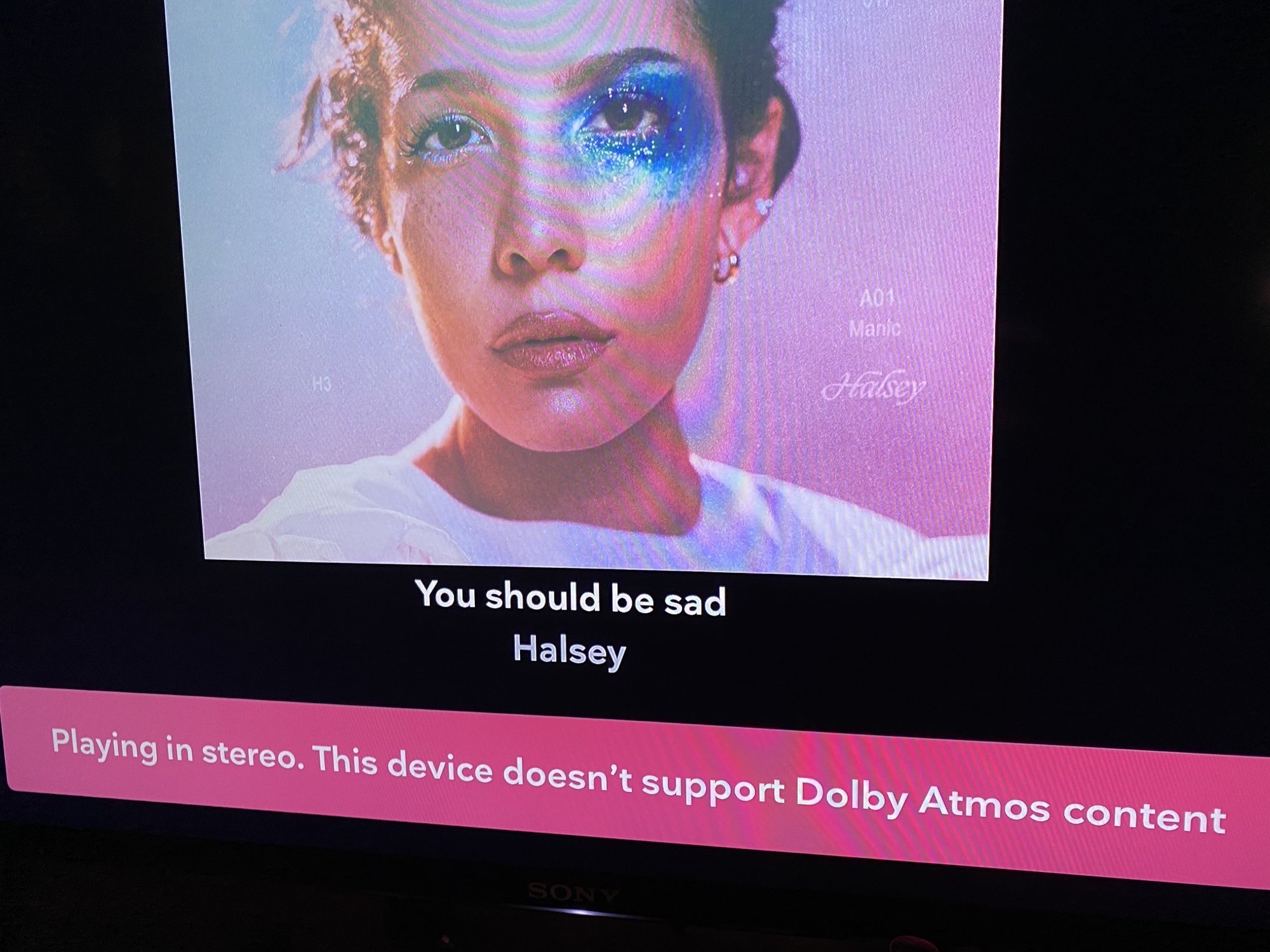

lol wtf ....it said it’s in stereo mode
Wasted my money on reactivating tidal just wanted to try it out
Strange. Perhaps the Tidal app, like Disney, needs to be updated to support Atmos through the Homepods.
Ok as long as you are 1000% sure that icon on that lame info on Apple TV shows means it’s activated,
Thanks for your help!
Again, 100% sure is impossible. Only know what Apple support told me, and that could be incorrect or a half truth.

I am absolutely not sure. I changed the audio format in the settings app to stereo. And the Dolby Atmos logo was still there.
I’m gonna be a naysayer. I think the symbol doesn’t mean that you now have Atmos. I think those symbols tell you that those things are available. And they show up if you have any equipment that can play them. So I’ve always had Atmos there because my TV, by itself, is capable of it. It even stayed after I turned the internal speakers off on my TV in settings. I’ve only ever used my HomePods for speakers with this TV.
My Mom’s TV isn’t capable of Atmos so the symbol isn’t there for her. I’ve hooked my tv to her TV and there was no Atmos symbol. I brought out my HomePods and connected them and the Atmos symbol came back. I have no pics of this because I did this days ago before I knew people were confused about the symbols. I was having issues with WiFi and my Mom’s tv is hardwired. I wanted to see if Ethernet would fix it.
Reactions: B/D

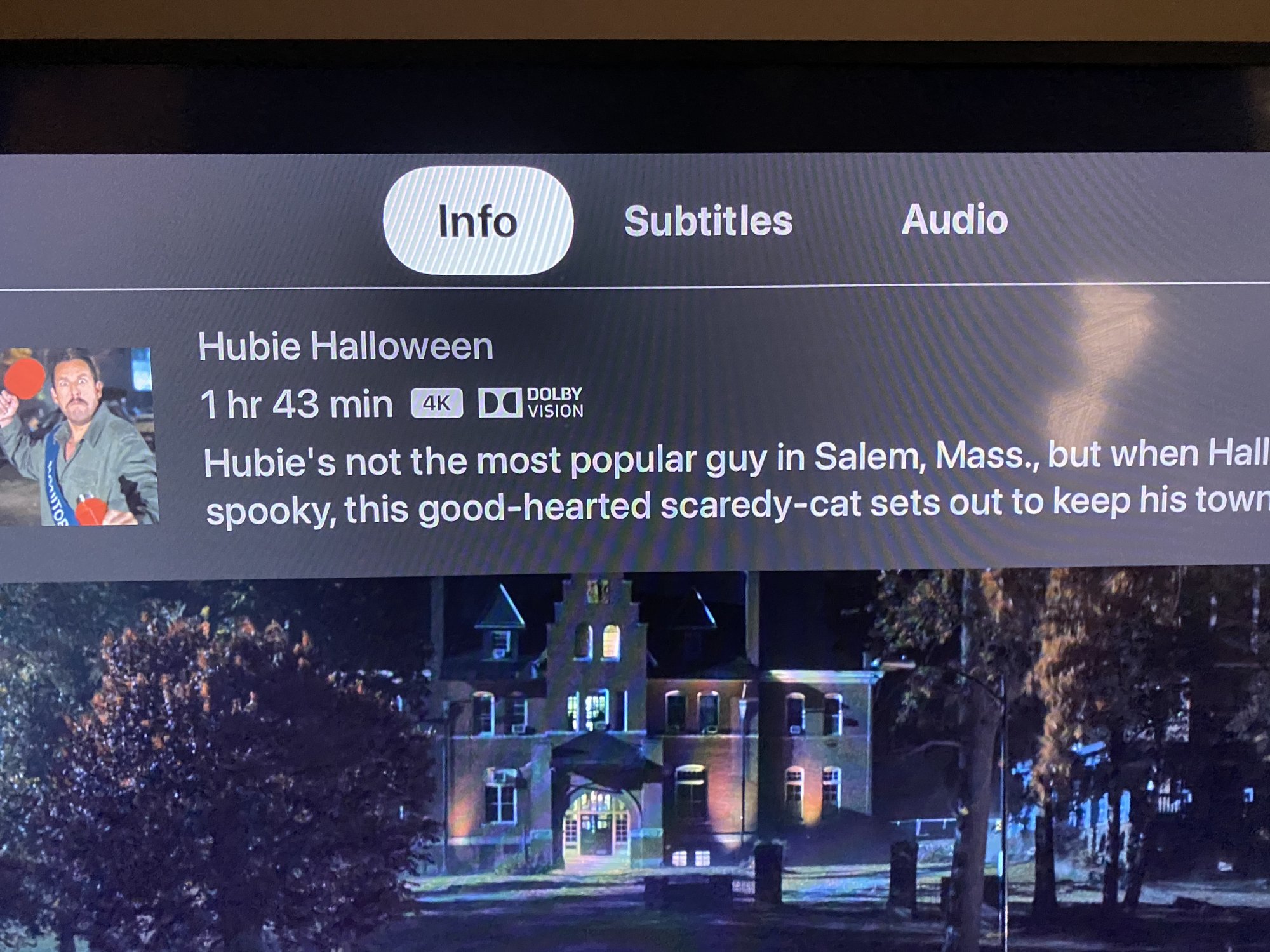

Still not sure, if I really get Dolby Atmos. It’s displayed first, but not when the video is running.
So I´ve been back and forth with Apple on this all week and this is the correct behavior, apparently. If you select the Homepods as the audio output of the Apple TV (either as the default one or through the ATV control center) you should see the Atmos badge in the movie card info of Netflix, Apple TV+, and Itunes Movies apps, but not while playing the video. This is correct.
Before the 14.2 update, you didn´t see the Atmos badge in the movie info card of Netflix when the Homepods where selected as the audio output of the Apple TV , but now you do, because Netflix recognize the Homepods as an Atmos compatible audio output. That wasnt the case before.
However, not all apps support Atmos to the Homepods at the moment. For example, I only see a 5.1 badge on Disney+ info card with the Homepods select as the audio output, whereas if I select my TV speakers as audio output of the ATV (my TV set support Atmos), the Atmos logo reappears. This means that the app needs to be updated to support sending Atmos audio to the Homepods.
That makes sense?. Im from Spain and my English is... not so great anymore.
Reactions: jbro1999

So yesterday’s update didn’t fix D+?
