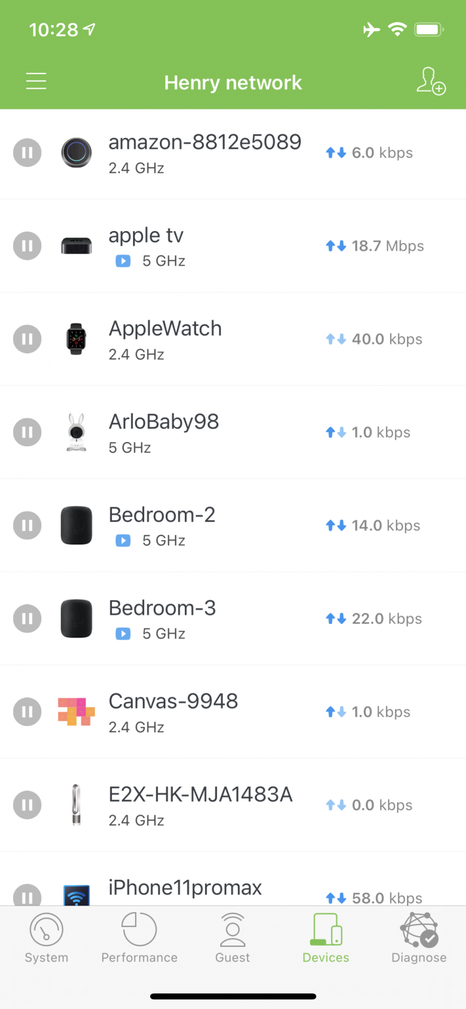

Actually the internet bandwidth isn’t as serious like you said ... mostly just 10-40 KB for the HomePod
as you can see they consumes even less than my Apple Watch
anyone with a normal WiFi router like AmpliFi alien WiFi 6 could easily handle these
I can’t wait for the next Apple TV with WiFi 6 tho
