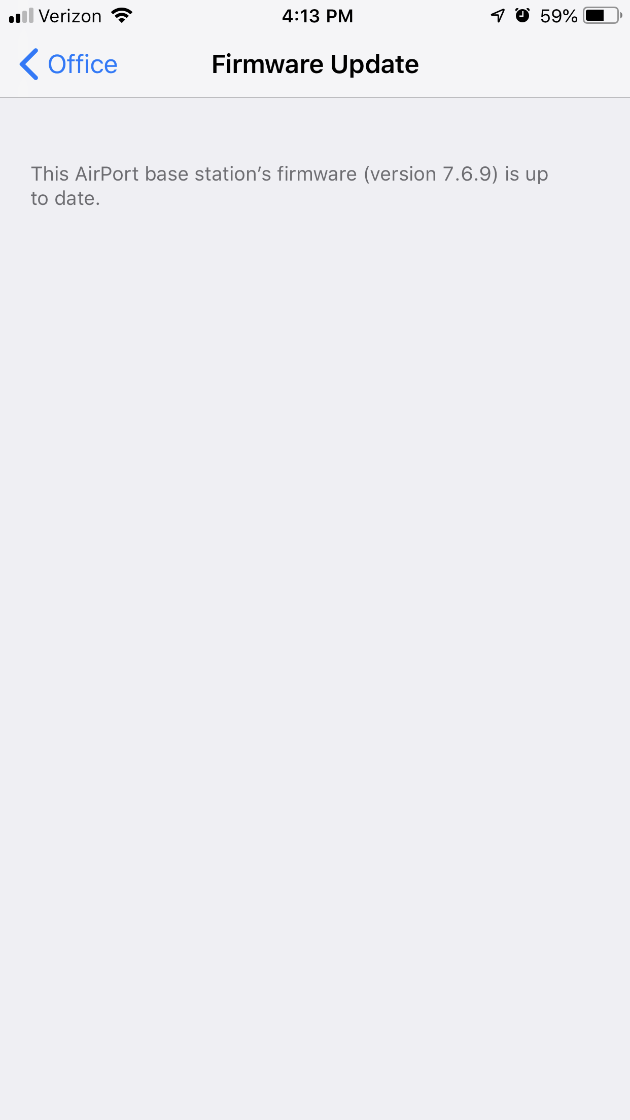

My issue:
None of my devices show that a firmware update is available.
Even my A1392 models say they are running the latest but are only on 7.6.9.
I have checked in both the iOS and OSX Airport utility with the same result.
Has anyone else run into this?

My issue:

Try rebooting the airport express and see if the update becomes available.
Same thing after multiple reboots.
I will reset it tonight and try again.

No luck after the resetting all settings on the base stations either.
I can’t be the only one having this issue...

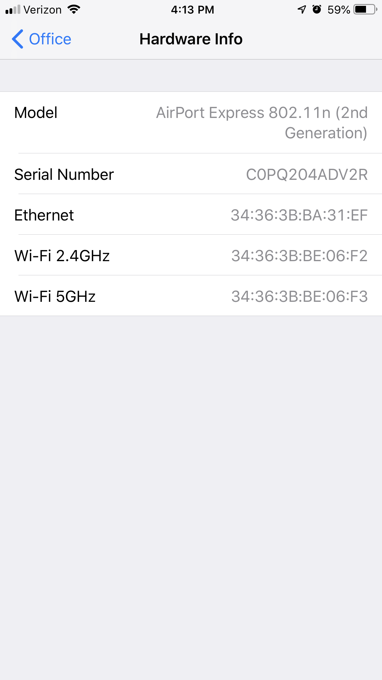

I'm having the same issue. My device is "AirPort Express 802.11n (2nd Generation)" so I think it should be eligible? I have rebooted it, power cycled it, and reset it to factory settings, but neither the MacOS or iOS versions of AirPort Utility show an update available.

That is correct, only the 2012 models (A1392) receive the update.
I sure wish they would include specific model numbers in the release notes.
