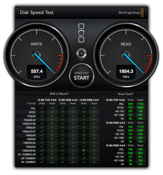

Installed, no problems. I ran black magic speediest this morning and am seeing no performance degradation that I'm aware of. (screenshot link)

I'm getting similar read speeds, but my write speed is less than half of yours (image attached).. I wonder why. I do have FileVault 2 enabled, you think that's having an impact? If so, that's a significant performance hit.

He might have a larger SSD than you, the larger the size the better the write speed.
I have FileVault 2 enabled, too, so I am unsure why your write speed is slow. Try in Safe Mode?

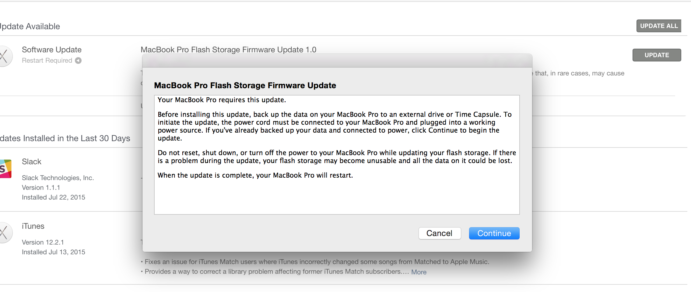

I have a 15" MacBook Pro 15" which I purchased the 1st day it was available in the Apple store (around may 20ish 2015). I didn't find the update in the app store so I went to the direct link and downloaded it. I tried to install it but it says my Macbook doesn't need this update. Anyone know what's going on?
When I try to run the update it tells me that my rMBP mid 2015 doesn't need it.
Should I worry?
Yes. You'll have to extract the files from the installer and install them manually. Obviously Apple goofed and left you out. < trolling, sorry...
