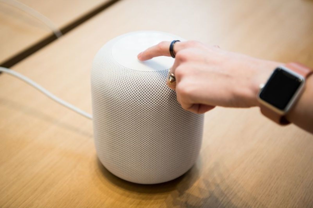

When it comes to account issues, remove the device from accounts (home, iCloud, etc) first before resetting it. Using the software reset retains account settings / affiliations.
You are my hero, that actually worked and now my homepod stereo pair is working just fine again 🙂
1. I’ve removed them from iCloud
2. Then removed them from home app
3. Disconnected the power cord
4. Plugged back in and after ten secs put my finger on the HomePods
3. Waited till the lights turned red and then set up as new
Thanks!!!
