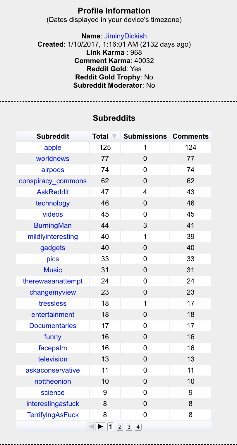

Yes. An off-used tactic in internet "arguing". Don't discredit the post, discredit the poster combined with the McNamara fallacy leads to interesting posts.
What side are you on?
Disprove it.
and what does it have to do with quantitative theory?
But, but, @doublemycoresplz mentioned they have empirical evidence?
