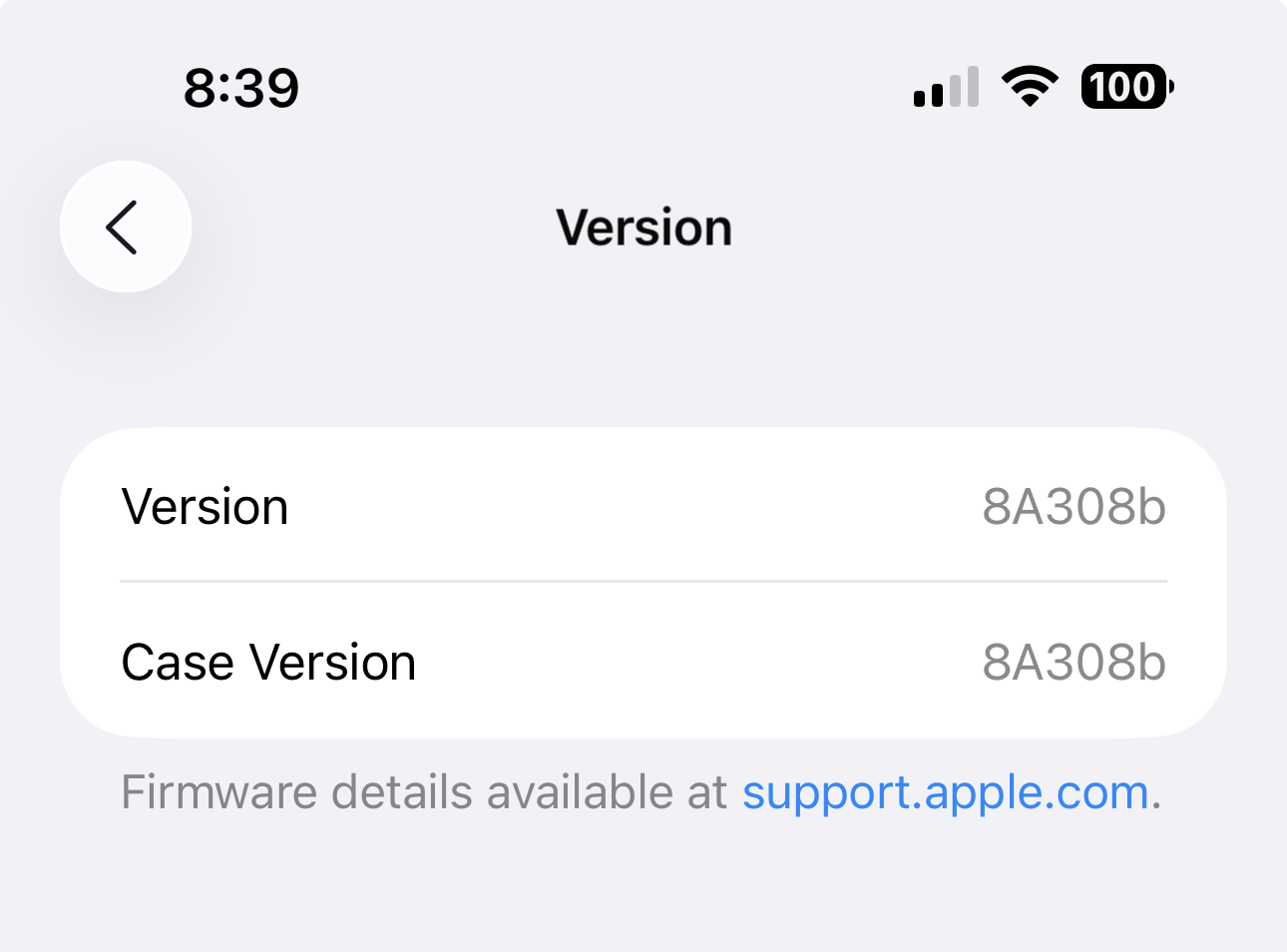

Interesting. I have 8A308b for the Case Version, but I still have 8A293c for the Airpods version, which it's been on for some time.
Same here. I've tried everything over the last day or so, played the AirPods for several minutes, plugged them and the iPhone into USB-C and put them next to each other overnight, nada, nothing. The case version is the only one that is updated.

I still have 8A308b for the Case Version and 8A293c for the Airpods version. Has anyone figured out how to fix this? I was on developer beta 1-3, but when developer beta 4 came out I waited and updated to public beta 1. I suspect that has something to do with it. I tried to switch back to developer beta, but they are the same build, so it doesn't do anything. Is there a way to force this update?

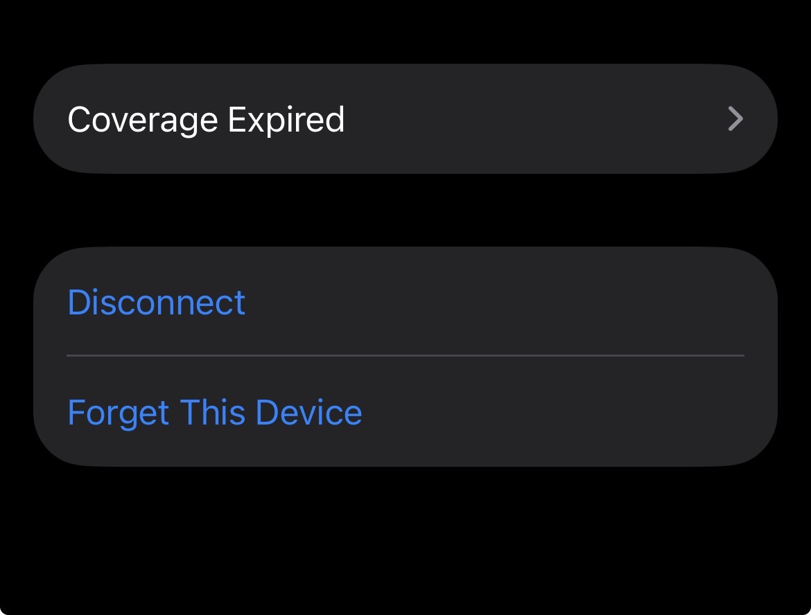

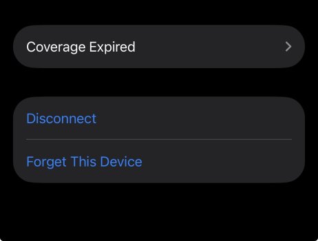

To clarify the issue I’m having, the “AirPods Beta Updates” option isn’t even showing up in my AirPods Pro 2 settings. Not sure if I’m missing any specific step to get that option to show up.
