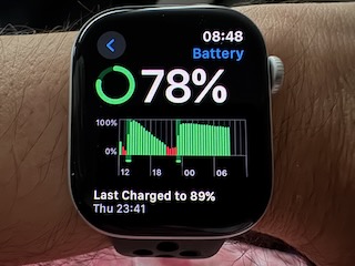

The battery drain in 11.0 is caused by the live activities. It made my Ultra 1 hit 0% in less than 12 hours. After disabling the live activities in the smart stack, it's back to normal. Not sure if 11.0.1 fixes this.

Mine is turned on and tells me to make sure my watch is charged more than 30% before bed to track my sleep, but it stopped telling me when it was charged to 100%, so I look at the battery percentage on my lock screen for the percentage.
