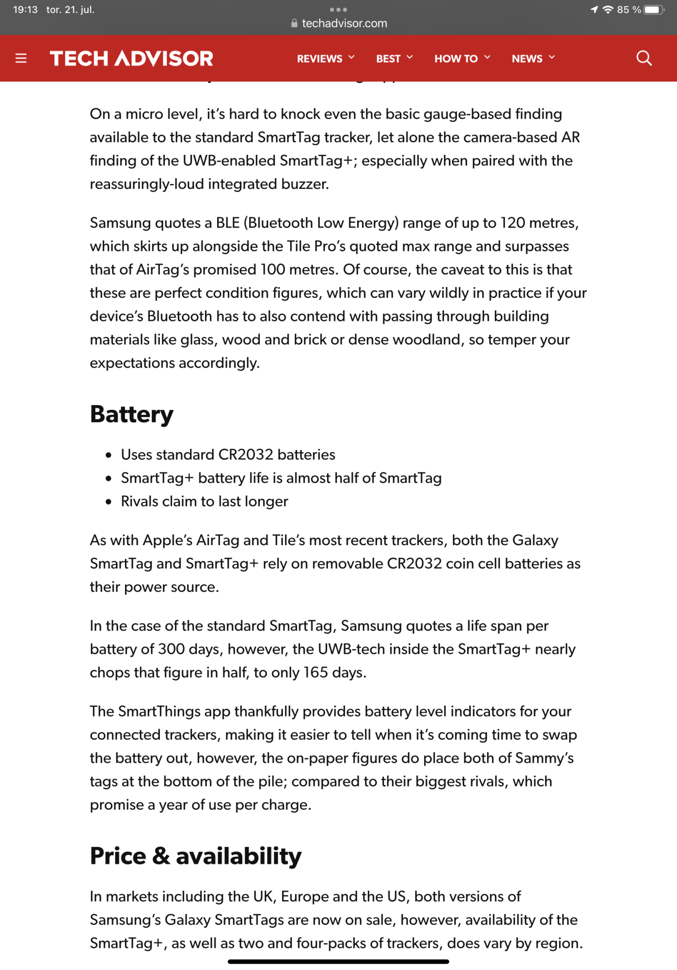

Samsung still obviously relies on SmarTag's battery level indicator.
