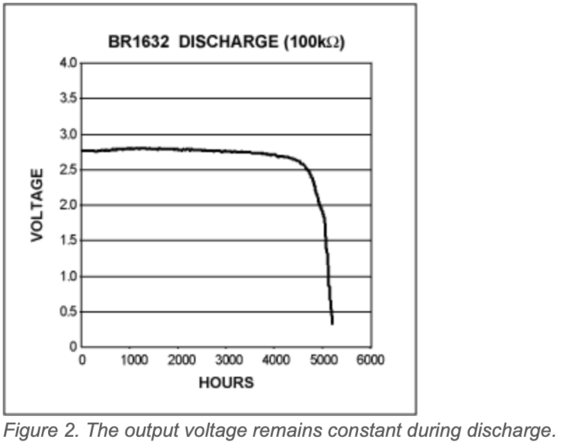

I will share this plot again because people don't seem to be getting it:
The AirTag batteries are not lithium ion cells, they are lithium primaries and aren't charged through a coulomb counter. That chemistry does not change voltage for most of its useful life. There is no way to tell the remaining capacity by looking at the voltage, especially if you don't control the battery supplier. These batteries can't measure the capacity by counting electrons pushed into the cell. These batteries do not have internal fuel gauges, so you can't query the battery for its internal status.
The only way to know the battery is nearing its end of life is when it crosses the knee and the voltage begins to drop. At this point you have a little bit of capacity remaining to report the end of life status.
The existing battery level was probably Apple's best effort to make an educated guess about the remaining capacity. I'm guessing they tested hundreds or thousands of batteries and established some kludgy heuristic that they had enough confidence in to work and enough faith in humanity to think they'd be willing to accept imperfect results. Then they shipped millions of AirTags to jokers like us and we started digging old coin cells out of drawer bottoms and under car seats and pulling them out of one thing to put them in another or buying them from the gas stations in whatever countries we all happen to live in and some of us were getting wildly inaccurate readings. Inaccurate to the point that we though there was plenty of remaining life until suddenly there was none. Apple decided that was unacceptable and the only way to avoid misleading the user was to remove the indicator.

The AirTags are using standard cell batteries instead of sealed proprietary batteries. Most people think that is a good thing but the downside is that those battteries don’t have charge management circuitry in them. That makes it hard to get an accurate read on their charge levels. Any reading is an approximation. Until the voltage starts to drop and then they give a low battery notice.

It may not reduce the number of false alarms, but it will reduce the number of times you look at the battery level and think "it's still half full" only to have it go flat tomorrow. The discharge curve is flat until end of life. There is no way to tell the difference between full, half empty and three quarters empty-- which means you can put a 3/4 empty battery into the tag and Apple may very likely call it full because they assume you installed a fresh battery.
