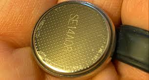

image from google, Mine are the same coating around the edge
Replaced my AirTag battery today and it didn’t work. Googled why (actually DDG’d) and remembered reading about the coating. Lighter fluid took it off easily.

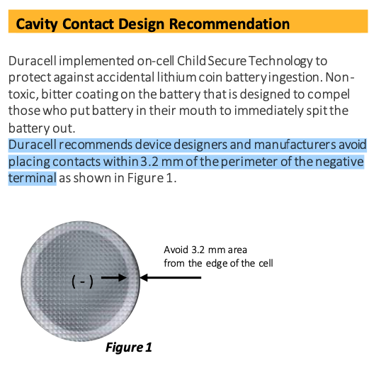

Duracell recommends to manufacturers to put the negative contact further 3.2mm from the edge of the battery (odd wording because they SAY perimeter of the negative terminal but illustrate 3.2mm from the edge of the cell which is the positive terminal).

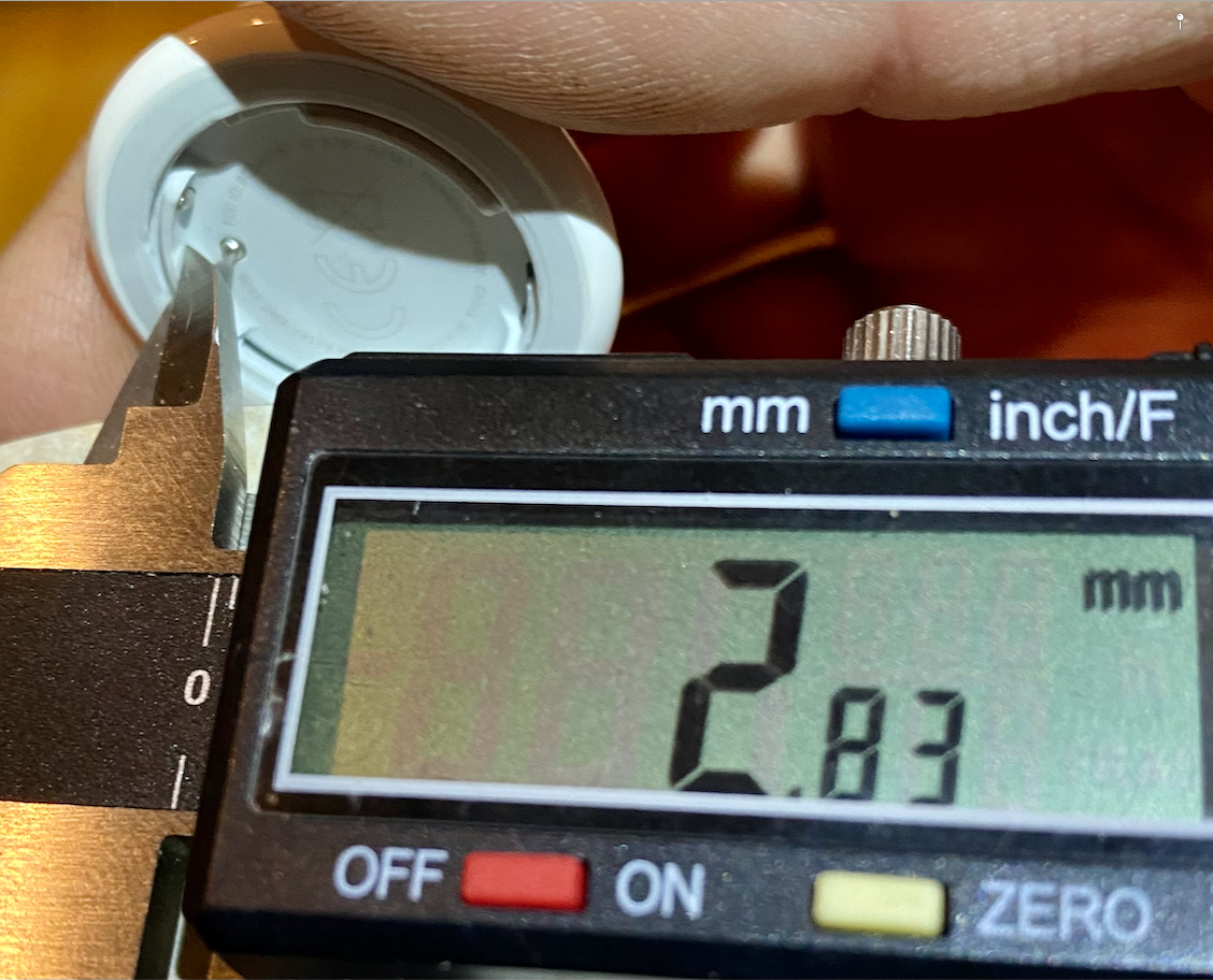

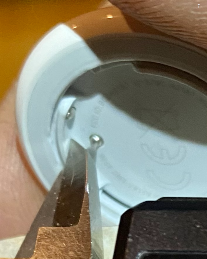

Apple puts their negative terminal less than that.
Screen Shot 2023-04-22 at 9.55.33 AM.pngScreen Shot 2023-04-22 at 9.55.46 AM.png

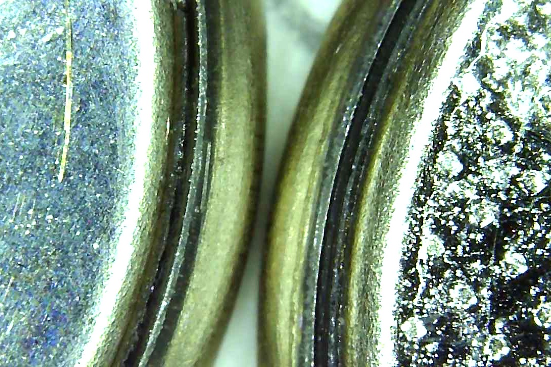

Also the negative terminal on a Duracell battery starts about .77mm from the cells edge. Whereas competitor batteries start around .5mm (duracell uses a gasket, panasonic and engerizer use a folded edge) and that gasket takes up a little more room. Very minor difference but it exist. (Duracell on the right).
View attachment 2192031View attachment 2192030

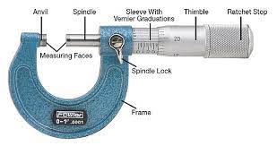

I have the same micrometer.
I think that's a Vernier Calliper. Micrometer looks totally different and looks like a C-Clamp with a rotating vernier on its handle. 😁
