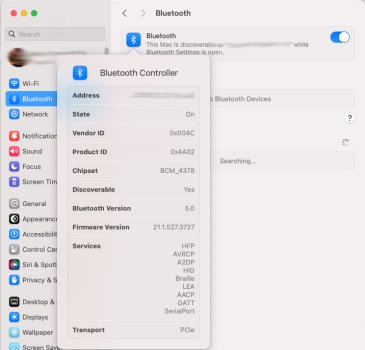

Registered on the forum just for this as I can't find info on this topic anywhere else on the internets.
