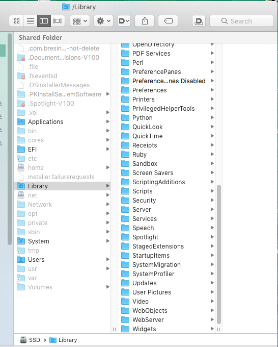

There is no folder "updates" in the library folder. Could it be hidden?

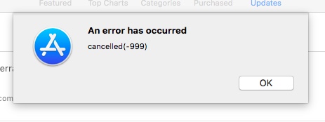

I'm trying to install the beta but Software Update keeps coming up with an error when it downloads - is this happening to others too?
