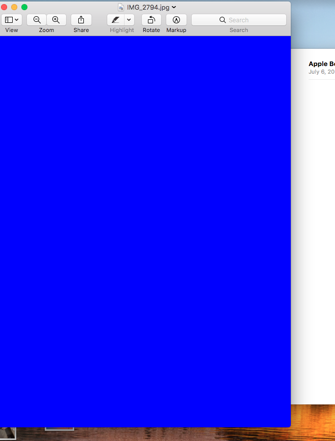

Same issue although I'm just getting a blue box when using preview. Has no one else noticed this?
Yes, it seems as all apps using quartz are effected? I can open Pixelmator for example, open a thumbnail and see the picture for a split second before the whole image turns to a solid colour. Preview the same as it Photos and iPhoto.

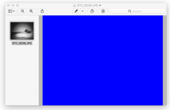

Example attached, preview thumbnail OK but main screen blue.
I am getting the exact same issue. Preview and Photos are both displaying as a solid colour, Photos is also no longer playing videos.
Does anyone have any ideas, this is making my work with my photos and drawings very difficult.
Peculiar. Works fine on my 2014 MBP as well as my iMac. What systems are you two on? Let's see if there are any shared factors.
When displaying a screenshot in Preview, this is what I get.
Using Shift-Command-4 to make a screen snapshot in 10.13.4 beta 1 the result is a garbled png file.
To render correctly in preview change the screen snapshot filetype in terminal like this:
defaults write com.apple.screencapture type PDF;killall SystemUIServer
Now Shift-Command-4 will make a pdf screen snapshot instead and this time will render correctly in preview.

I now have 10.13.4 Beta (17E150g) and problem with Preview, RAW and Photos is fixed.
[doublepost=1518207213][/doublepost]
I now have 10.13.4 Beta (17E150g) and problem with Preview, RAW in finder and Photos is fixed. Videos also play OK in preview too. I had a personal message from Apple via Feedback Assistant.
[doublepost=1518207262][/doublepost]

Just a quick update on my issues with Preview not displaying correctly. I pulled out of the Beta program and dropped back to the official release version of High Sierra and the problems went away so it was obviously something in the Beta that caused the issue.
Now running 10.13.3 final release and things are still ok, at least as far as Preview is concerned. I have though noticed my fan is now running almost all the time where it wasn't before :(
